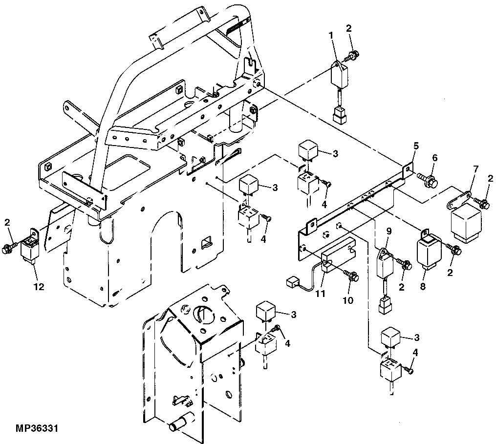

So...It looks like I need a new battery BUT...our suspicion is that the alternator and/or voltage regulator are pooched. Does this have a volt.reg. built into the alternator or is it external. If external, does anyone know of the location of the voltage regulator? Behind Dash?
Not sure what to do next. Please advise if you have experience with this problem. ***Have read elsewhere that there is a Safety relay near the voltage regulator that could be the issue. Elsewhere, some people have just recommended getting a new battery. Don't want to start pulling it all apart until I get a little advice. Thanks for any advice you might be able to give. -Kirk (Ecoskidder) PS: If there are any step by step diagnostic directions that you might have and/or pictures and diagrams for replacing the Voltage Regulator, that would be great.
   / John Deere 2320 Electrical/starting problem #2
The regulator is separate. Key #11, beside it is the starter relay key #12 there are also timers for the fuel shutoff key #1, the glow plugs key #7, relay for the glow plugs key #9.
Use your meter on ohms and check both battery cables. You may have a bad cable connector or bad ground.

Sometimes life gets busy and you don't get back to the people that helped you soon enough. A belated but sincere word of thanks to all of those who helped in problems solving. To update: when I had the alternator, voltage regulator tested, the alt and vreg tested out to be fine. With the battery, while the specific gravity checked out ok, it went right down to 0 volts when subjected to a load. No real surprise. Bought a 450CCA battery and put everything back together and things have been fine ever since. It was very strange that the dead battery caused all of my gremlins but as someone said either in this or another post, a healthy battery really does seem to act as a regulating buffer. At any rate, lots learned from this experience and all of it was good. Thanks to everyone for the help and suggestions you lent. I'll be paying it forward at some point. Best to you all in weathering Sandy if you're in the Northeast. Gratefully, Kirk
