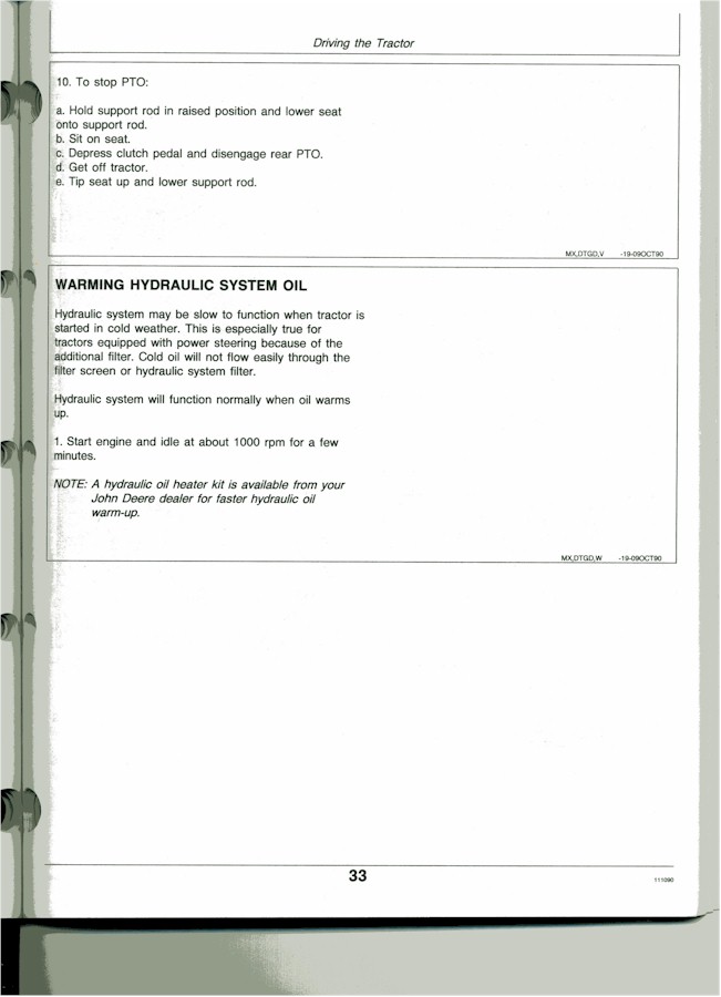

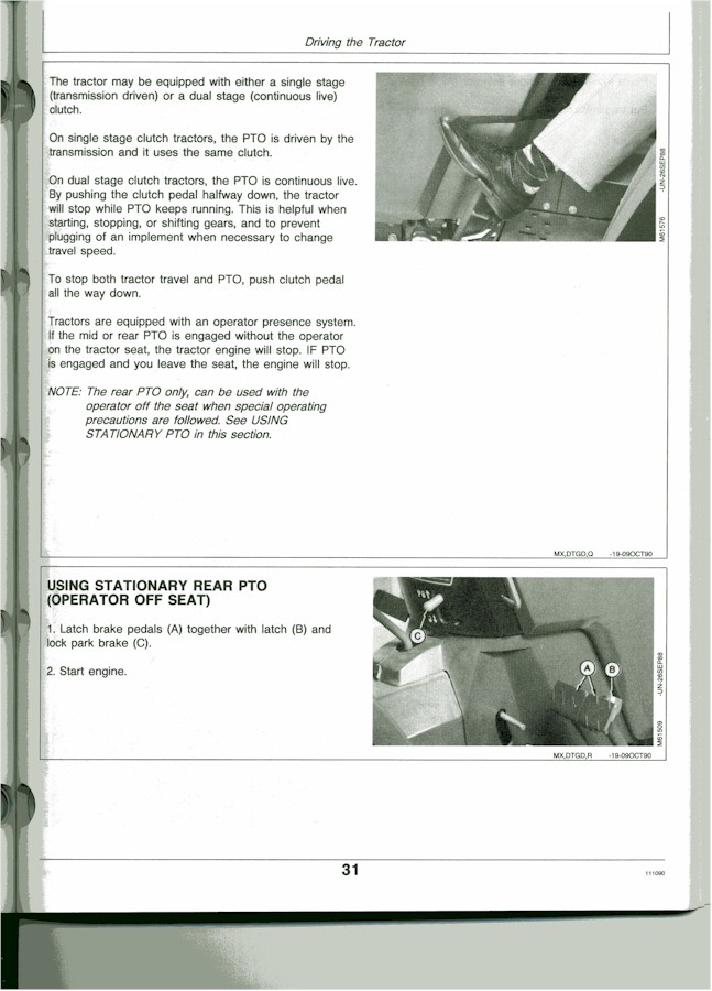

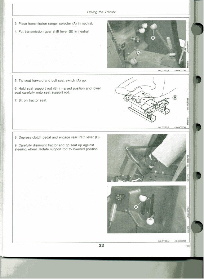

My seat is well broke in. I use a bungee cord to strap the seat down which overrides the safety switch.
Your tractor should have the same three position seat switch as mine. It allows you to pull up on the switch to override it. Yours just has the addition of a support rod so you can engage the clutch. Pages from the 770 manual are attached. Perhaps you know this and you were just saying your switch is broken.
