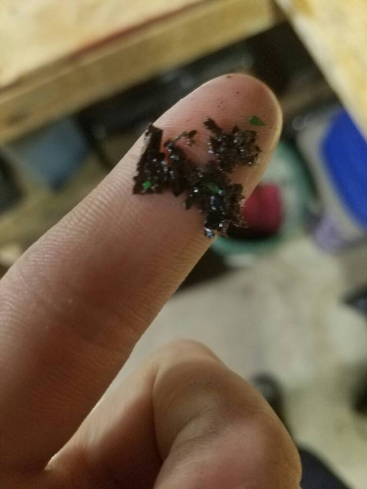

Thistle seed would appear organic .........I hope all the fiber material has not been dissolved away and is not allowing metal to metal contact, particularly on the wheel brakes.
There is "brand x" hydraulic 303 type oil from Bubba's discount store .....Then there is Hy-Gard from the John Deere dealer. I would assume that most others would agree that draining, flushing , gaining and refilling with Hy-Gard could slow down the deterioration of the wet brake and wet clutch material if no metal to metal contact has been made ?
iirc type 303 oil was dropped and the superior spec Hy-Gard was required with the 30 and later series equipment ?

Without major tear down is there any way to check for metal to metal wear?

20170228_182752.jpg here's what was mostly stuck to the screen.
   / John deere 2440 filters and maintenance #44
Resembles rear brake material to me. How much material was on screen? If it was my tractor I'd install a magnet in bottom of trans/diff housing.
#45
It was pretty full. Most of it fell in the bucket when I pulled it out so was unable to see exactly.

Really starting to hope I didn't buy a turd here. :(
   / John deere 2440 filters and maintenance #47
Finding only organic material now without the time and expense of metal to metal contact , is worth going out and having a beer to celibrate your good fortune .
