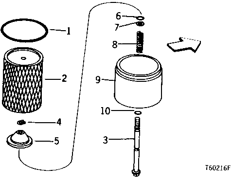

Searching for information for a friend. Looking for a manual for a 300B specifically how to replace the transmission filters. He took them off and doesn't know the order to replace the screws and other parts. If anyone can direct us to a resource it would be greatly appreciated.
/ John Deere 300B #2
Is this what you need?

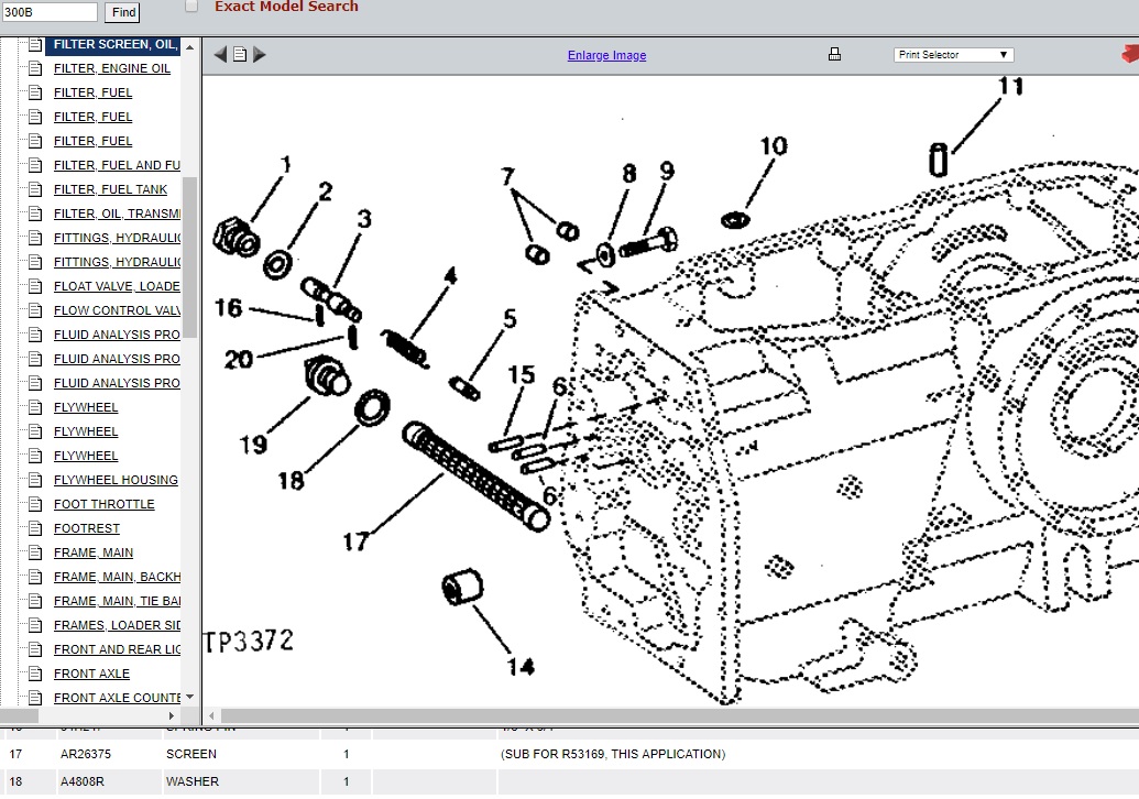

If tranny oil is still drained, then maybe a good time to pull the screen out and see that it is cleaned off, as is shown key 17 in this schematic.
