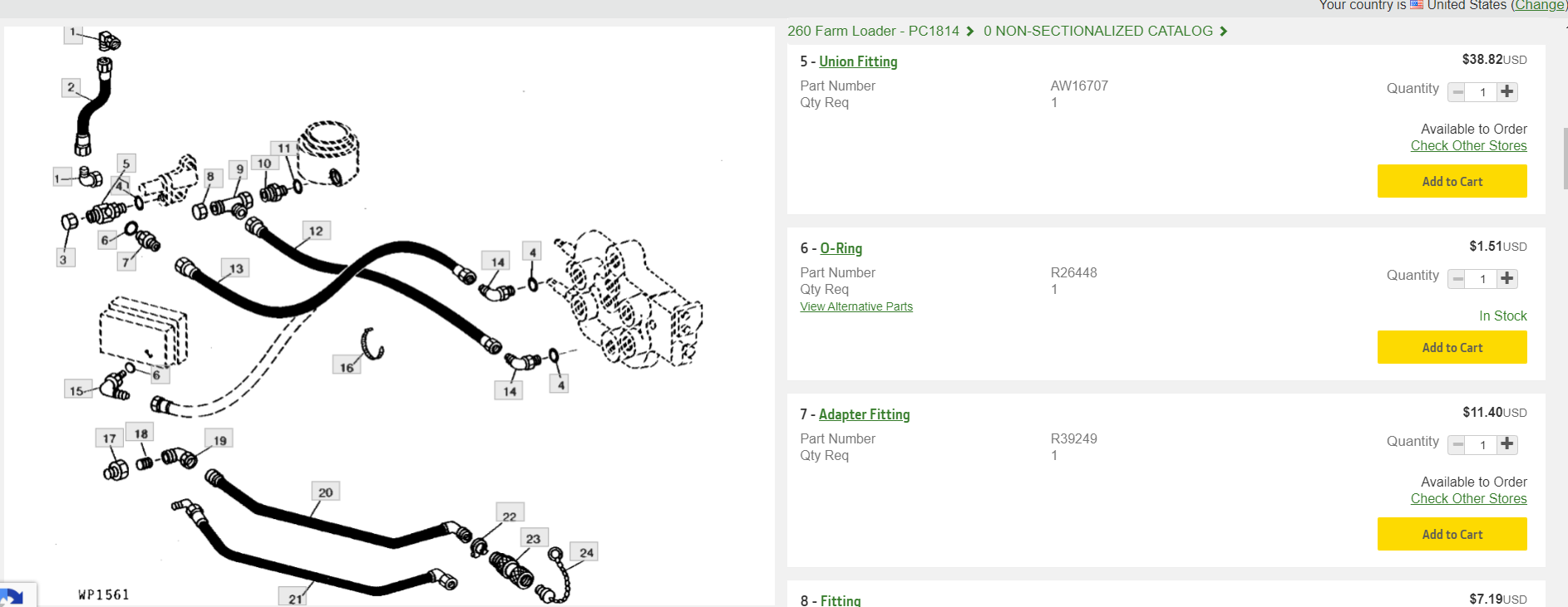

Ditto what beenthere stated about researching parts catalog #1814. IMHO hyd components for 2950 & 3255 should be identical including valve

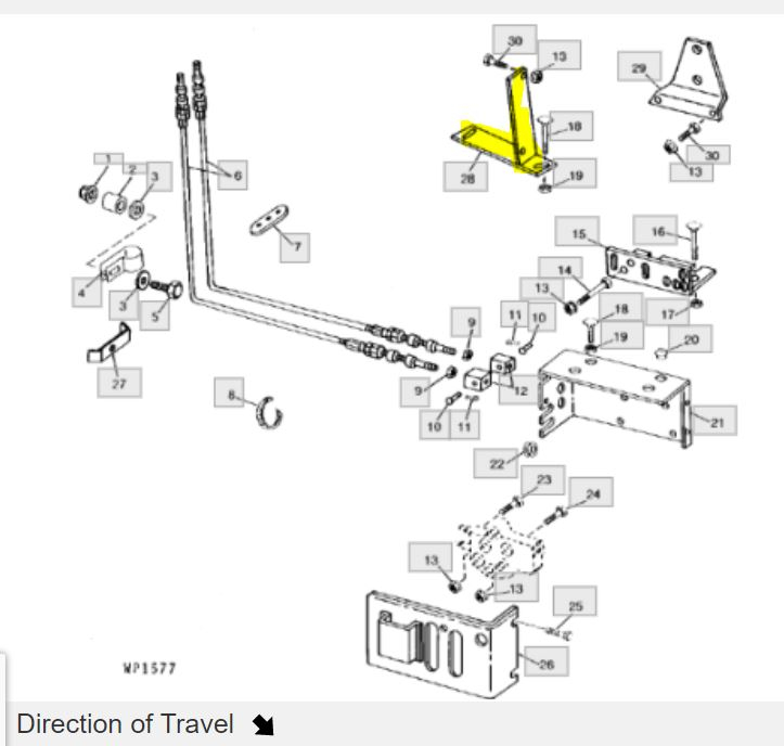

If anything like my JD 245 loader, the valve for the joystick, mounts inside a box on the right loader frame. Mine uses the bracket highlighted in yellow. To mount the box on the top of the loader frame. LMK if you need pictures from my JD 2030 with JD 245 loader.
Pressure hose to the valve will "TEE" into the line from the PCV (Pressure Control valve), coming out of, or to the rear of the PCV. The return to sump hose will connect to the transmission oil filter cover. It must have a "ported" filter cover/housing.
From everything I have seen, the 3255 is the same. Hoses feed from the loader into that box and joystick out and up into the cab.

You're very welcome. I don't have any personal experience with a 3255 but have experience with mounting FEL on 2950/2955's. Closed center hyd system's on most JD Mannheim built tractors are very similar. Does your 3255 have a ported hyd filter cover?

Here's from JD parts. Key 8 is non ported cover, key 10 is ported cover. $95.36

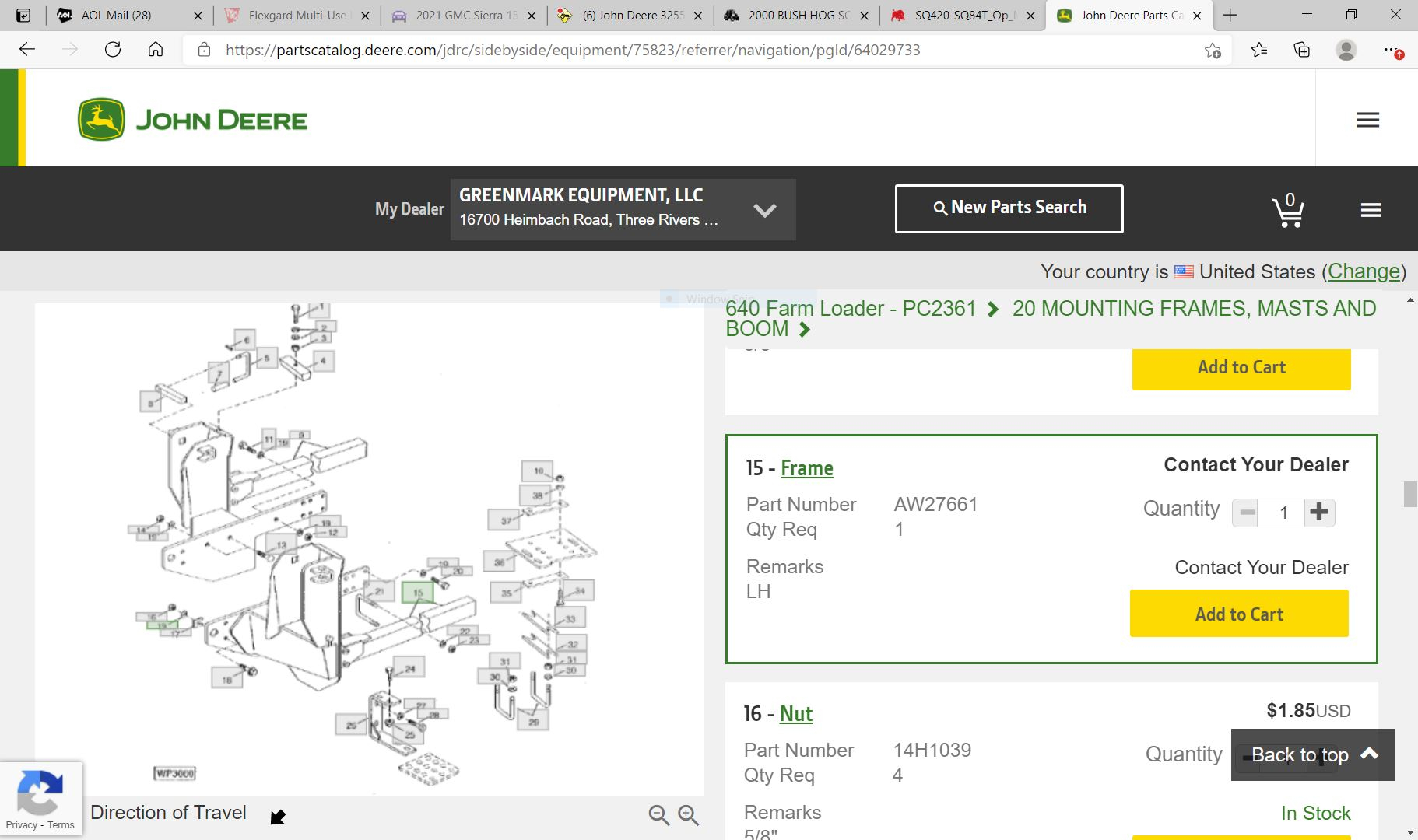

John Deere sold several loaders that used mounts that attached to the rear axle.
245,260, 265, 640, & 740 all have mounts that attach to the rear axle. I would not want to fabricate mounts when they exist.
I would seek out a 640 loader
I have a pair of these mounts if you need measurements, they are for a 640 loader
Totally. Definitely not my preference, but I am finding these mounts quite hard to come by up in Canada. I do see them more often down there, but with borders closed until who knows when, it gets harder to get them home. Basically looking to see if there are other feasible alternatives.
I will add the 640 to my search list and see what I come up with. Thanks!
