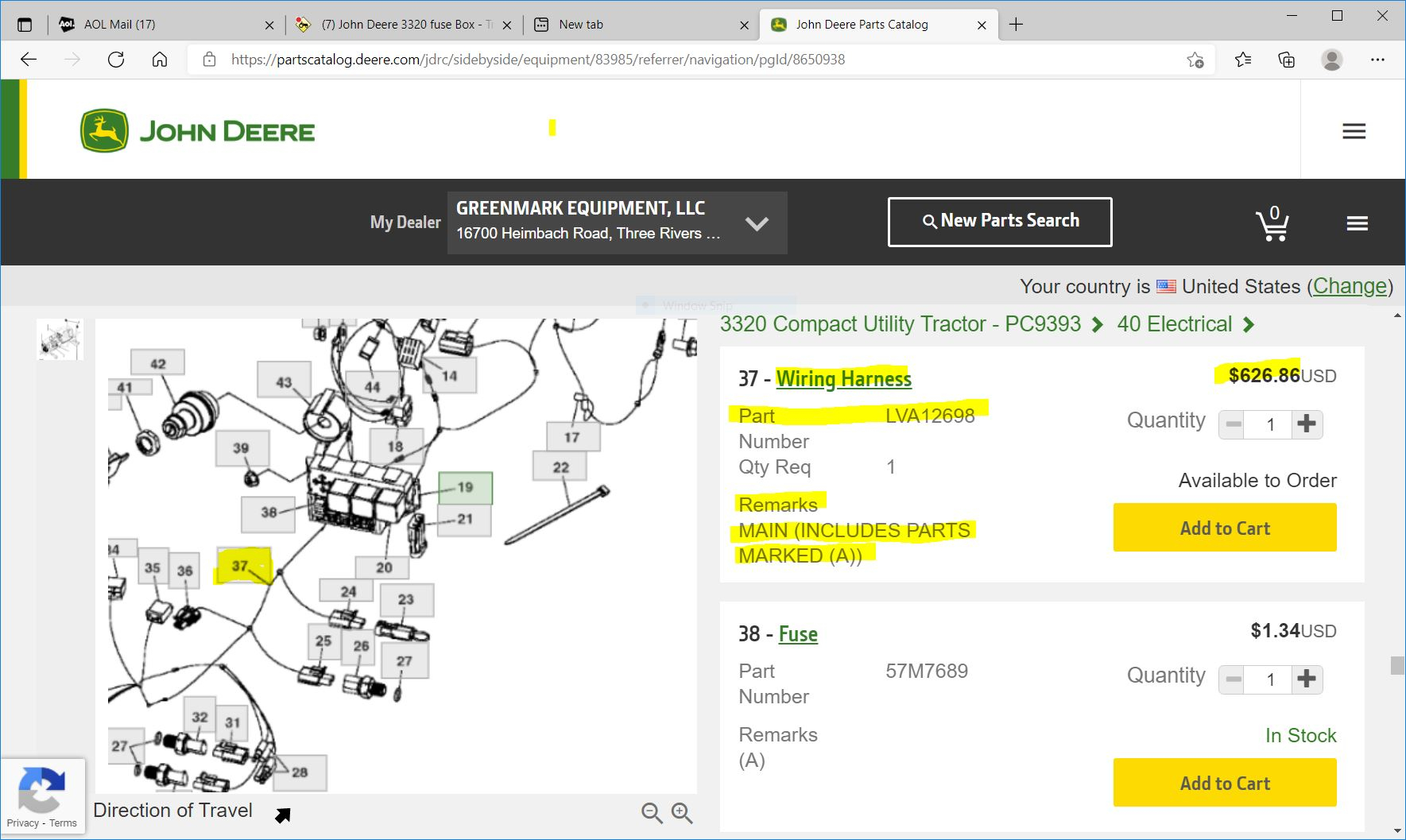

Does anyone know what the part number is for the fuse Box in a 2012 john deere 3320? I have already moved one fuse location and installed new metri pack terminals due to the corrosion.
originally i was having a no start condition and just thought was a battery issue but turns out to be corrosion. i have looked on the deere website and also called the dealer to no avail.
   / John Deere 3320 fuse Box #2
To get the fuse box, you have to buy the complete harness.
Notice key 19 has no P/N or price. Remarks say A
If you look at key 37, the harness, remarks will say includes all parts marked A

Thanks for the info, greatly appreciated!
