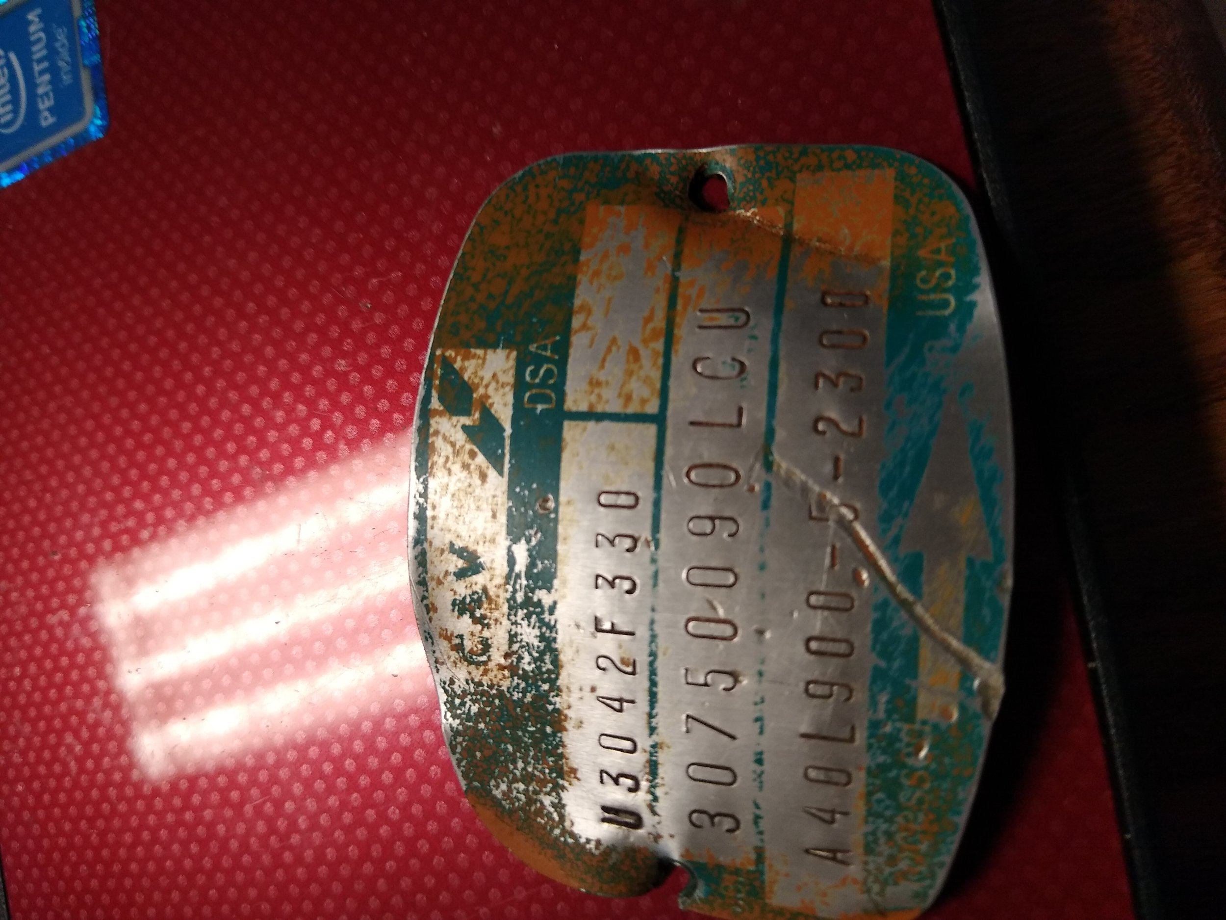

Appreciate the explanation...
My brother had a local shop rebuild it so I don't know the particulars...
It was running and put away for the season in the tractor shed... come spring... it would not start/run until pump rebuild.
It had always started instantly before in our mild climate.
Only have about 40 hours on the rebuild...

what numbers do i need to check govonor thottle spring location im thinking 5
   / John deere 350c running rough #13
Some have tried and succeed, while other have tried and failed miserably..
U need a rebuild manual and special tools.. and remember, that manual is made for an experienced tech w the proper tools..
hi trying to double check spring location on govenor and thottle thinking 5
   / John deere 350c running rough #14
It looks like a 5 to me to..
Which translates into a 2 & 2..
