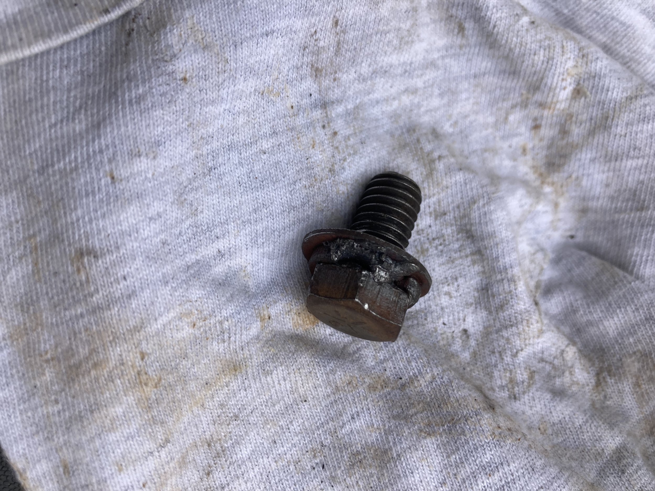

I tried to start the tractor yesterday, when you turn the key usually the dash lights come on, then turning further starts the engine. Now when I turn the key everything is dark, I charged the battery overnight so its good. When the key is on if I turn the headlight switch the dash lights flicker, but then go dark.

Sounds like an issue I had with my Case 580SE backhoe. My lights worked, but when I tried to start it I lost all power. I thought it was the 4 year old battery and replaced it. No joy! After scratching my head for a few hours I found that the ground wire was corroded at he lug, under the shrink wrap! I put a new lug on it and it has worked great since!
Sometimes the most baffleing problems are the most simple!

Had the same symptoms on a Mahindra. Bad ground. Take the ground wire off at the frame and scrape / clean the connection to bare metal.
