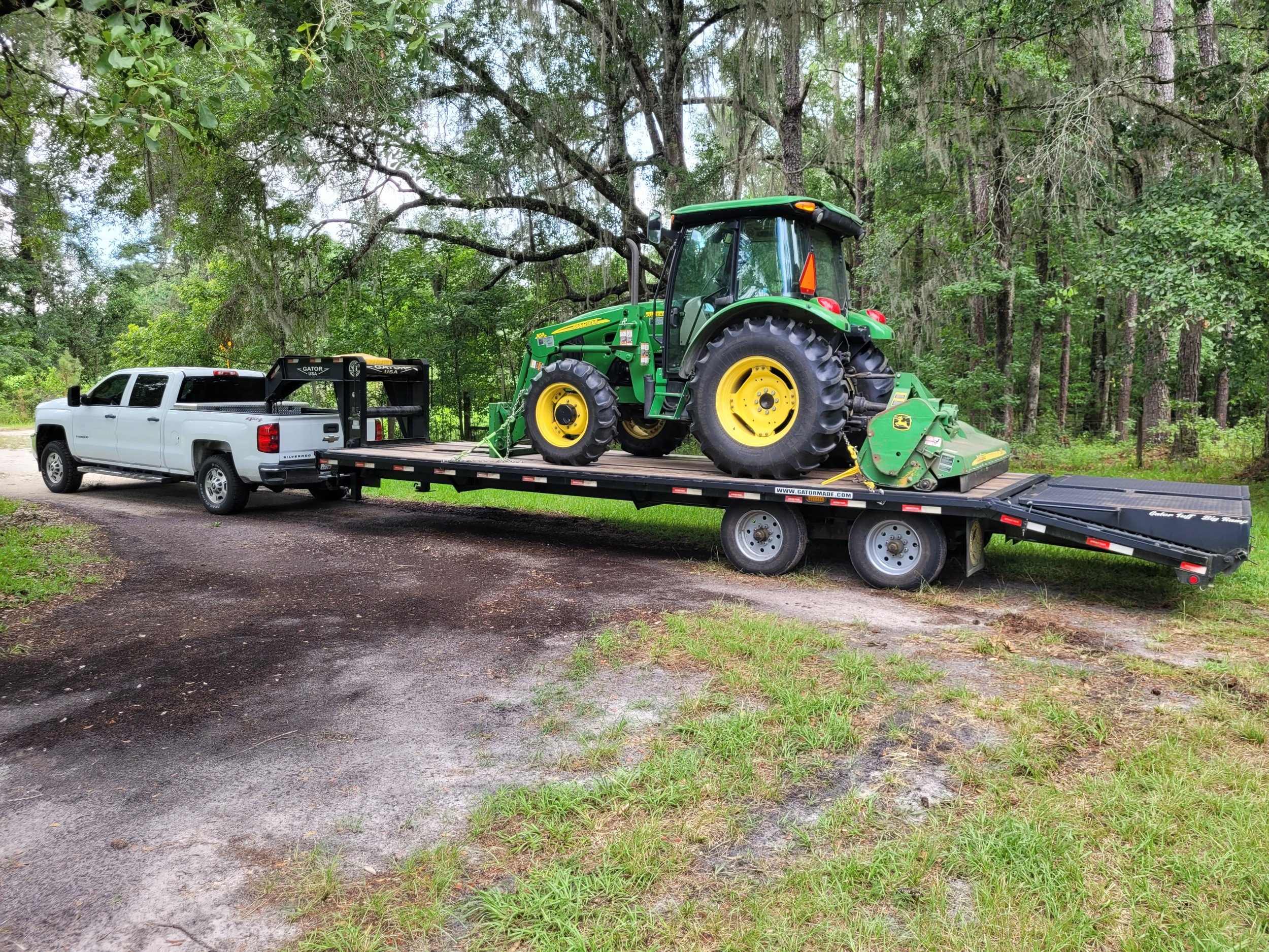

LNF, that might just be the best 600 bucks you've ever spent. The deal that I got on mine was the best deal on one until you bought that one. That's a flail of a deal.
Yeah, after 10% buyers premium and 7% sales tax it was $580.50, sometimes you can get a deal at an auction other times if there are a bunch of dealers , the price get's run up as high as a new one.

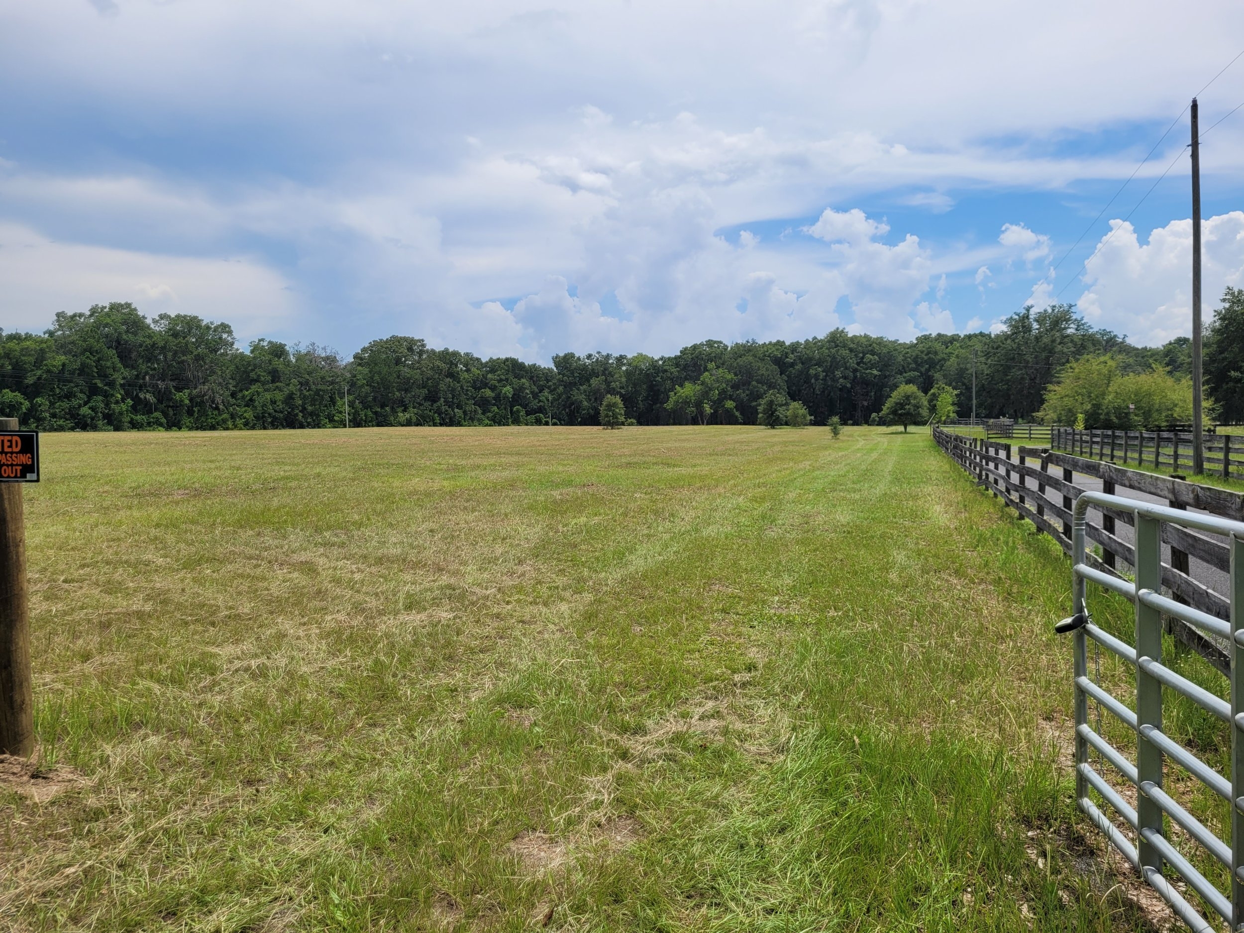

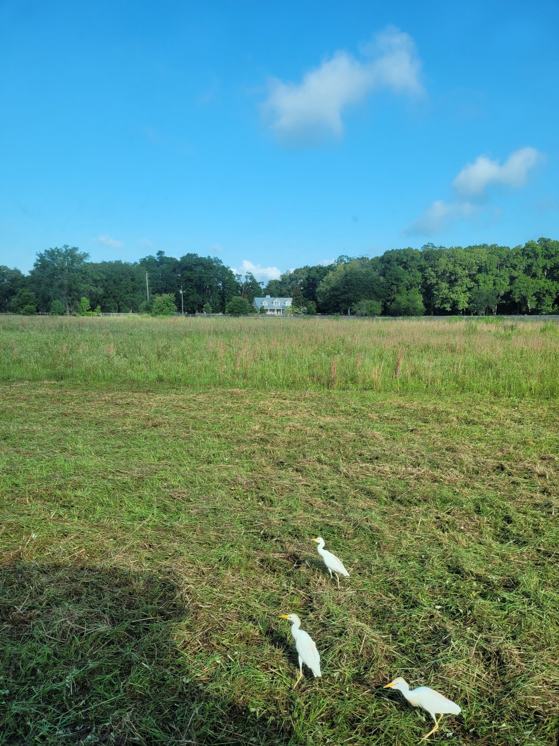

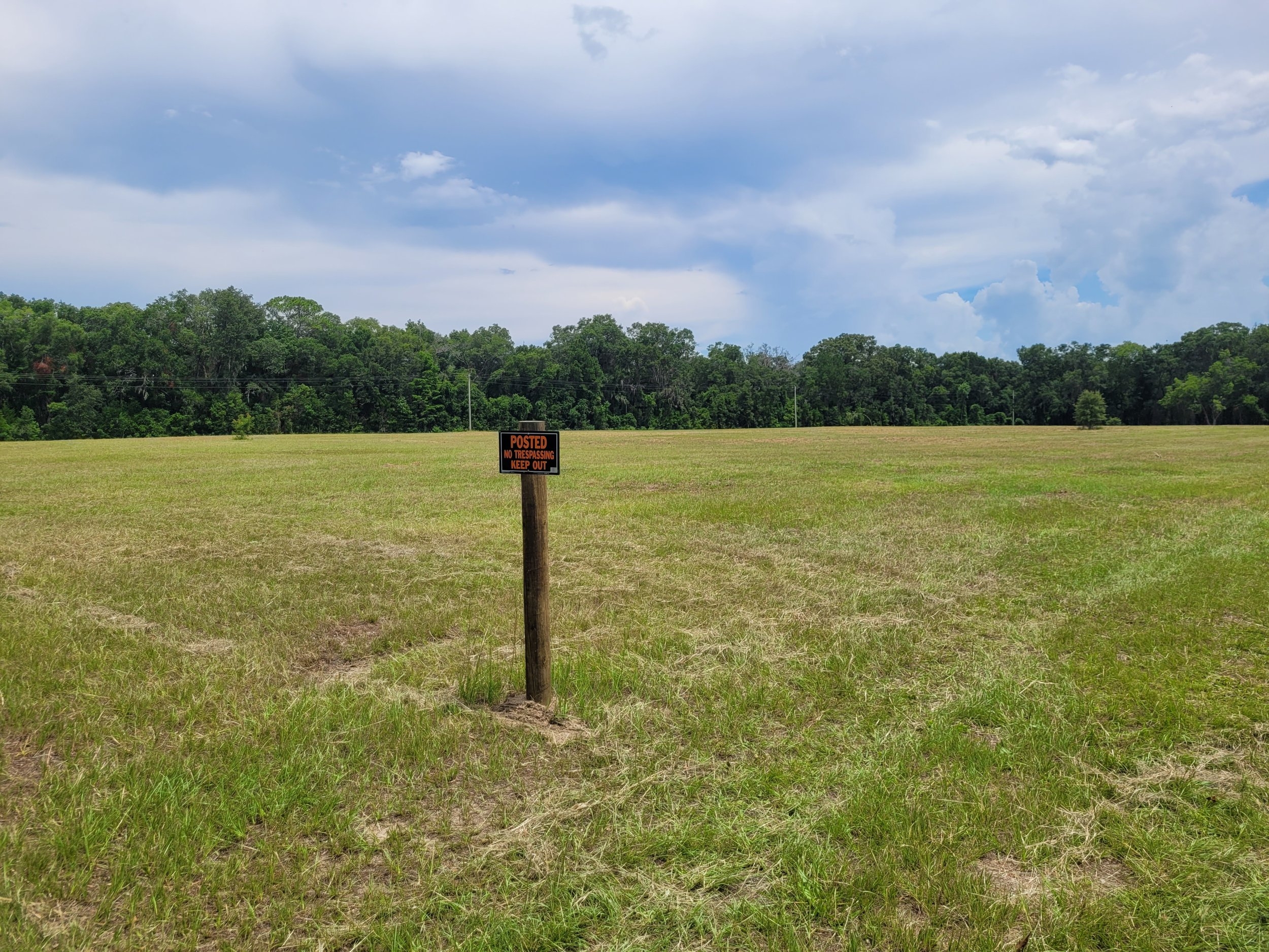

Well I did a job with it today and thought it cut pretty good, did 10 acres and it has already paid for itself, I'm sure as I learn more about setting it up and experimenting a little I can fine tune it, looking at it this afternoon it looks like to me these l shaped blades can be flipped to use the other side to cut with, I'm learning as I go.
