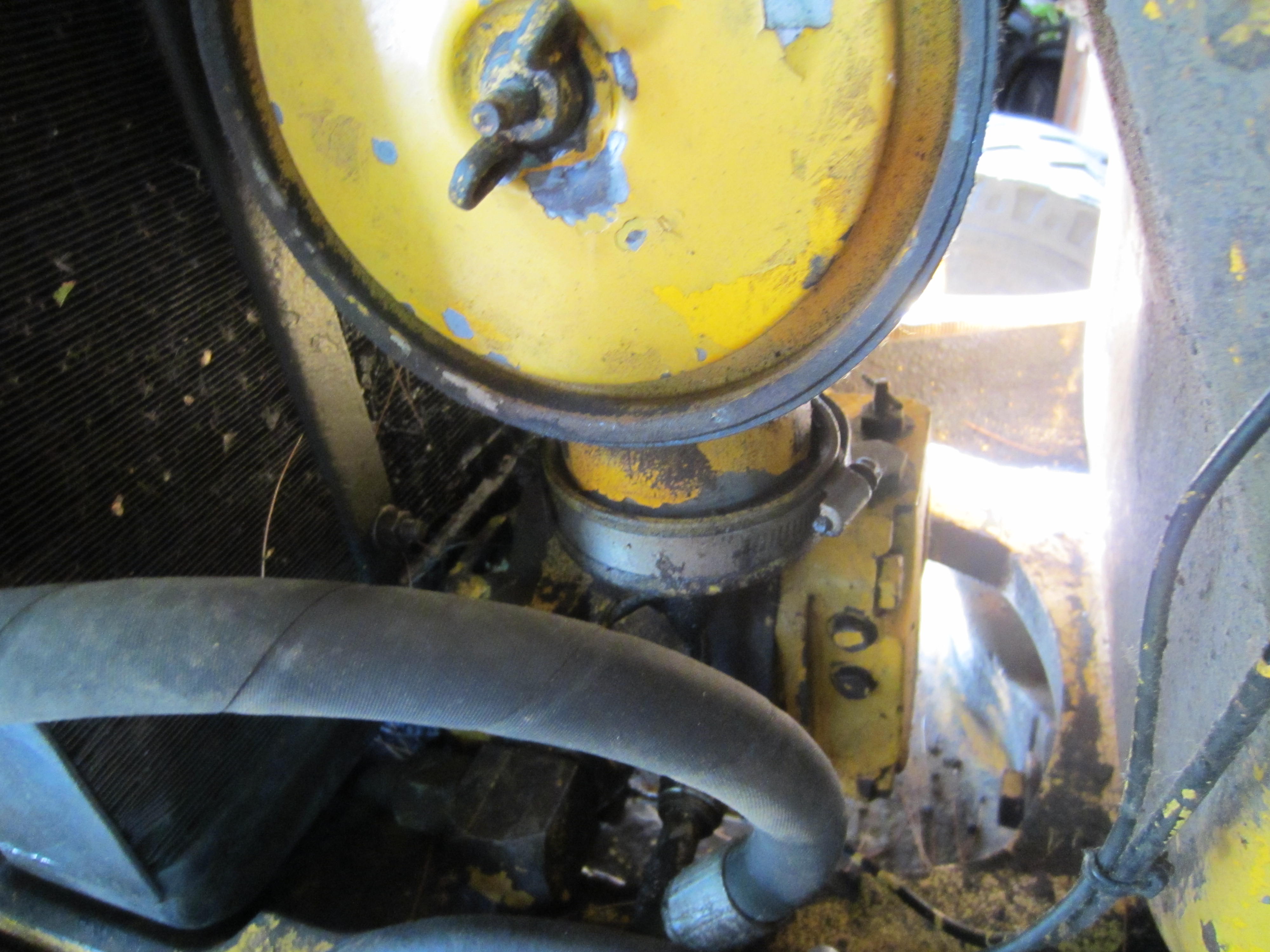

There's no relief valve on the vertical filter so I will remove the valve on the pressure control valve when time becomes available. I do feel the pulsating on the outlet hose of the hydraulic pump if that means anything :licking: IMG_1098[1].JPGIMG_1097[1].JPG Where do I put the pressure gauge on the hydraulic pump?
   / John Deere 401C Hydro trouble #24

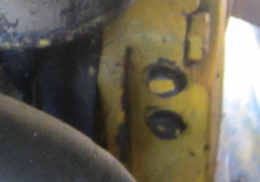

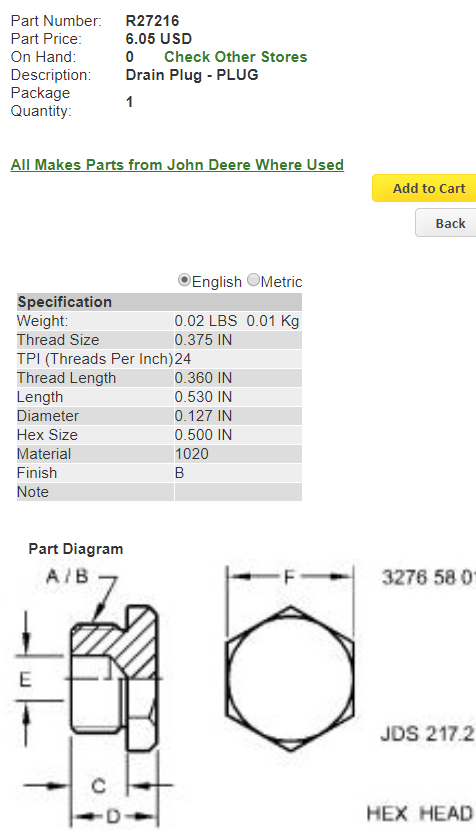

You can remove either of 2 ORB plugs on RH side of frt portion(head) of hyd pump to install a gauge. Photos below has plug spec's. & location

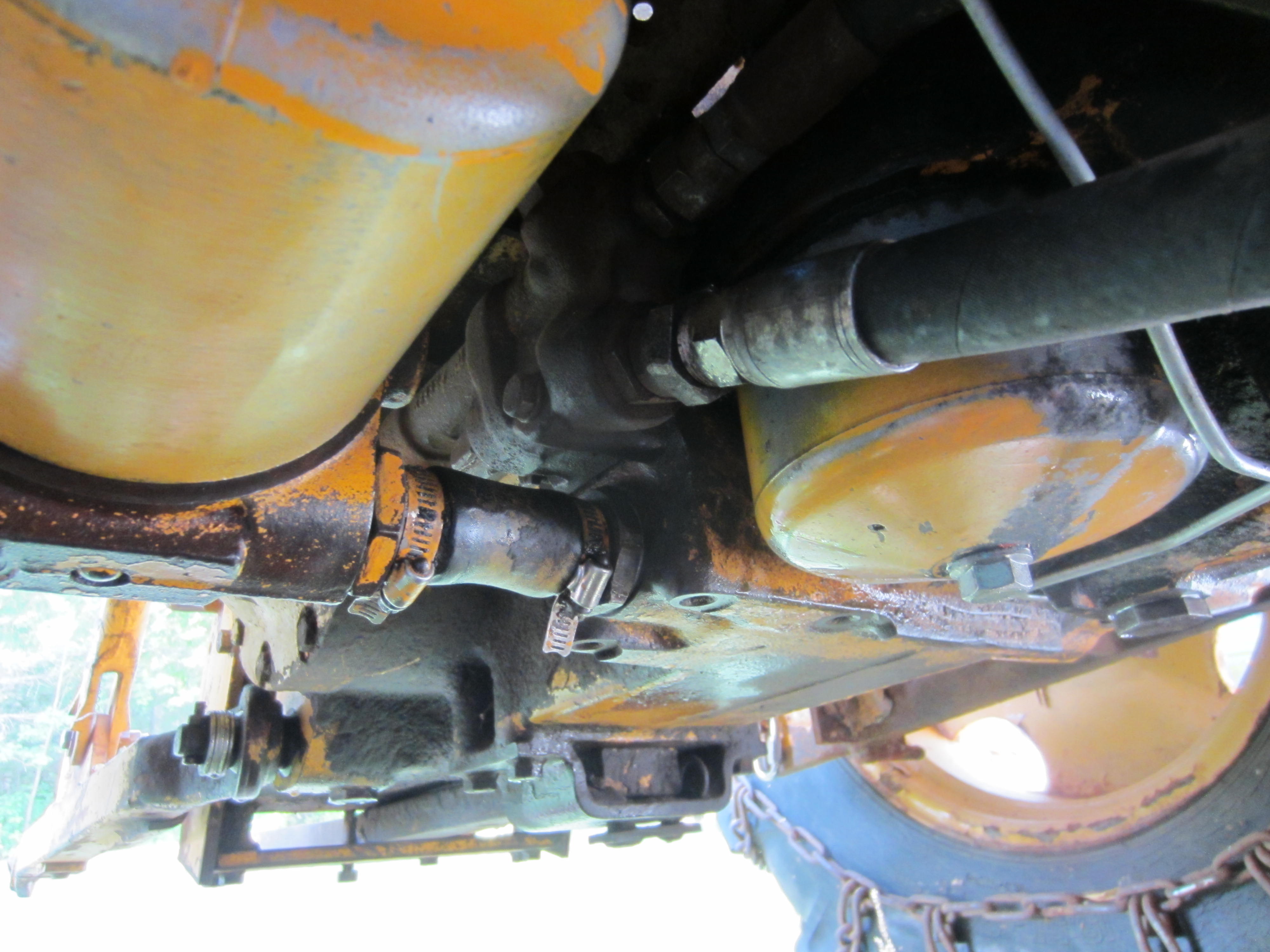

Finally got the pressure gauge on via PS line and only have around 300 psi. I will check the flow from the transmission pump next, with time slots in my schedule. Can I remove the pressure control valve without 10 gallons seeking ground? Is it only the drain plugs which will pour out the contents of the sump or is there others I should be aware of?
   / John Deere 401C Hydro trouble #30
I didn't test the flow from the transmission pump as time was against me as Fall as arrived and will be cold soon. How does the pressure relief valve come out? You would figure it to be somewhat under spring pressure as the cap is tightened but it's not the case here! Can it be seized in the housing?
