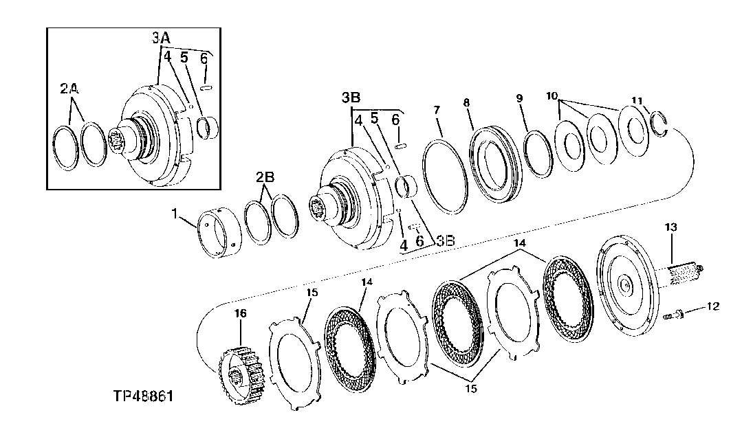

Hey guys,
Well, since I stared this thread, we took the machine to a shop and had the engine, dry clutch, power steering pump, and radiator replaced. Engine cranks and runs great, hydraulics are good and strong, but the machine will still barely pull itself. It has about two gears that it will pull itself in. It does seem to work fine in reverse, just not forward.
Any ideas what the issue might be? Wet clutch pack? Hydraulic pump? I'm guessing it's going to take breaking the machine apart again to fix it, right?
Also, filters are new and we cleaned the transmission sump screen.
Thanks for ideas and suggestions.
   / John Deere 410 backhoe, have to split in two, need help please!! #14
Sounds like the forward wet clutch pack is slipping. The disks may not be worn out, but seals definitely need renewing. Parts 2, 7, and 9 are the seals. Part #1 is a sleeve the sometimes gets worn from seals #2, so pay close attention to that.

I agree check forward clutch, since reverse is OK

Some one did a post on replacing the O rings in the forward clutch pack. It top gear at fast idle (1000 RPM?) when you move shuttle to go forward or backwards it should kill the engine. Our 310B is OK cold but after working it hard it will slip going forward especially in high range which is not a real issue since we just use in around the place most of the time. Racing the engine for 1 second and letting off the fuel will let the front pack clutch lock up in our case. One must NOT operate it if the clutch pack will not lock up. I had to back ours to the house when we first got it but after a couple fluid and filter changes we got most of the water out of it and it did better. I have found adding a gallon of Lucas Hydraulic Oil Booster from time to time helps some all way around.
