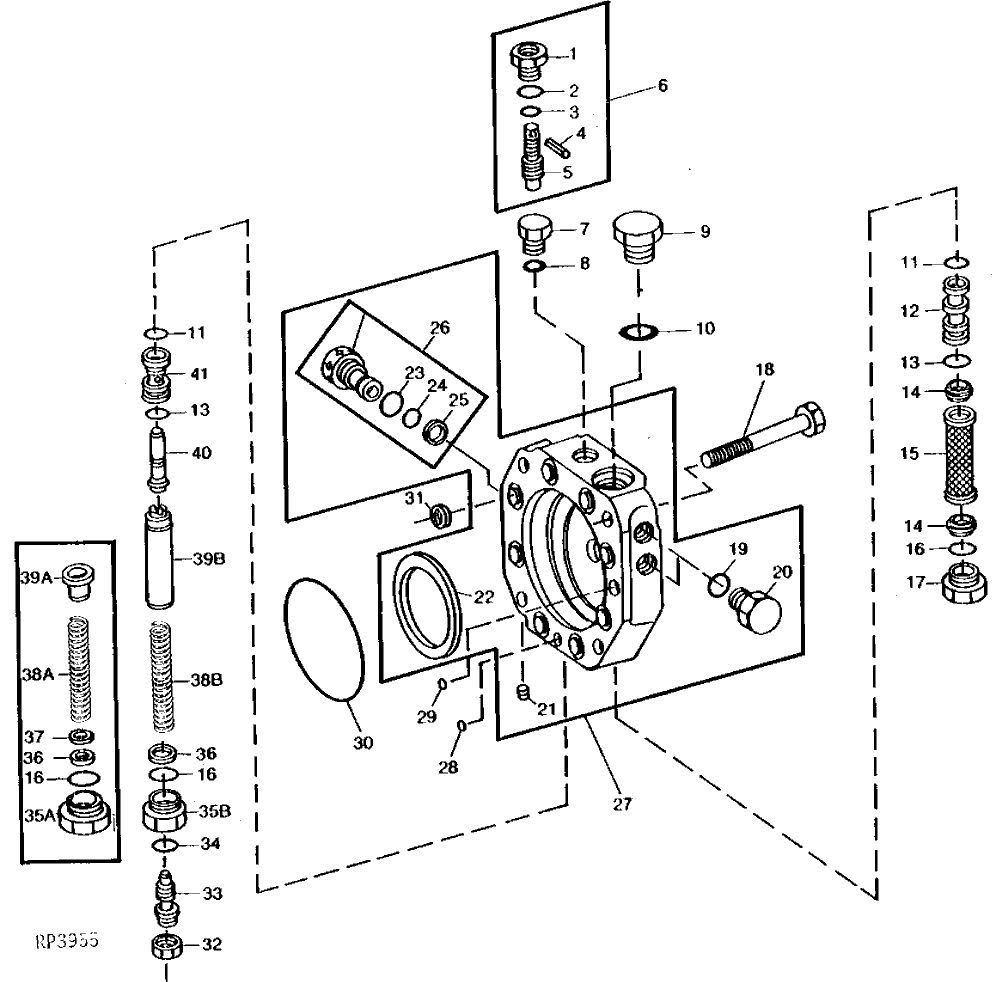

On the splitting question I can't answer very well because my experience is with ag not ind tractors. Before you replace the frt hyd pump I would suggest checking stand-by pressure. It should be in the 2250-2350 range. Stand-by pressure can be adjusted by loosening lock nut and turning screw(parts key #33 1st photo). Did your mechanic check hyd oil sump screen for cleanliness? Hyd oil screen is in 2nd photo

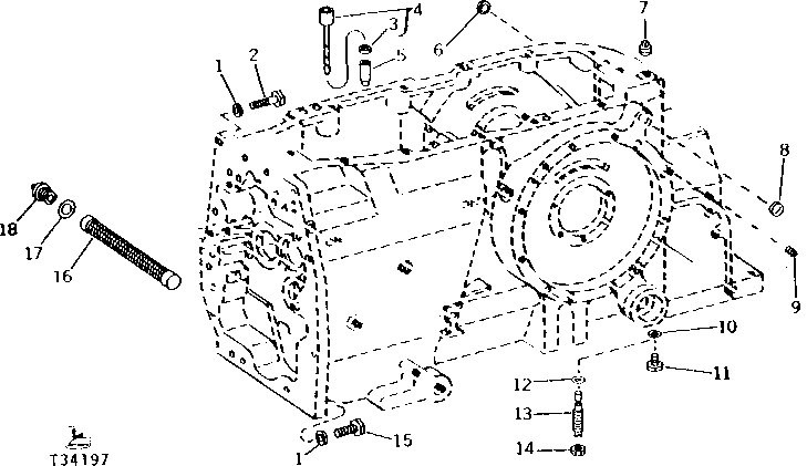

Are you sure it's the rear main seal? There is a weep hole at the bottom of the clutch housing. It should have a cotter pin in to keep the mud wasps from filling it up and sealing it off. Is this where your leaking oil? Is it motor oil or hydrualic oil?
You have both a dry clutch and the reverser has a wet clutch pack. either could be the cause of not being able to pull it self.
Weak hydraulics could be plugged suction screen, as TX Jim said, find out if it was cleaned first.
Is the tractor drivable enough to remove the loader and drive away? You need that off to split.
Find out what AG tractor this is based on. Maybe 2030? Then get a service manual for it. Will be cheaper and have splitting instructions.
Check with a JD dealer and find out if a special tool is need to install the rear crank seal. There is for the 2030.
If the 410 is based on the 2030 AG tractor you should be able to split. I've split two 2030s, one twice, so I've done it three times.
It may not be a rear main seal leak, but the reverser where it goes thru the clutch housing if hydraulic fluid leaking.

Will any kind of pressure gauge work to test the standby pressure, and where do I hook it up?
Also, is that sump screen located in the hydro pump, or somewhere else on the tractor?

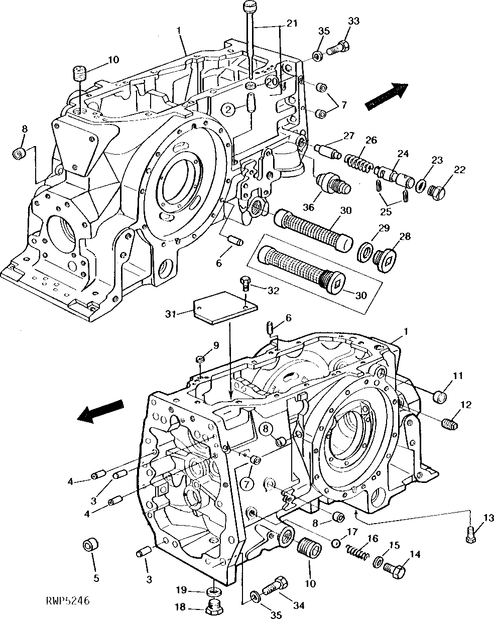

You can get a gauge at Surplus center for under $15. You can access sump screen on RH side by hyd filter.
   / John Deere 410 backhoe, have to split in two, need help please!! #8
Incase it's not obvious the suction screen is key 30 in the parts drawing Tx Jim posted
