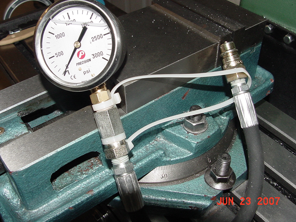

Could you explain a little more about using a gauge to check the relief valve such as the
connection point and expected pressure?
Thanks, Dan
/ John Deere 4200 loader slow #4
Dan, the gauge simple plugs into a loader QD, then you operate the joystick to send pressure to that port-the max system pressure will be displayed on the gauge. Look at the picture of mine below. Just a gauge, short hose and a QD. Not sure exactly what the pressure rating is (we can find out though)-but should be about 2500lbs.

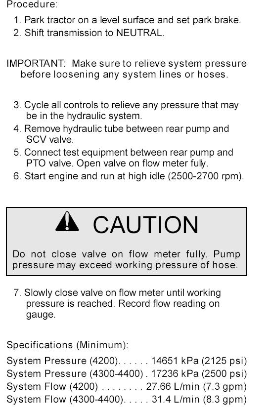

A 4200 should be 2125 psi.

Link? No. But it very simple...screw hose onto gauge, screw QD onto hose.

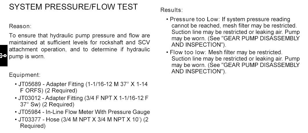

I found the service manual, the following introduction to the hyd. system check.
Mentions flow test as well as pressure test.
Did I understand you to say you cleaned the mesh filter?
See if this introduction helps. Read left column of first pic, then the second pic, and finally the right column of the first pic. :)

OK...
Gauge from the Surplus Center
Hose
NPT adapter
And a QD nipple fom JD that fits your machine...
