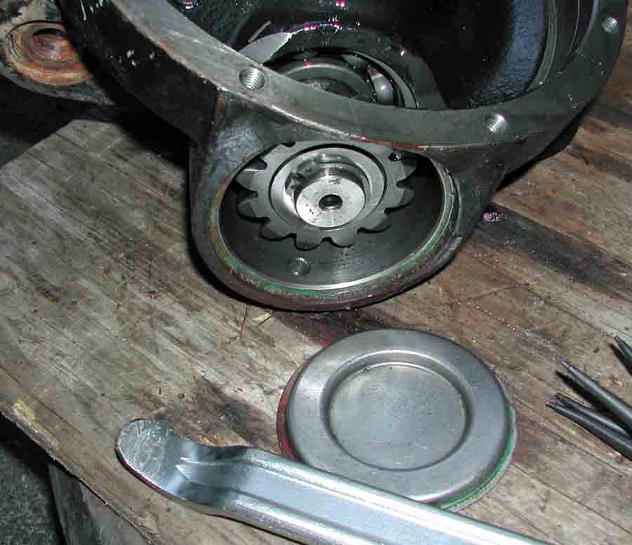

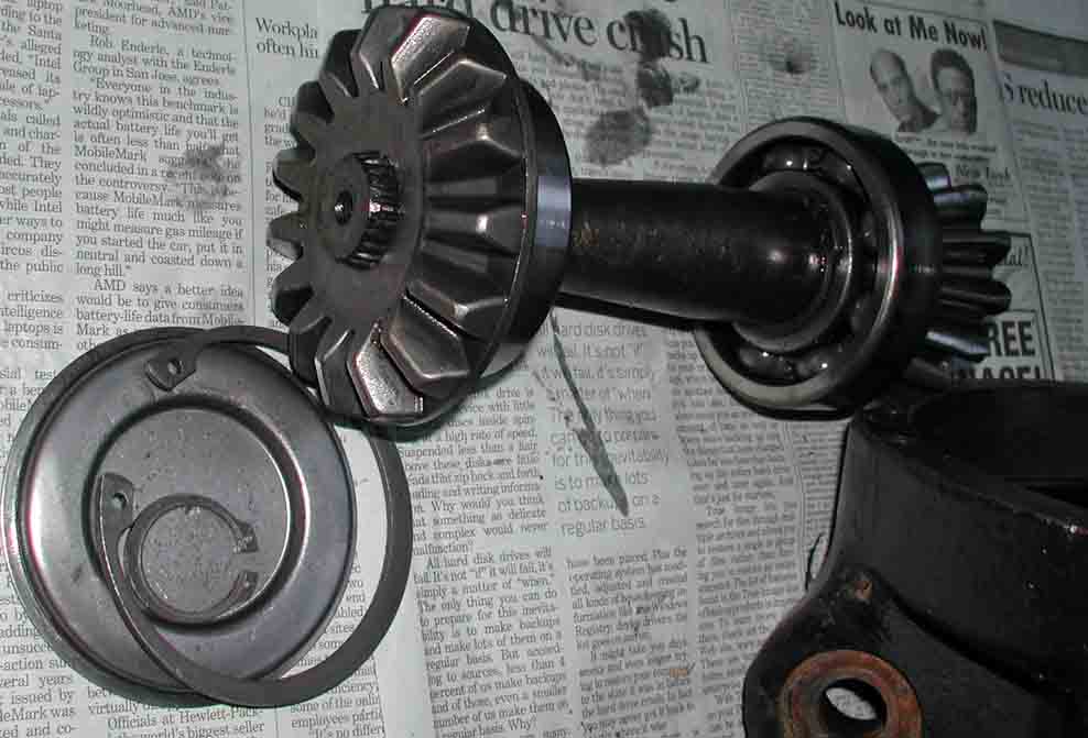

Now I need to remove the kingpin.
This MFWD system requires the removal of the kingpin housing end cap
to get the kingpin out. Some systems let you get it apart from above,
where the bevel gear connects to the top of the kingpin.
To remove the end cap, this tractor does not provide any "cheater slot"
on the outside to get a screwdriver in there, so you need to push from the
inside. The first photo shows me using a tire iron against the bevel gear
that drives the hub ring gear. Hopefully the bottom of the housing is free
of dents from rock incursions. Mine was fine, and it came off easily.

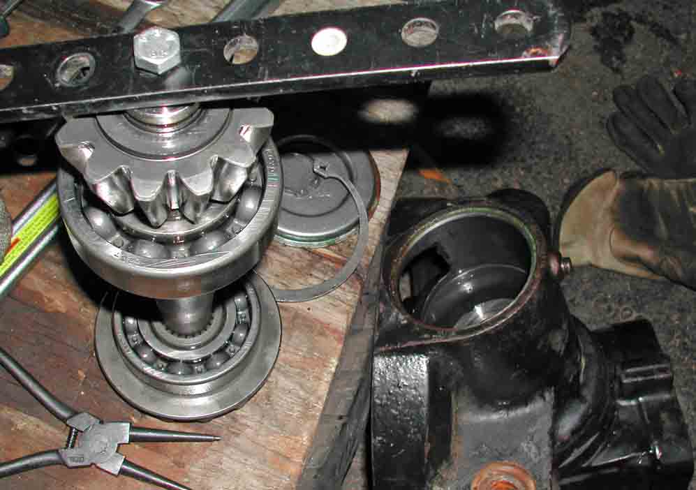

In the 2nd photo, you see the cap, just removed. The bevel gear has a
small snap ring and it comes right out. You can see the end of the kingpin.

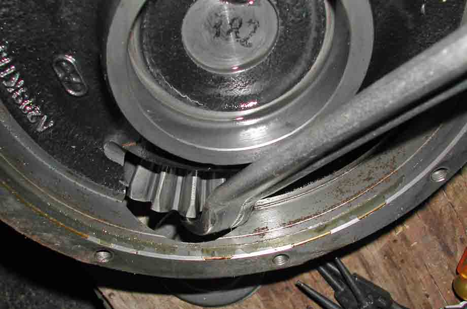

Notice the hole in the end? It is threaded and I will need it for the next
step. After the bevel gear is out, there is a large snap ring about 4 inches
down inside the housing. This was very tough to remove.
The third photo shows part of how it did it, with the removed snap ring.
Once the installed snap ring is partially retracted (with pry bars), I needed
some way to pull on the kingpin. That is what the bar and bolt did for me.
The bolt was threaded into the hole, and it put just enough upward force on
the snap ring to allow it to come out. I don't know how clear my
explanation is, but it sure goes in a lot easier!
Finally, there is my kingpin. Very beefy, but a little corrosion on it. The
gears are not noticably warn, and all the rest of the bearings are OK.
I still don't have access to the last seal....that is the last step (next).

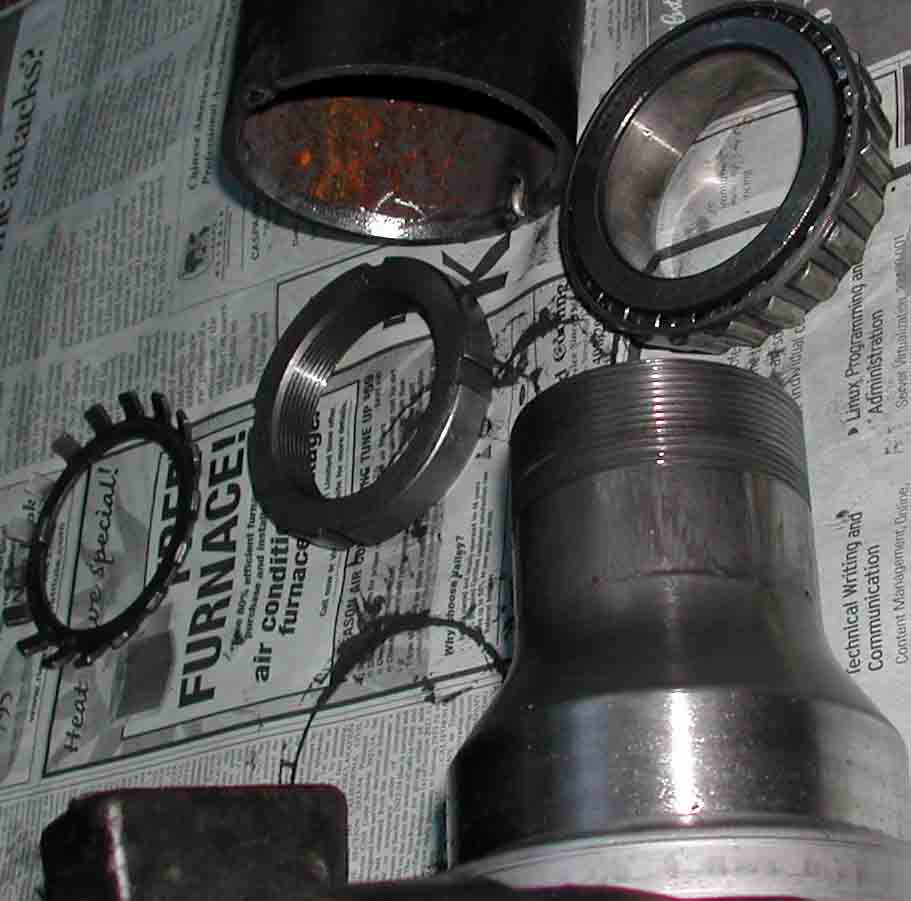

Now that the kingpin is out, I can get the last two housings apart to get
at that blasted kingpin seal. Note: my hub seal was leaking badly, but my
kingpin seal was not. I decided to change the latter seal out anyway
because I wanted to assess the condition of the other bearings. Happily,
JD uses large tapered roller bearings in there, and they are in fine shape.

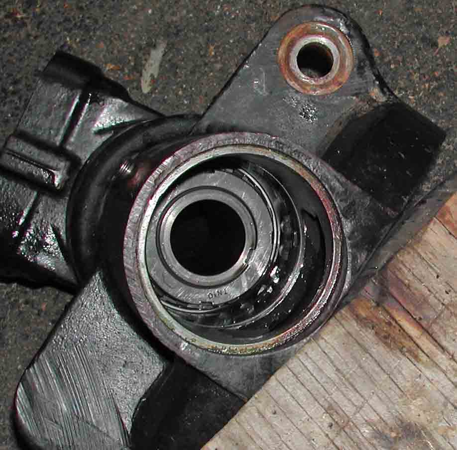

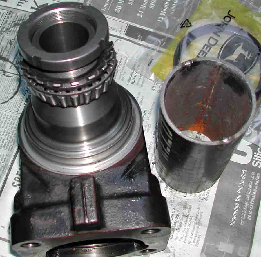

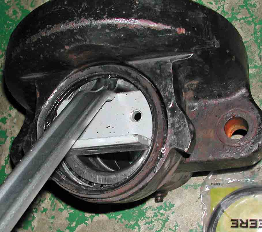

To get these last two housings apart, you can see (first photo) a large
nut with four slots. Special tool alert! :-( I am not a fan of special tools,
but nevertheless, I had to use one. I first used a large screwdriver to
retract the staking collar (not visible). To make my tool, I found a chunk
of schedule 40 pipe, which has a slightly smaller ID than the OD of the
nut. With a die grinder/carbide cutter tool, I beveled the edge, then
welded two small beads on opposite inside edges. Now I can grab two of
the nut slots and use a large channel lock pliers grab the pipe and unscrew
the nut. It worked great, and the 2nd photo shows the results. The 3rd
photo shows the staking collar, nut, and roller bearing.
Finally, I removed the large seal with my trusty tire iron. Voila.
Assembly, as they like to say, is a reverse of this process. (500 times
easier, too.)
A final note on DIY replacement of these seals: this was tough, and it taxed
the limits of my abilities and tools. Other seal replacements I have done
on MFWD axles were many many times easier. I can not recommend that
MOST people attempt this project for this tractor. I saw this process as a
personal challenge.....others may only be frustrated.
