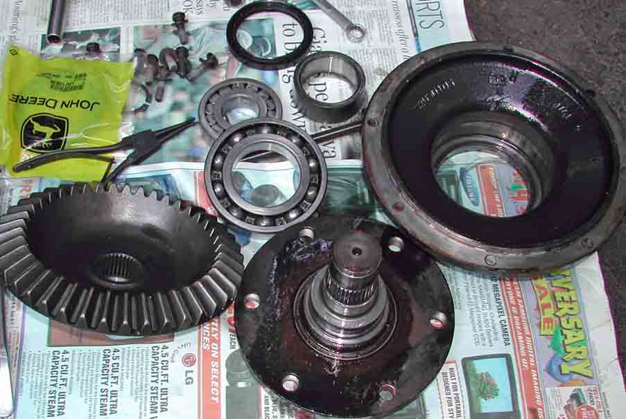

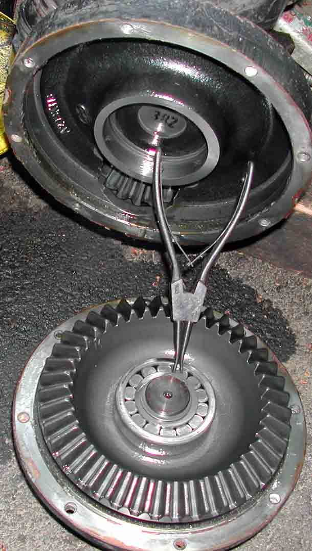

Here are the roll pins that Deere uses in some places. They are a double-
wound single piece of spring steel. I have shown the new one and the old
one. The latter gets dirt in the center, making it look solid. Add a bit of
rust and this baby is very tough to remove (and install). Some roll pins used
are the conventional type, like the one on the right.
Can anyone identify the other part in the photo? I found it in the bottom of
the final drive gearcase. It is a cylinder that is clearly punched out of a
plate of steel, then precision ground to be exactly 1/8" thick.
Those are spiral roll pins. SPIROL is one trade name. They're not as common as the other roll pins but are available. You can get them fr McMaster-Carr.
