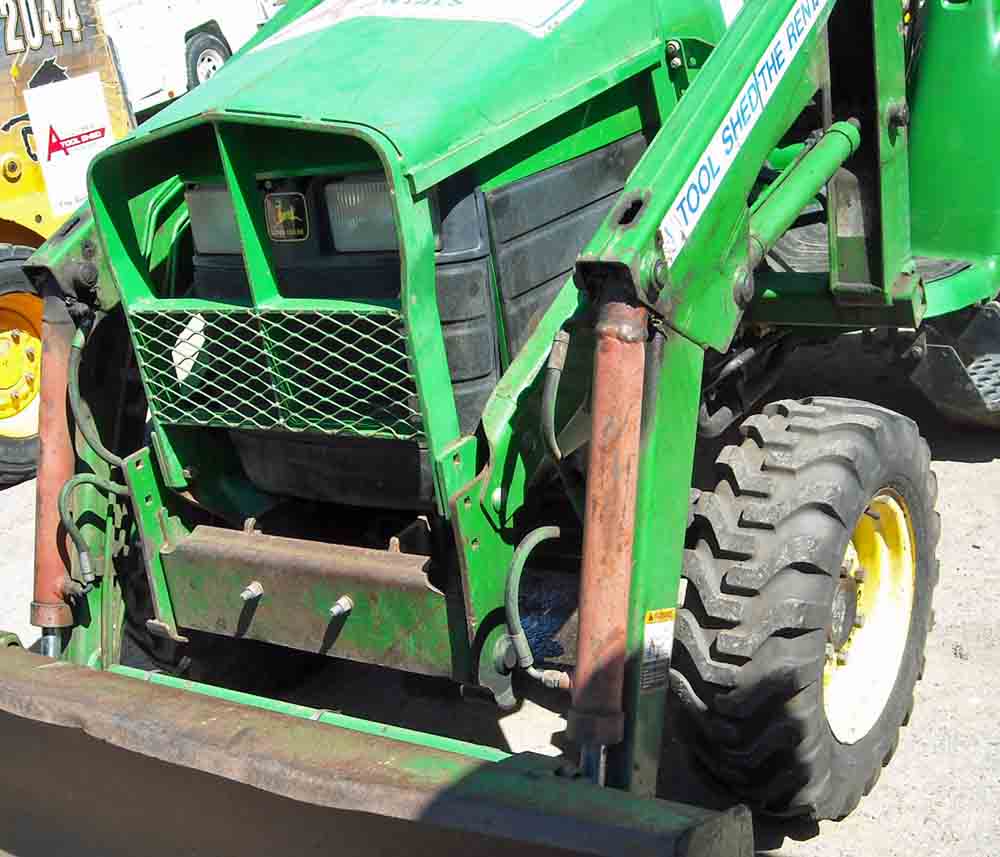

Thx for the support, guys. I just got my engine block back from the
machine shop, so it looks like I can rebuild it with .25mm O/S pistons.
As for the FEL cylinders....the rods are only 25mm (one inch) in diameter.
Needless to say, most of the units have had theirs bent. The photo shows
one of the other 4300s in service....you can see the bucket cylinders are
rust colored. They have been rebuilt by a hyd shop that does not bother
to repaint. There are only one or 2 of these cyls that have NOT been
rebuilt (of 7 or 8 tractors).

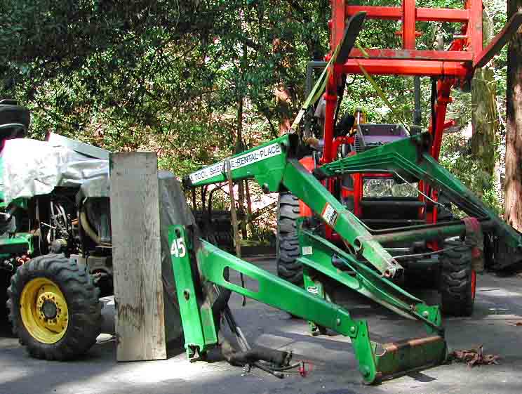

Now for the dissassembly. Removing the FEL was tough. Without any
hydraulics, these things are terribly unwieldy. I ended up taking it all
apart to remove it. I like the QA loader bkt. I never had one of those.
The FEL pivots are in pretty good shape....at least all the pins are 25mm
in dameter.....the FEL pins on my 955s were quite a bit wimpier (17mm).
As I start removing things and splitting the tractor, I noticed that most
bolts are 13, 15, and 18mm head sizes. I have never SEEN an 18mm
socket, as none of my many socket sets comes with one. Very unusual.
