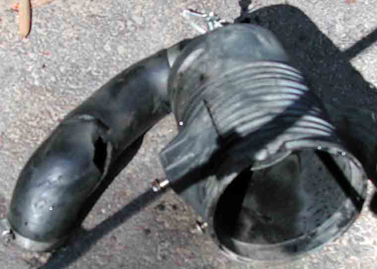

And here is my "eureka moment". The report on this tractor was that it
ran, but very poorly, with lots of black smoke. The air filters were correct
and in place, so the cause of the engine failure was unknown. Until now.
The first photo shows a split in the air hose between the air filter housing
and the air intake mainifold. The culprit hose, which is open to dirt, is
pinched between the fuel tank and the valve cover. The split was invisible
until I cleaned things up and started to remove the bracket that holds the
filter housing.

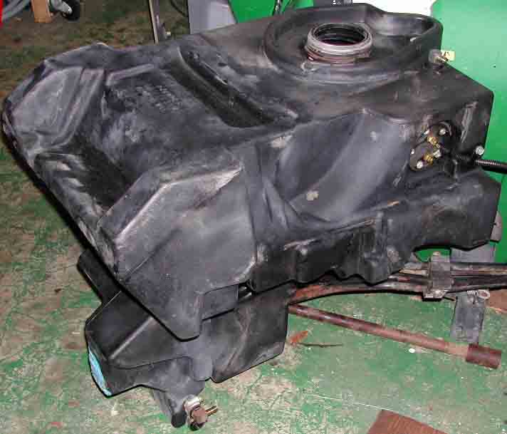

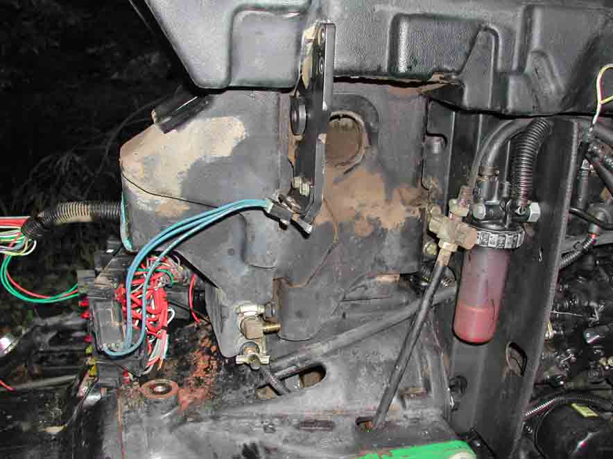

Now I need to get the fuel tank out to get access to the valve cover and
the air intake manifold. I have never seen such a difficult to remove tank!
I had to remove the steering system support, PS hard lines, instrument
cluster, fuse panel, numerous brackets, and the 2-sided brake pedals. The
pedals pivot on a shaft that goes through the middle of the the fuel tank!
JD was willing to do ANYTHING to get 10 gallons of fuel in there it seems.

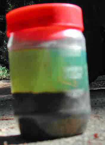

I give Deere a LOT of credit for putting a fuel drain in the tank. Every CUT
I have rebuilt has had sludge in the bottom of the tank, and this is the first
time I have had a drain petcock. The jar shows the last bits of liquid I
removed thru the drain. I had to blow into the drain a few times to get
the last to come out.

At last I got the fuel tank out....it took hours! There is NO access to
the engine while the tank is in, which means no valve adjustment and,
in my case, no access to the engine ID. (There are 2 different engines
used in the 4300, and I needed to know which one I had inorder to buy the
correct pistons.) Hmmmmm.
So here is the damaged hose. It was pinched between the tank and the
valve cover, and an additional hose. Vibration, dirt, and a non-reinforced
hose did this poor machine in. It seems to me that a fiber-reinforced hose
(like a water hose) could have been used to avoid this problem.

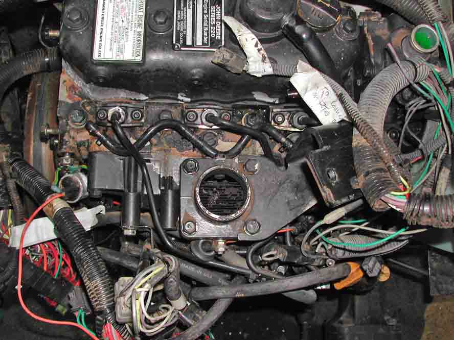

Look inside the air intake.....yeeecchh! What you see is the air heating
element (used instead of glow plugs) covered with dirt. Now I am in a
hurry to get that engine open because I am sure some water got in there
with all the pressure washing that I did.

The bigger concern for you guys with a JD 4200/4300/4400, and maybe the
4x10s is that you could be in for a split air hose. This event will cause
the engine to eat dust, eroding your cylinders, with quick failure. As the
engine starts to get lower and lower compression, it will be harder to start
and you will get more black smoke, due to partially burned fuel. Checking
your hose can only be done if you remove the fuel tank.
