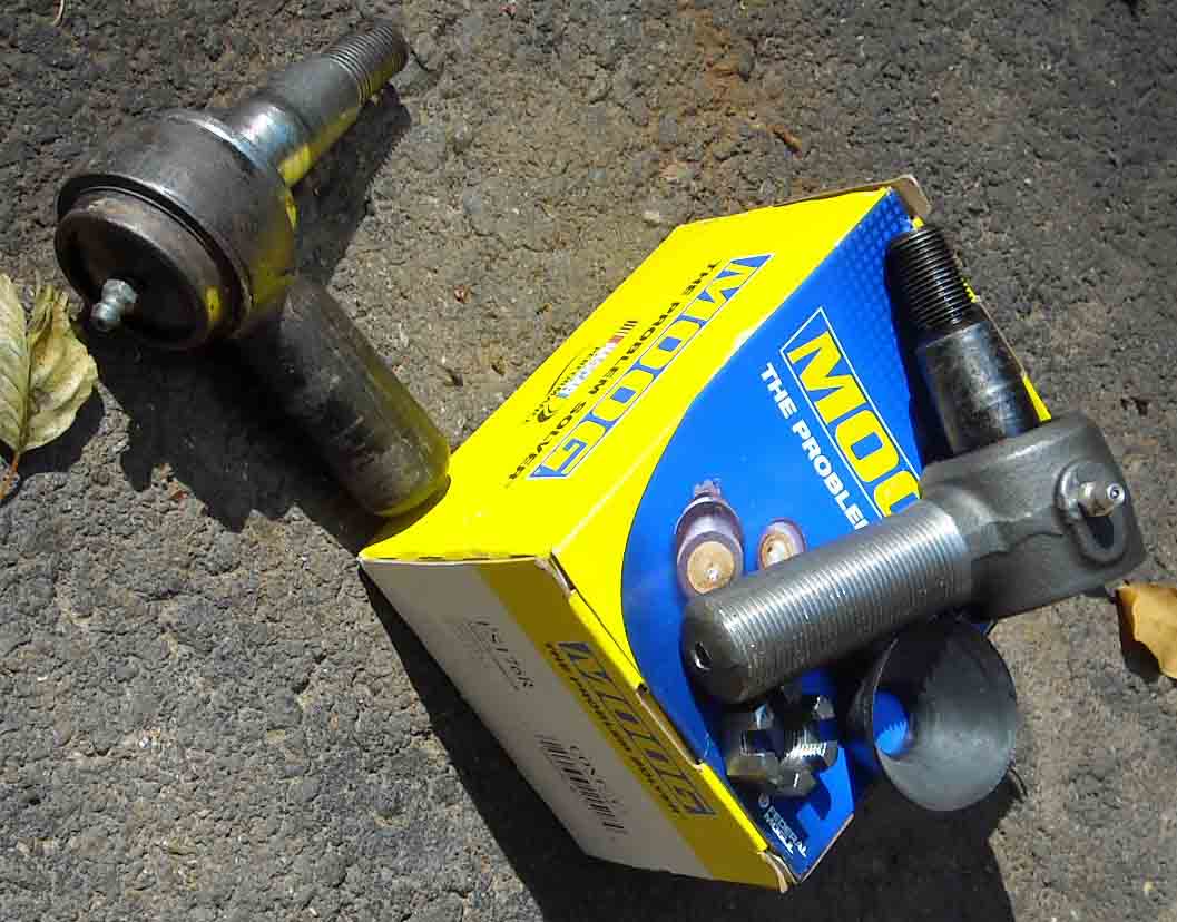

Well, I spent an hour at the local NAPA poring over steering parts
catalogs, and I found a size chart in a Spicer book for large trucks.
So, the taper I need can be found in a 401-1011 tie rod end, but it
has a male connector, and a 1" OD thread. No females are
available in the taper I need.
I ordered it as a Moog part # ES176R, which arrived the next day.
I bought it from NAPA, since they helped me, but I paid a fortune: $80.
Resourceful folks may find a better price from an online auto parts
dealer for Moog. Moog is a huge vendor, owned by Federal Mogul, as
is TRW.
Anyway, here is the part. It comes with an untapped grease hole on the
side, so I tapped it 1/4-28 and installed the zerk. I first put a small
synthetic rag inside before tapping, so I could remove all the metal
fragments from the tapping.
The material is a soft machineable cast steel, so I plan to drill and tap
a 1/2-20 hole for the other end of the steering control. In this photo,
you can see I have already drilled a smaller hole 1.5" deep into the end.
I use cobalt drills, as I will for the 29/64 bit required before tapping.
   / John Deere 4300 complete rebuild #513
Nice find, dfkrug!
Its $44.29 with free shipping at Amazon. But I commend you for buying it at NAPA after the effort they put into helping you. I would have done the same.

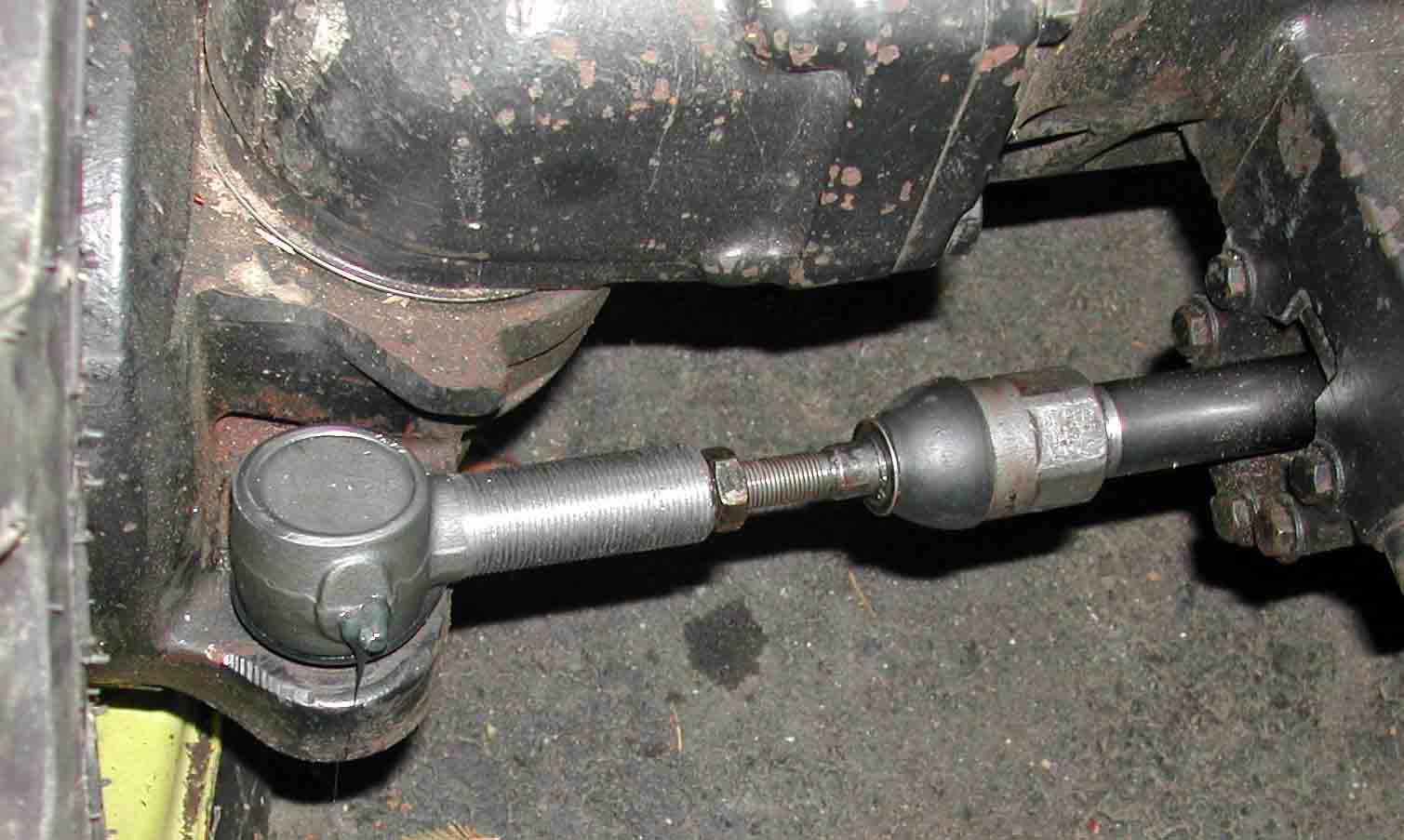

The taper is everything, and tapers are specced as min diam, max diam,
and length of taper.
The cast steel is quite soft, as I said, and I have now got it drilled to
29/64, tapped 1.5" deep, and installed.
Pix and a test drive to follow when the light is better.

And here is the finished installed tie rod end. It works great. The
tractor drives much better.
Note that the old style MFWD does not have a tie rod that connects
the left and right hubs together. Each end of the 2-sided cylinder
uses identical parts (both right hand thread) and only one side needs
to be adjusted to get the correct toe-in alignment. That means that I
could have just welded up one side and used the other side for all the
adjustment. Something to think about in the next repair of this kind
of linkage.

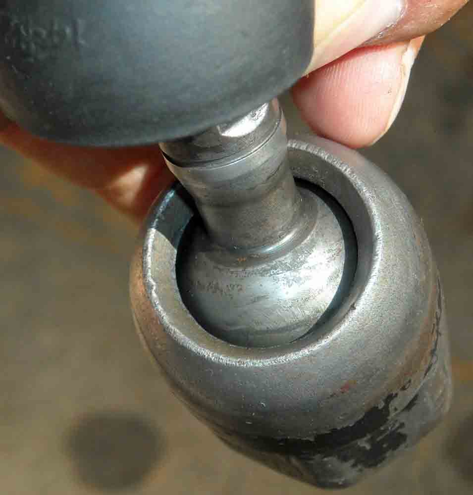

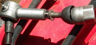

Here is a couple more pix of my tie rod end.
The ball joint that connects to the cylinder rod is covered with a rubber
boot, held on by a washer and a snap ring. On this one, the ball is in
good shape, but socket has some end play. I have decided not to replace
it. Note that greasing it is a manual effort that requires one to remove
the snap ring and pull back the boot. Does anyone do that? It sure is
not designed to last.
