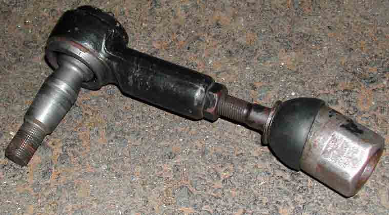

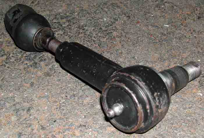

I have been using the tractor on a trailbalzing project along my creek, and
mostly it works well. This is what I call "burn-in". One of the steering tie
rod ends is a little too sloppy for my taste, however.

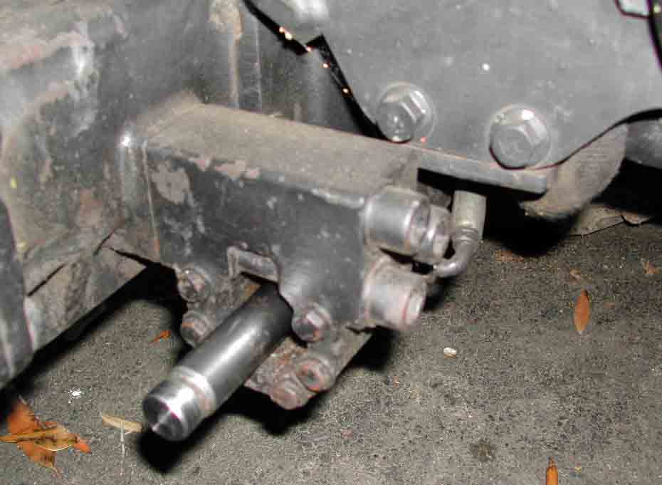

Since I have the "early MFWD axle", my tie rod ends are a little different,
and super-expensive. I was quoted $160 for the whole part in these
photos, which includes the tie rod end and another ball joint for the cylinder
rod. There is only one part # for the assembly in my parts book, but JD
Parts breaks it into 2 part #s. The tie rod is only $144.
It turns out he tie rod end is a TRW part with SAE threads (1/2-20)...I am
going to look for a substitution. The best bet may be a GM part.

Have you tallied up total cost and hours invested in this project?
   / John Deere 4300 complete rebuild #508
Please post up if you find a cross. Mine are worn at the balljoint such that I can watch them twitch while driving across my property.
#509
Yours is the early MFWD, right JP? The one with a double-ended PS cyl?
The assembly has 2 ball joints, one at the end and one that attaches to the
cyl rod end. I am curious if the ball joint at the cyl rod end is loose on
your machine. This joint on both sides or my tractor will move in and out
about 3/16", but the ball is not visibly worn. I wonder if that is normal.
My left tie rod end ball is horribly worn, due to a ripped up boot. The right
side is OK.
FT, I am certainly not tallying my time on this project, and my guestimate of
parts cost is about $3000 and $500 for paid labor (not mine).
   / John Deere 4300 complete rebuild #510
Yeah, I have the early version.
It looks like the ball end is worn as I can see quite a bit of movement from the seat.
But if yours have that play without being worn, then maybe this is typical?
