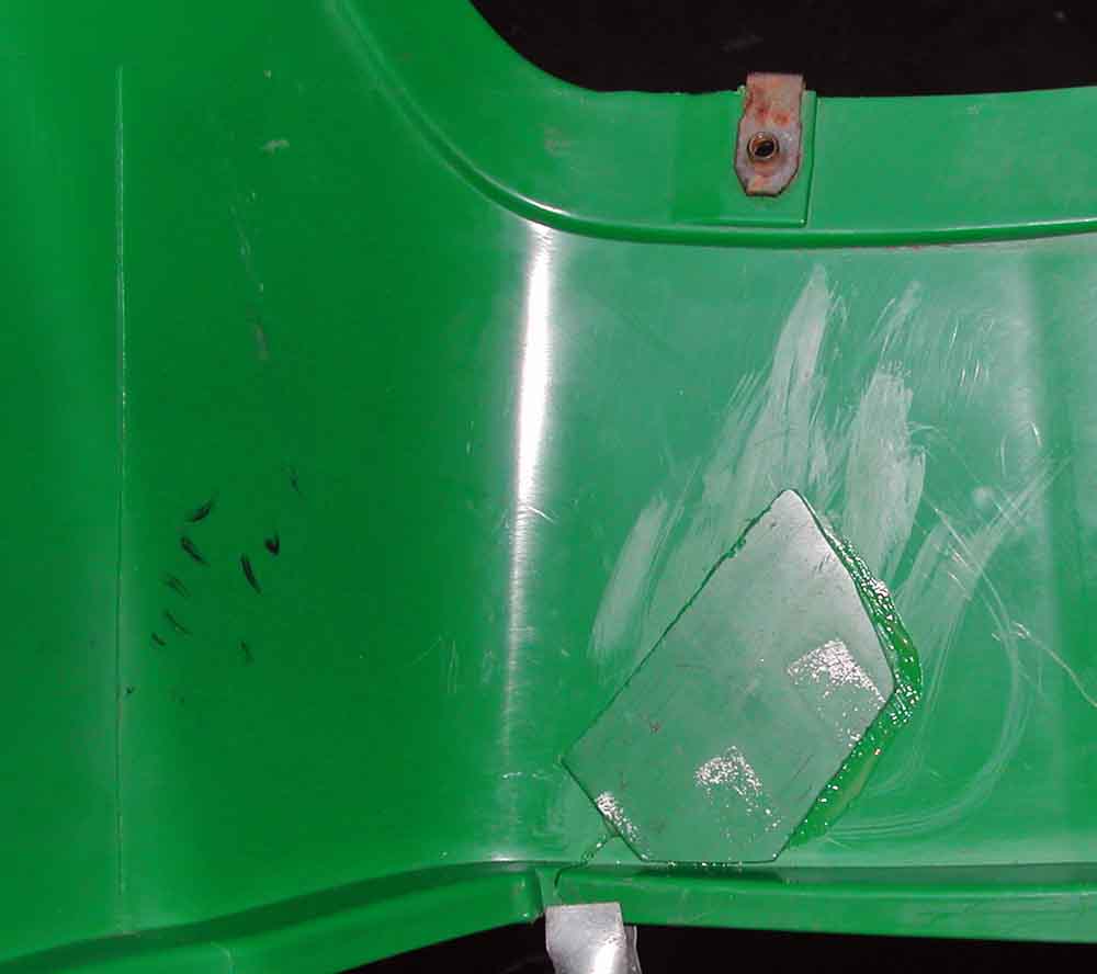

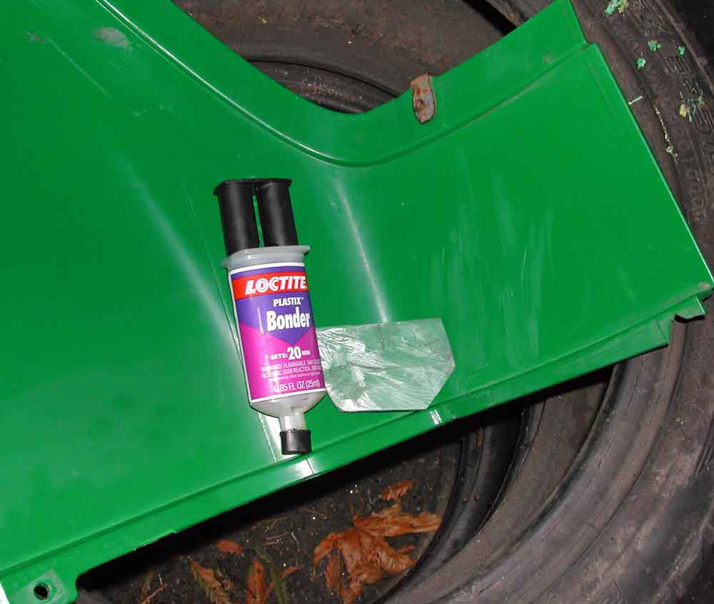

I wanted to include the results of an experiment I did with mending
broken Deere green resin body panels.
I don't know what the chemistry of these panels is, but they break
easily, and I believe they get more brittle with age. Probably ozone
and/or UV radiation degrades this plastic.
The pix are of a cowl panel from this tractor. I bought one new cowl
for this tractor, but at $200, others may hesitate. In the first photo,
you can see the crack I am about to repair. I used a chunk of plastic
cut from a broken hood I have, sanded and cleaned with acetone.
The Loctite Plastix Bonder is a 2-part epoxy that worked quite well.
It is very stinky, but it seems to dissolve the plastic before hardening.
The mended crack is still quite visible, but now it is stable.

Nice repair, but once plastic is damaged and cracks - it will typically continue to crack in other places.
That's why I don't like plastic parts for outdoor equipment.
   / John Deere 4300 complete rebuild
#546
Like anything else, there are pros and cons. I prefer steel fenders and
hoods, too, but I can see why others like how the plastic parts are
impervious to rust.
Note that JD's hood, cowl, and side panel plastic is thin (1/8") and
vulnerable, but the rear fenders are much thicker and more durable.
