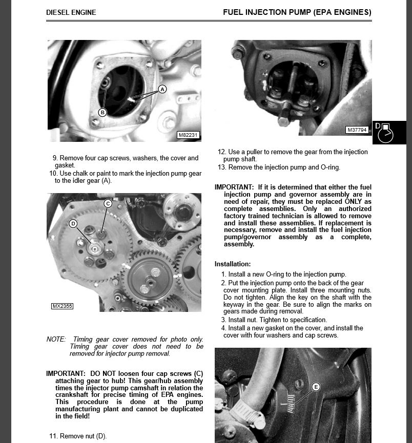

More on taking apart and analyzing my engine:
My first photo is the insides of the front gear case. If you look closely, you
can see white hash marks highlighting the index marks on the gears. These
must be lined up for proper valve and FI timing. The crank has to be rotated
many times before these marks line up since some of the gears have an odd
number of teeth. Correctly assembled, you don't have to adjust the FI timing.

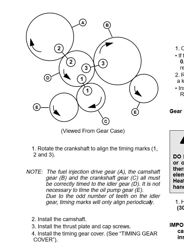

Can you verify the timing marks are like they were when you tore the engine down with the crank and idler gear marks matching the groove/tooth? The deere manual shows the marks lining up when viewed from the front which would but them a tooth of of where that picture shows, but I believe my engine was like yours when I tore it down and that's how I assembled it.
There is really no ambiguity to the alignment of the marks. Both the manual photo and mine
show one set of marks that look off only because the gears are beveled and the shaft is
not fully inserted. I checked my photo archive and I do not have better closeups.
Here are pages from the manual:
   / John Deere 4300 complete rebuild #576
I agree that your photo and the one from the manual look to be the same, but I don't agree that any shaft is not fully inserted in those pictures. Both the manual and your picture look like an installed, running, timing set and look like what I remember mine looking like when taking it apart. The crank gear is just longer than the rest so it turns as it slides down on the idler during installation, making the mark not look like the diagram from page 3-52 once installed.
The ambiguity comes from looking at yours, mine, or the pictures timing set straight on, versus the diagram. If the idler gear were advanced 1-tooth from the crank gear, the marks look just like the diagram on page 3-52 and contradict the pictures, including the picture on page 3-65. That is how I started to assemble it before I checked my notes.
I think the diagram in the manual on page 3-52 is wrong, which wouldn't be the first error I've found in the manual. I'm just glad I didn't put it together like the diagram shows to.
#577
You may be right. In editing the photo I posted, somehow I lost the original to do a different
crop and blow-up to show it better.
Regardless, anyone doing this repair should align the marks and photograph them before
any disassembly of the gears. "Film" is cheap.
I am a big fan of manuals, too, tho errors are common. The JD factory manuals are pretty
good, among the competition.
