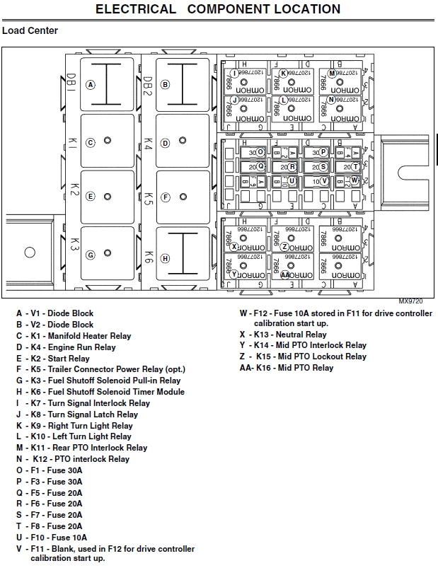

Lighting Issue: All lights work properly except for the Flashers/Signals. The Signal Lever turns them on, but they are opposite of what the manual says they should be: Pushing away lights left, and pulling towards you lights right. The Flasher/Signal lights also do not turn on when the light knob is in the Flasher position.

On the lights pull the bulbs and make sure the contacts are clean. Verify the base is grounded good. Also look in the fuse panel and make sure all the flashers are there. Seems like mine had a similar problem and one of the flashers was missing.
Thanks for the advice. I checked the fuse panel and I am missing a 20A fuse in F9 which is labeled Marker Lights, I am assuming that is what they call the flashers. I swapped out the 20A F6 Headlight fuse to test in the open slot and I noticed that the F9 slot isn't tight enough to hold the fuse in. I am guessing the last one just vibrated out. I am going to inspect further in the daylight to see why the slot is loose.
After looking at the fuse panel and diagram I have a new question:
F2 & K5 - Trailer Option Fuse and Relay - What does the Trailer Option do? Is it already wired and just not being used?

When messing around in the fuse panel be very careful not to put a fuse in the #12 spot. This puts the transmission in calibration mode and will disable the tractor. The calibration to get it back going can be done without special tools but it is a lengthy process.
I haven't located a trailer harness so I assume it is not there or easily accessible. I don't know what trailer specific functions it provides.
You should have relays in K & L for turn signals. In fact all 6 of the small relay slots above the fuses should be occupied.
Slot 9 has no contacts in it so a fuse will NOT do anything there. My panel also lists a 20A fuse in 8 & 9 for marker lights but a fuse will not stick into 9. Also the manual has no listing for the 9 fuse slot so I assume the tractor legend is incorrect.
Dang, I thought I had an easy fix with a missing F9 fuse. With the turn signal lever working the opposite side that it is suppose to, I am wondering if it is something as easy as a switched connection. Was thinking about pulling off the instrument panel to see if they can be switched. While operating the hand throttle, I noticed what looked like the remnants of a mouse nest in the throttle slot, so probably pull it apart just to clean it out and check for any damage the little ******* may have done.

Are all your relay slots occupied?
All of my relay slots are occupied except for the Trailer and Mid-PTO slots, which I do not have. Agreed that it would be nice to have everything working, but functional is much more important. Both my signals turn on constant when I move the lever. I would just like to have the flashers working so I can have them on when plowing or grading the end of the driveway. Do you know which fuses and relays are responsible for the flashers? I am thinking it would be the K7 - Turn Signal Interlock Relay. I had someone suggest switching the I and J relays with the K and L relays. What do you think? Didn't know if swapping relays could do any potential damage, like the F12 Fuse slot.

That was also me that suggested switching the relays. The relays are the same part number. I thought if you switch them it might do something different if one of the relays was bad.
