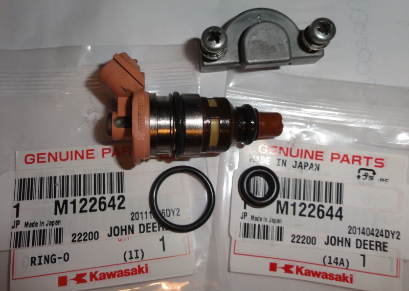

Don't know what else would cause a flooding condition and then clean up.
If you get into the injector body they sell a throttle body kit. Orings and stuff in case anything is loose...
I took mine all apart and cleaned everything. If you do this you will learn how it works.
The injector has 2 o-rings and the inside is smaller/fat .
IF this beefy o-ring leaks, it could let raw gas into the throttle during that 2-second pressurization.
I ordered & replaced both of those small o-rings on mine.
It can also let gas seep into the throttle after the engine is shut off. (It would be like a leaky injector)
Also I would suggest you replace all of the small hoses & clamps before you start buying expensive sensors.
You can check the resistance in the MAP sensor if you have a good multimeter.

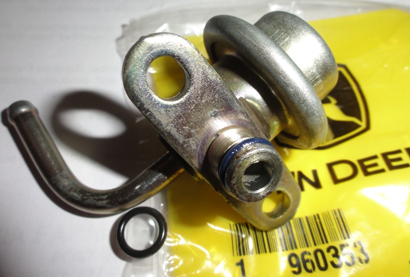

Next to check the fuel pump hose piece in the tank I guess.
Any ideas would be helpful. Does a fuel pressure regulator ever stick closed and deliver too much pressure?
My bet is on that hose... The pressure regulator looks like this.
Click to enlarge.
If you want to check several items at once, get a pressure gauge setup between the tank and the throttle body.
It should build up pressure in those 2 seconds and hold it.
The regulator must have some sort of spring inside and you could take it off and clean it good inside.
I cleaned mine and ordered a new o-ring after taking it off. See photo.
Another thing I done was to remove the return hose at the fuel pump and then turn the switch on.
This little fuel pump is tiny; don't expect much fuel to flow back as the regulator releases the pressure.
What you are calling flooding may be fuel not really fanned out from a improper spray from the injector.
And that hose can cause it to happen.
