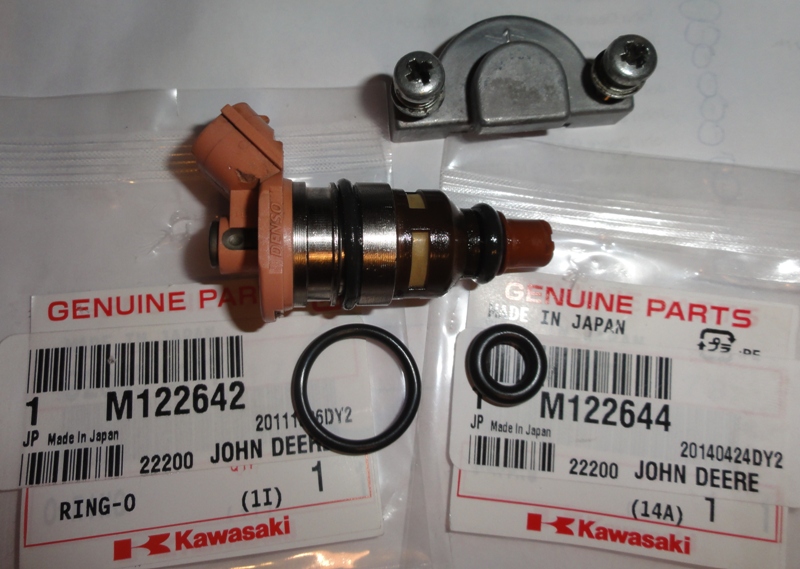

If you get into the injector body they sell a throttle body kit. Orings and stuff in case anything is loose...
I took mine all apart and cleaned everything. If you do this you will learn how it works.
The injector has 2 o-rings and the inside is smaller/fat .
IF this beefy o-ring leaks, it could let raw gas into the throttle during that 2-second pressurization.
I ordered & replaced both of those small o-rings on mine.
It can also let gas seep into the throttle after the engine is shut off. (It would be like a leaky injector)

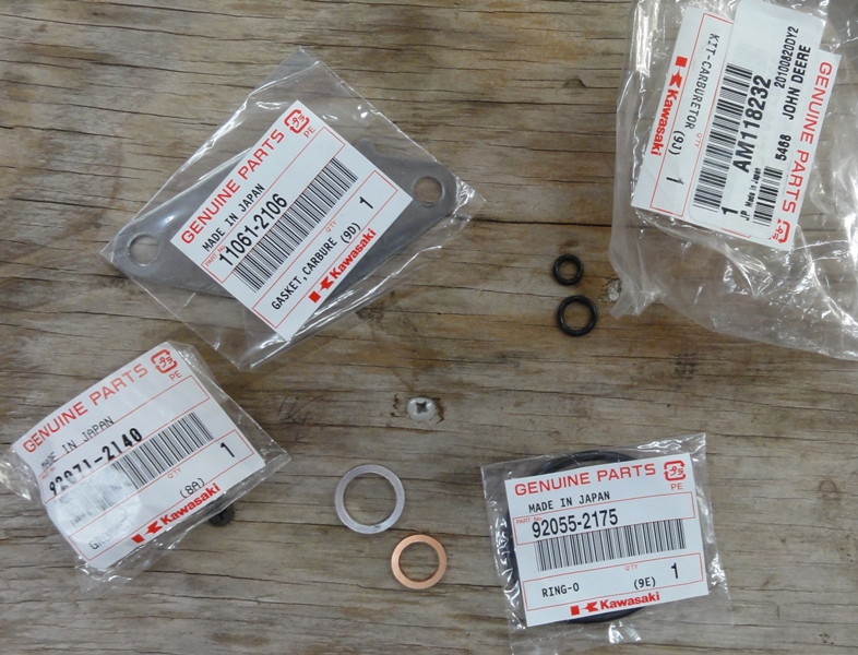

Thanks BBO. I'm starting to think you may be on to something. It does act like a leaky injector. What is the throttle body kit that you speak of? I see I can order the orings, but what else is in the kit?
   / John Deere 445 stumbles on cold start #24
JD # AM118232 Kit. It was about $32 in 2010
But... This does not include the o-rings for the fuel injector. The kit has a few o-rings mainly related to air flow vs. fuel.
It does have the main throttle gasket and gaskets for the water temp sensor and that grommet that the air temp sensor pops into.
