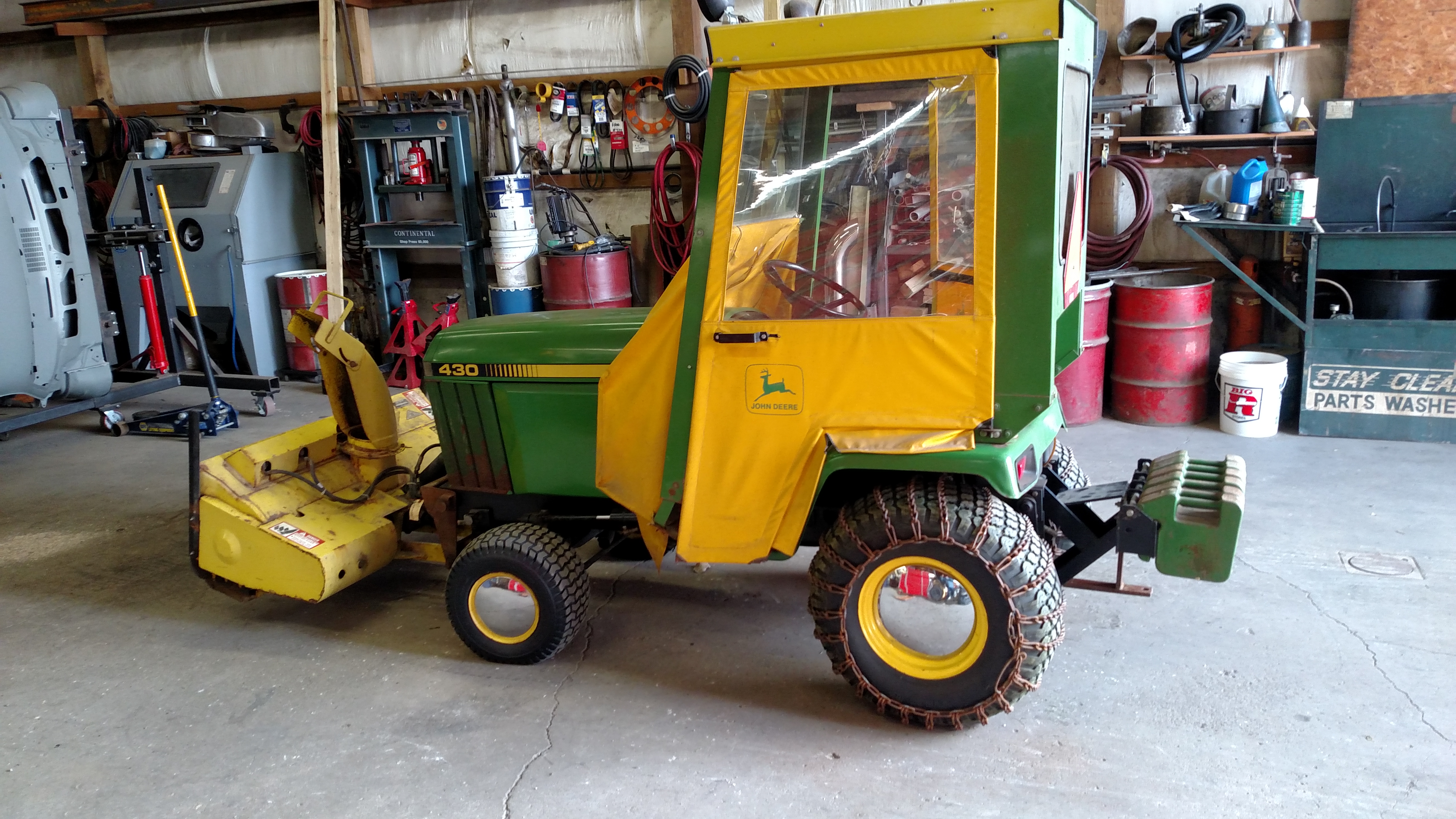

If you're 455 has deck fender pan handle grips or the in fender tool box, I would say NO, those will interfere. The 400 cab has a very straight line for fit on the sides and back, the 455 has a slight curve, so if you try it, you may have to work on the lower edge sealing against the seat pan and the foot rest.
Oh forgot about the location of the fuel inlet also is in different spot.

Here is a picture of my 430 with the cab on it.
See that looks like it would fit the 455. but anyway, another issue i have been having now that it is getting cold is it doesnt want to start. it will crank for days and puffs white/gray smoke till it fires then the usuall plume of black smoke. runs fine after that and antifreeze isnt low. Any ideas? have seafoam in it to clean the injectors but havent run it all through yet if thats it.
