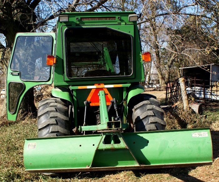

OK, I found the original John Deere 45 blade that was sold with this tractor. I had to get it.... even if it meant driving 6 hours today. It is in good shape, needs to be repainted on the blade. The original serial number and stickers are on it. It is 7 ft. long, weighs over 350 pounds. You can either push snow or pull snow...
I called several places and it will be several weeks before they can get the Land Pride blade in. We will see how the original blade does since we couldn't get anything until after we will probably have snow.
So, for now we have the blade issue resolved.
Thanks to everyone for your patience.
   / John Deere 4600 rear blade and weights #17
Post a pcture of that bad boy blade.:thumbsup:
#18
I will gladly get you a picture. I got busy today moving things before the snow blows and had forgotten the camera.
I paid $400 bucks for it and have no regrets of driving that far to get it. It turns all the way around, so we can push snow or pull snow. A six ft blade would have been to small and a 5 ft would have been way to small .... the way Dad has it set. VERY HAPPY I CHECKED with you guys on size.

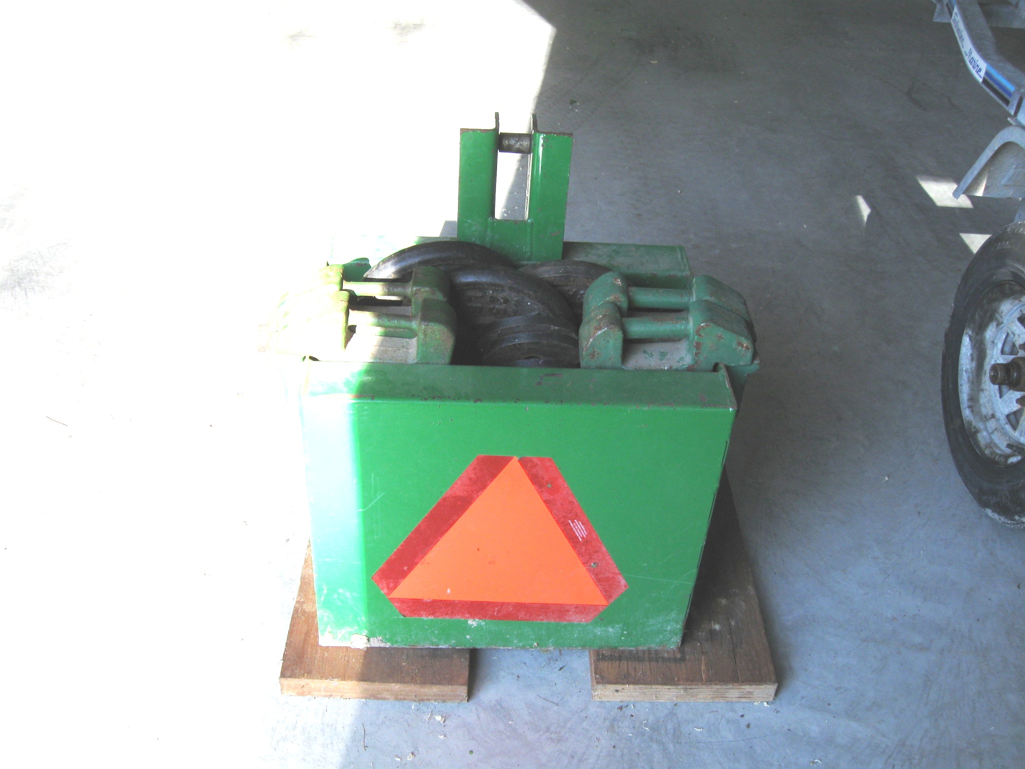

Anne; I use a weight box filled with old lifting weights and a couple of JD weights on top. Makes it relatively easy to change the amount of weight you carry.

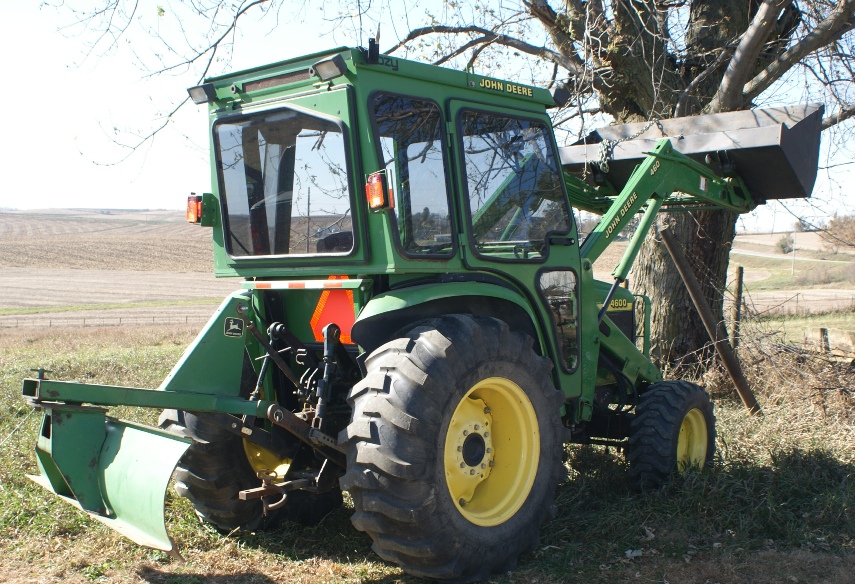

Yep, looks like West Central Iowa alright!!! ;)
I can't tell in the pictures if this is an option, but the rear tires can be set out and help a LOT with stability.
I understand your Dad's hesitation about fluid in the rears also. I grew up with calcium chloride used for ballast. Also dealt with rusted rims because of the corrosive value of the fluid. Today there are several options, the best being Rim Guard, totally non corrosive and can be used with tubeless tires. Next best is anti-freeze or windshield washer solutions. Again, won't rust the rims. If your Dad uses his loader to it's capacity his blade isn't going to help much for ballast. Really need fluid or wheel weights, which are hard to find without paying an arm and a leg.
