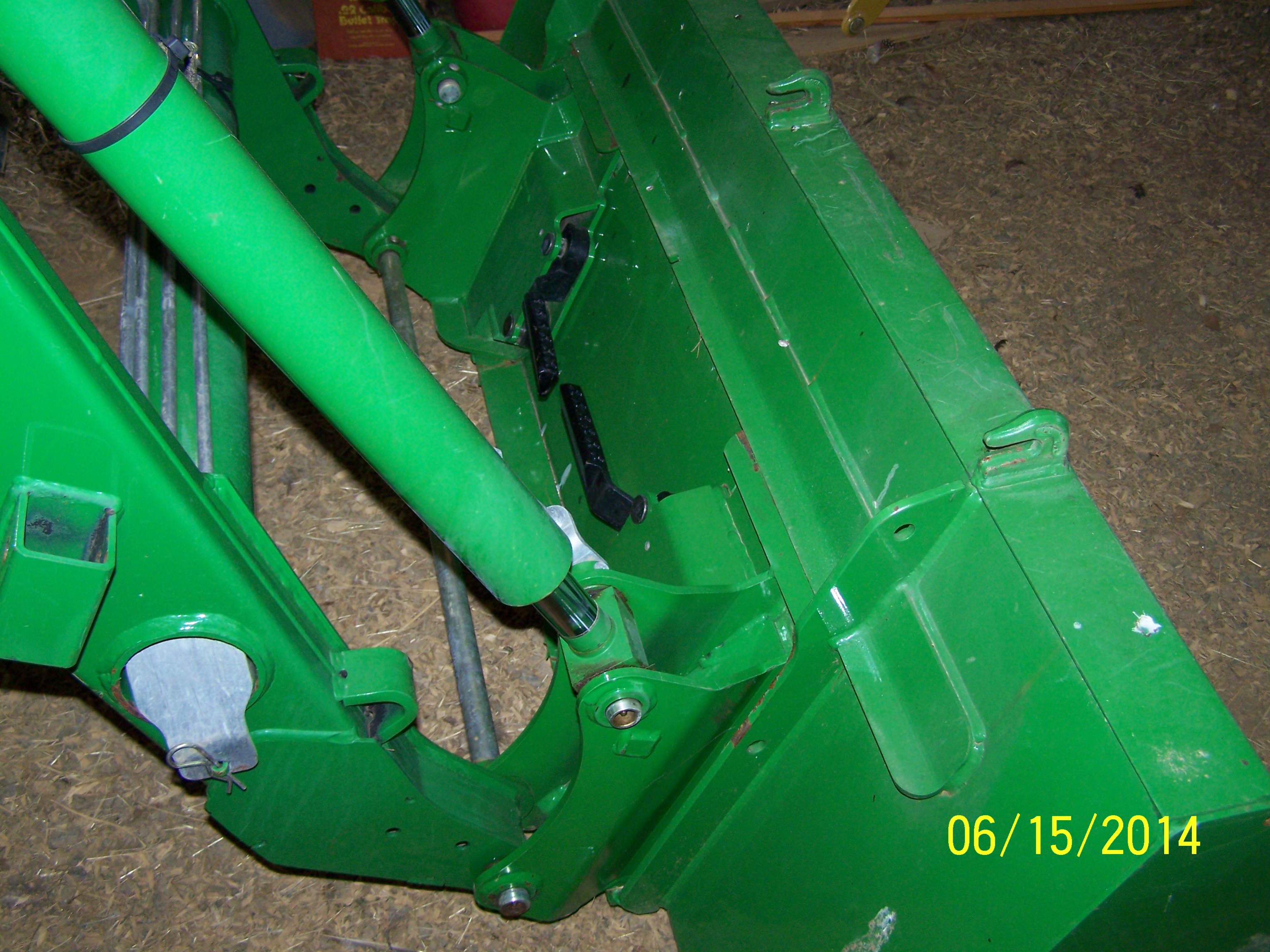

I'm in the market for a new John Deere 5065e with multiple attachments including loader with 4in1 bucket, palletforks, grooming mower, leaf blower, rear blade, landscape rake etc. Does anyone have suggestions or recommendations on this purchase.

Are you getting the loader with SSQA, or are you using the JD system?
I went with SSQA because I already had forks, and other buckets set up that way. There is nothing wrong with the JD system, but SSQA is more common, if you wish to borrow equipment.
My 5055 came with a class 2 hitch. I think JD offers cross drilled balls for class 1 and 2, so you don't need to use bushings all the time.
I installed cross drilled balls on my standard arms, because I found the bushings a pain.
I assume the dealer will suggest a cold weather air preheater, if their not standard equipment now.
