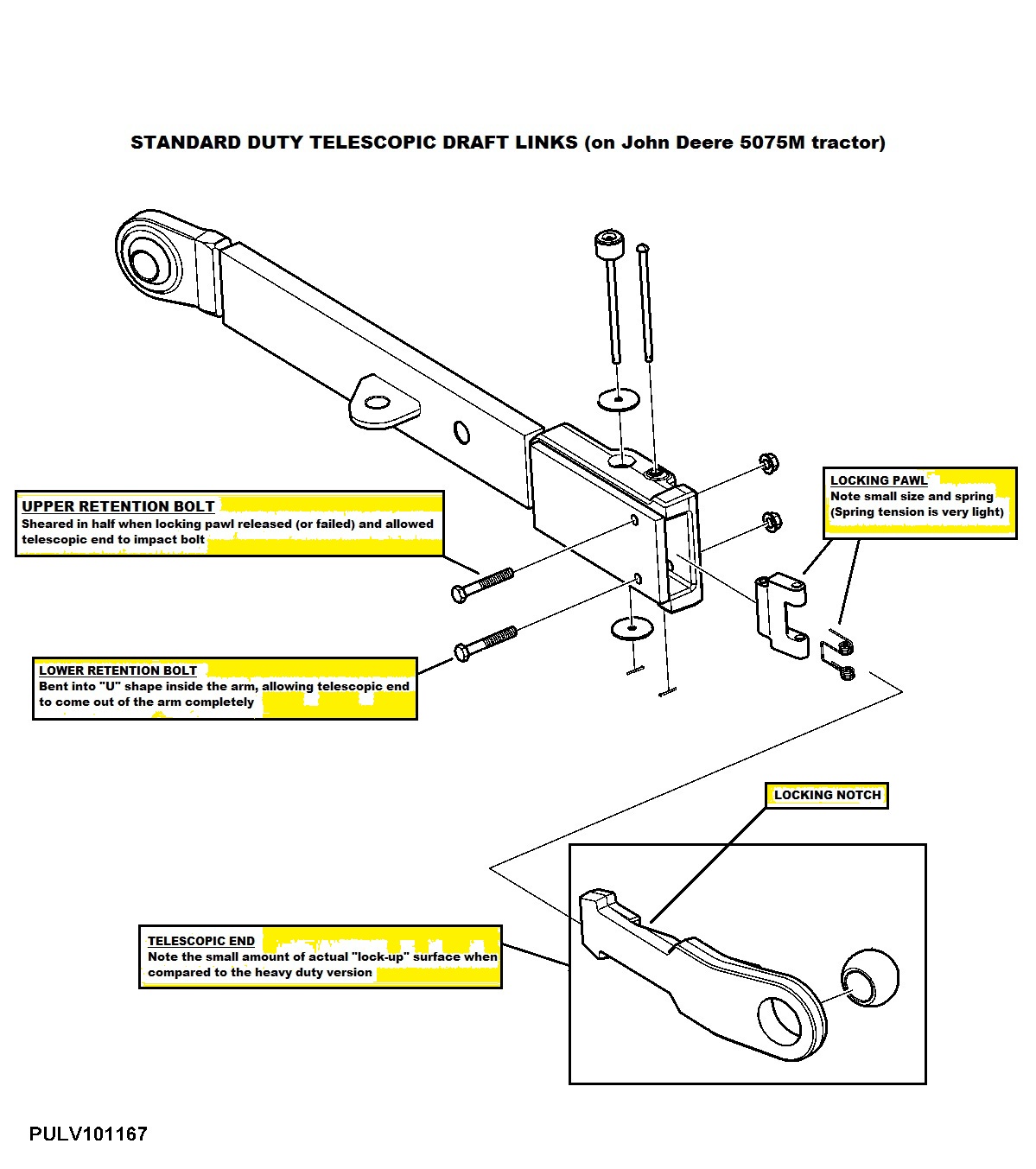

Hello All,
We recently purchased a brand new Deere 5075M 4wd with Cab. Additionally we bought a Kuhn GMD600GII HD rotary mower to use with this tractor. Our tractor is equipped with what Deere refers to as the "STANDARD DUTY" 3 pt hitch.
Recently I had a major malfunction and I would like to get other`s input on the situation. Here`s what happened:
I set the mower according to the tractor, and attached it to the tractor as explained in both machines' manuals. I proceeded to begin mowing pastures. Part way through my mowing, as I proceeded to make an up-hill turn on a medium grade, I lifted the mower using the hydraulic and also raised the hitch off the ground so that I could make my turn. As the tractor began to face up the hill, I heard a loud "BANG". When I looked behind me, I noticed that the right side telescopic draft link had been completely pulled from its socket. Upon closer inspection, it appears as though the "pawl" that is used to hold the telescoping arm in place under load had somehow worked itself loose and allowed the arm to extend. When this happened, the two retention bolts, which are used to prevent the arm from coming out of the socket, immediately failed (sheared in half) and allowed the arm to come out of the socket. Thus causing the mower to basically fall off the tractor. When the mower fell, it fell to the right side due to a lack of support, and also caused the top center link to bend at the outer threaded section.
Here is what I know:
1. The mower was properly attached to the tractor and adjusted to meet the size and dimensions of the tractor.
2. The mower is significantly UNDER the max rated weight load of the STANDARD duty hitch on the 5075m
3. The standard duty 3 pt hitch uses a "horizontal sliding pawl" in order to retain the telescopic arms under load. (ALL other Deere tractors we own (6 of them) use a "vertical lift type pawl"
4. The pawls were properly engaged and fully locked at the time I was operating the tractor. I know this is certain for 3 reasons.
A) I visibly inspected them for proper lock-up prior to starting
B) The mower tracked properly when egaged with the ground
C) The telescopic arms did not pop out on slopes.
Im looking for input, and also to see if anyone else has had issues with these new style horizontal pawls. In my mind this is a poor design. Under load, there is a chance these pawls could be compressed (the torsion spring that keeps them under tension is light) and thus allow the arms to pull out. Deere does offer a HEAVY DUTY telescopic arm as an option (Standard on 5105M) These arms use the same style vertical lift pawls that other deere tractors use (I.E. 3020, 4230, 4040, 6420 we operate)
I have contacted my dealer to see what they can do for me. The tractor has under 20 hrs on it. So far, all they can tell me is that they can replace the sheared retention bolts, the bent top link and thats it. They will allow me to purchase the Heavy Duty telescopic arms at their cost ($1200), but wont replace them under Warranty without some input from other users with similar problems. I also contacted Deere`s Customer Contact Center to see if they can help resolve the problem. I find it strange that, for years, Deere has used the "Lift" or "Verticle" type pawls, and now, all of a sudden offer these new ones that slide sideways. I really feel this is a serious design flaw.
Let me know what you all think. (sorry for the long-winded explanation but its difficult to describe my situation in less words)
THANKS! - Matt B.

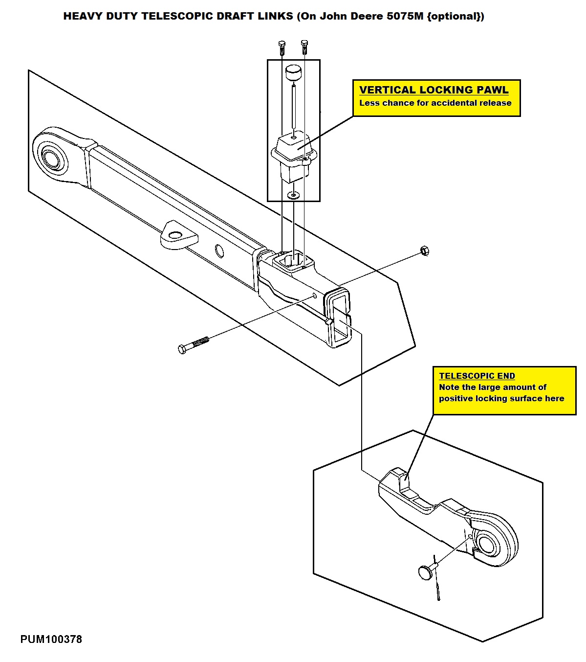

I created these two comparison images using the John Deere Parts program
Take a look at the differences. Of special note is the motion in which the two latch systems release.
The standard duty latches move left and right, a move that could easily be accidently replicated in the field from implement movement or pressure, as well as jar and vibration from field work.
The heavy duty hitch system latches vertically, and in addition, has almost twice the amount of lock-up surface as the standard duty ones.

The diagrams really help explain your link and the heavy duty link. Thanks for posting.
Totally different than my old 2030. I need to look at my new to me 6415, betting it has HD links. What I like about the 2030 is you get a very generous extention and positive lockup.

pclausen,
I stared a little longer at your picture, and have come to the conclusion that your tractor has the STANDARD DUTY hitch system on it. I can tell by the arrangement of the 2 retention bolts that are used to keep the telescopic end from coming out of the arm.
On the standard duty model, 2 bolts are used, placed at the end of the arm and situated in-line vertically at the end of the housing.
The heavy duty model only uses 1 retention bolt.
If you take a close look at the 2 diagrams I posted earlier on this thread, you`ll see what I mean.
I hope they work out well for you, but at least you are aware that they can be an issue BEFORE you take it out in the field for a test run. I learned the hard way :(
