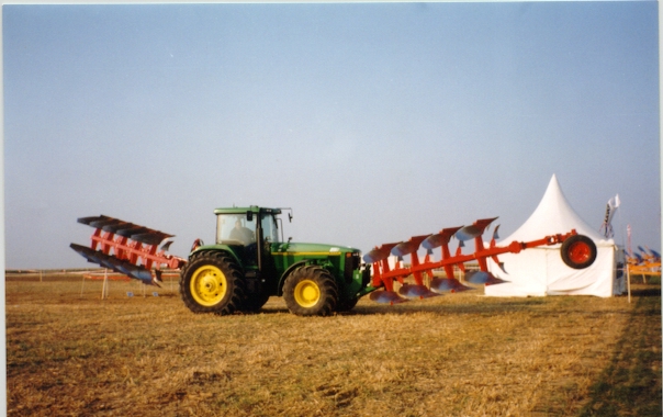

The front hitch is rated for 6600lbs on my tractors and can go up to 8800lbs, yeah they can take a plow.

I have a home built one on my 399 Massey that has an 8 ft snowblower on it now. I also have a heavy duty blade that I snow plowed with before and also have used it as a dozer blade. May try the bushog up front next summer.
