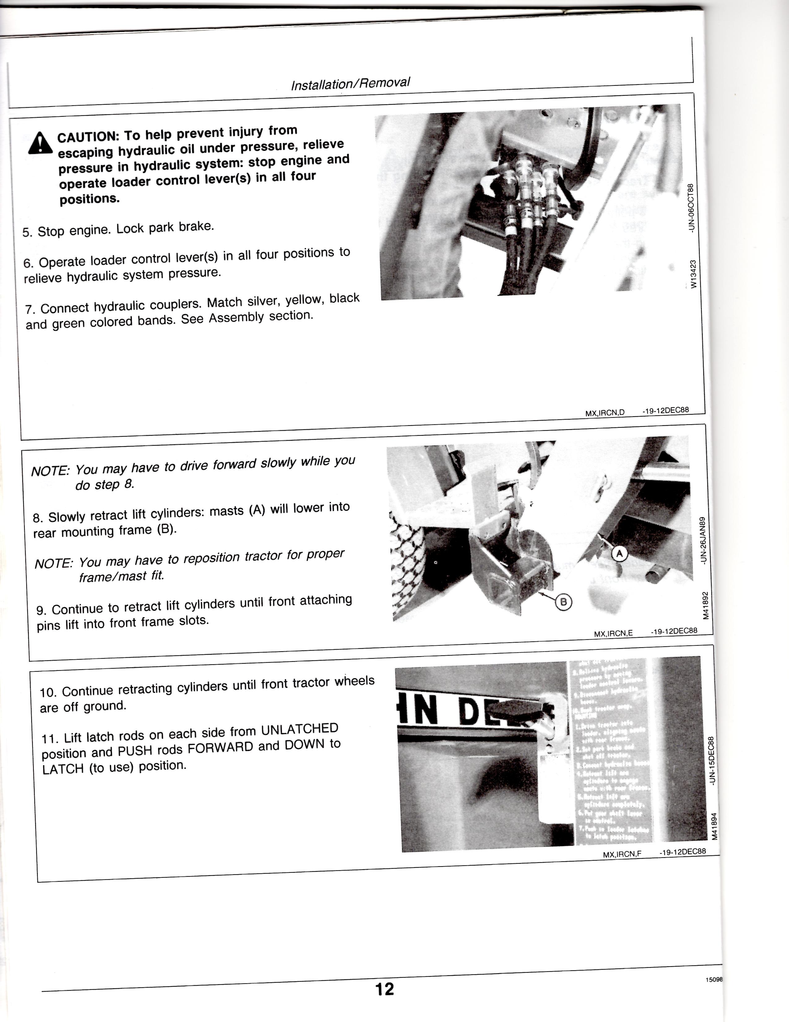

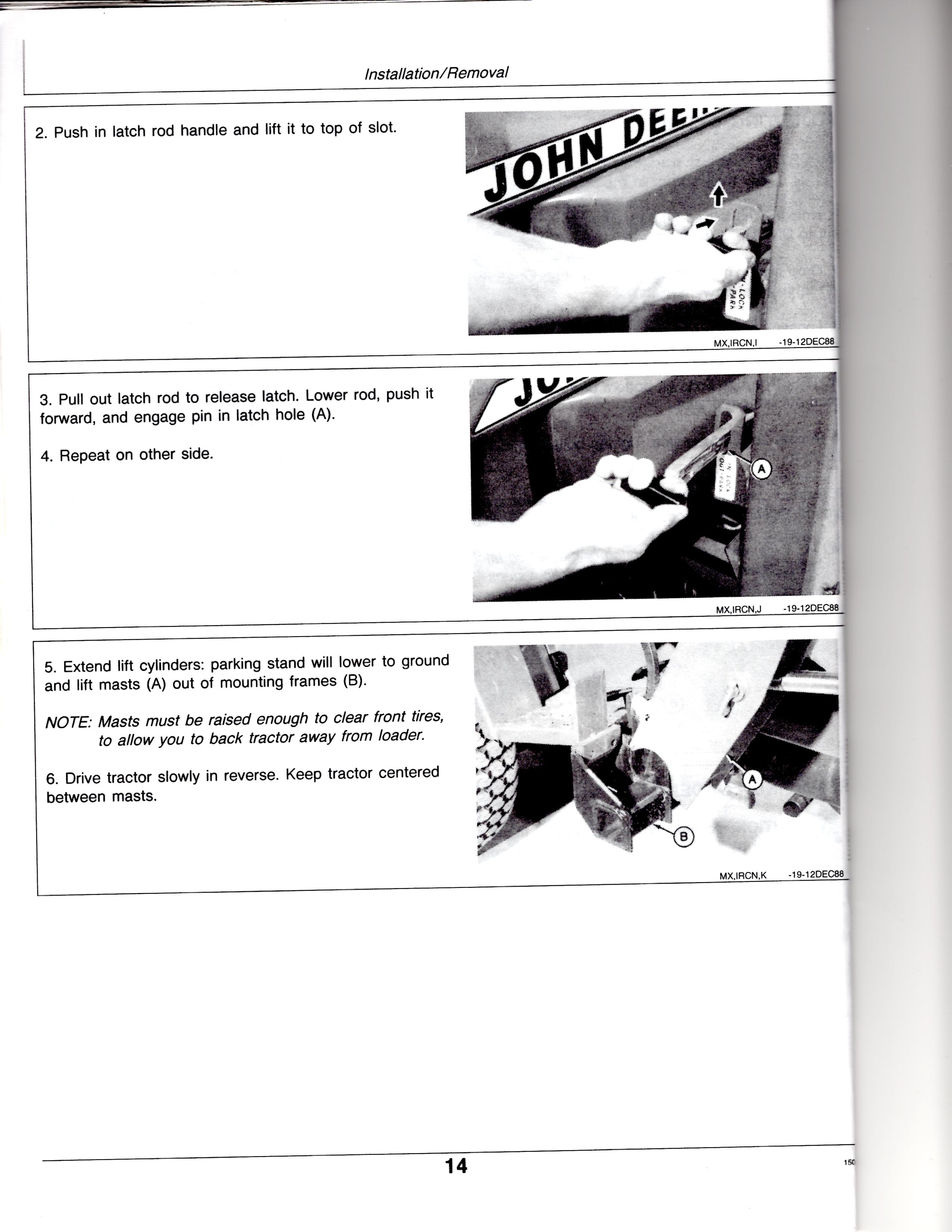

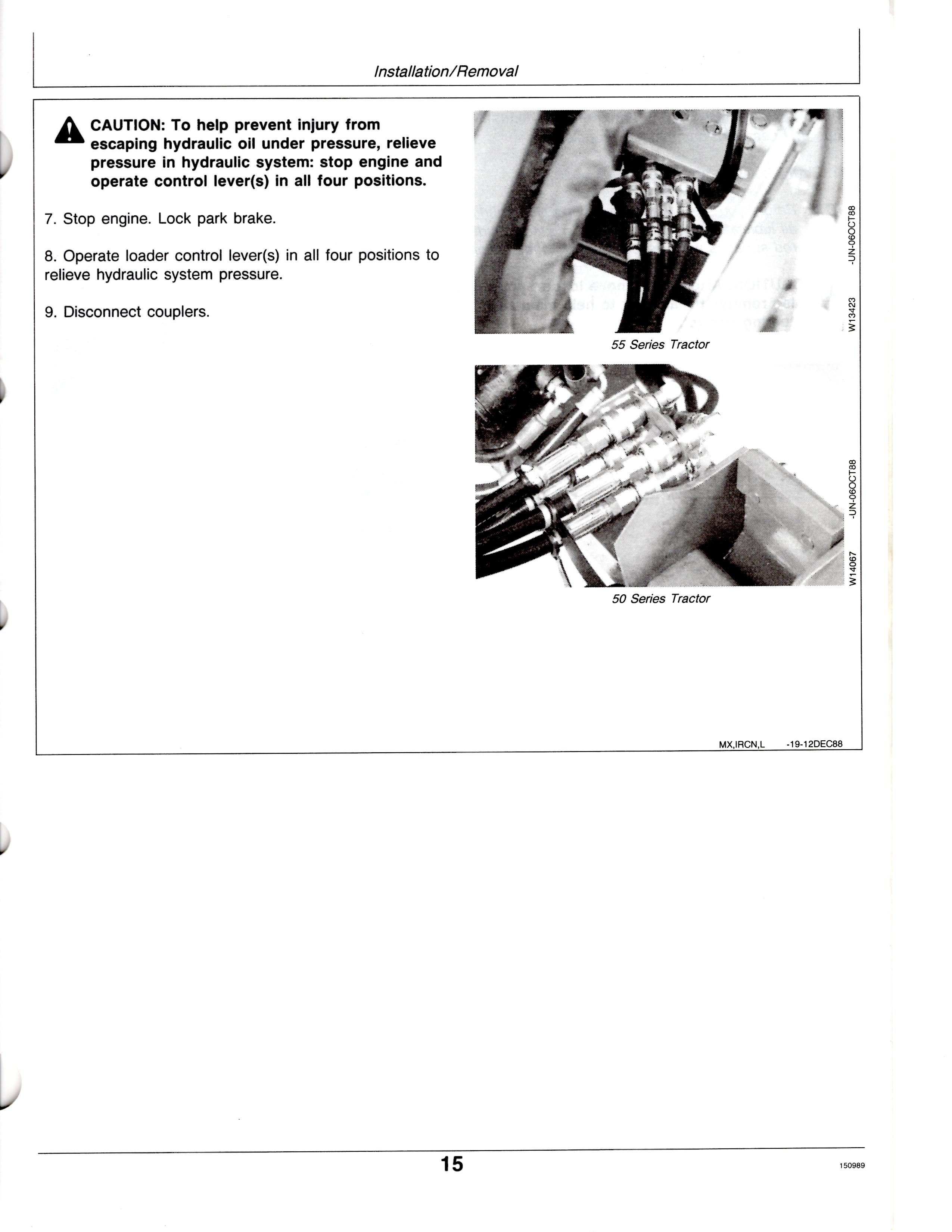

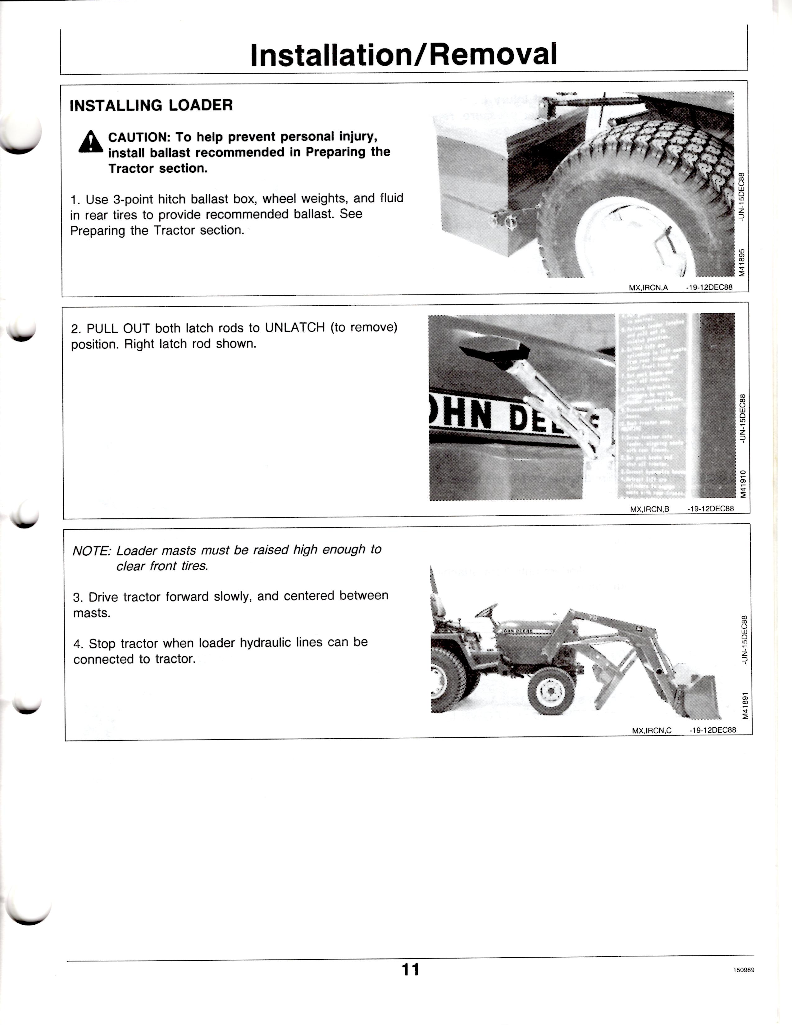

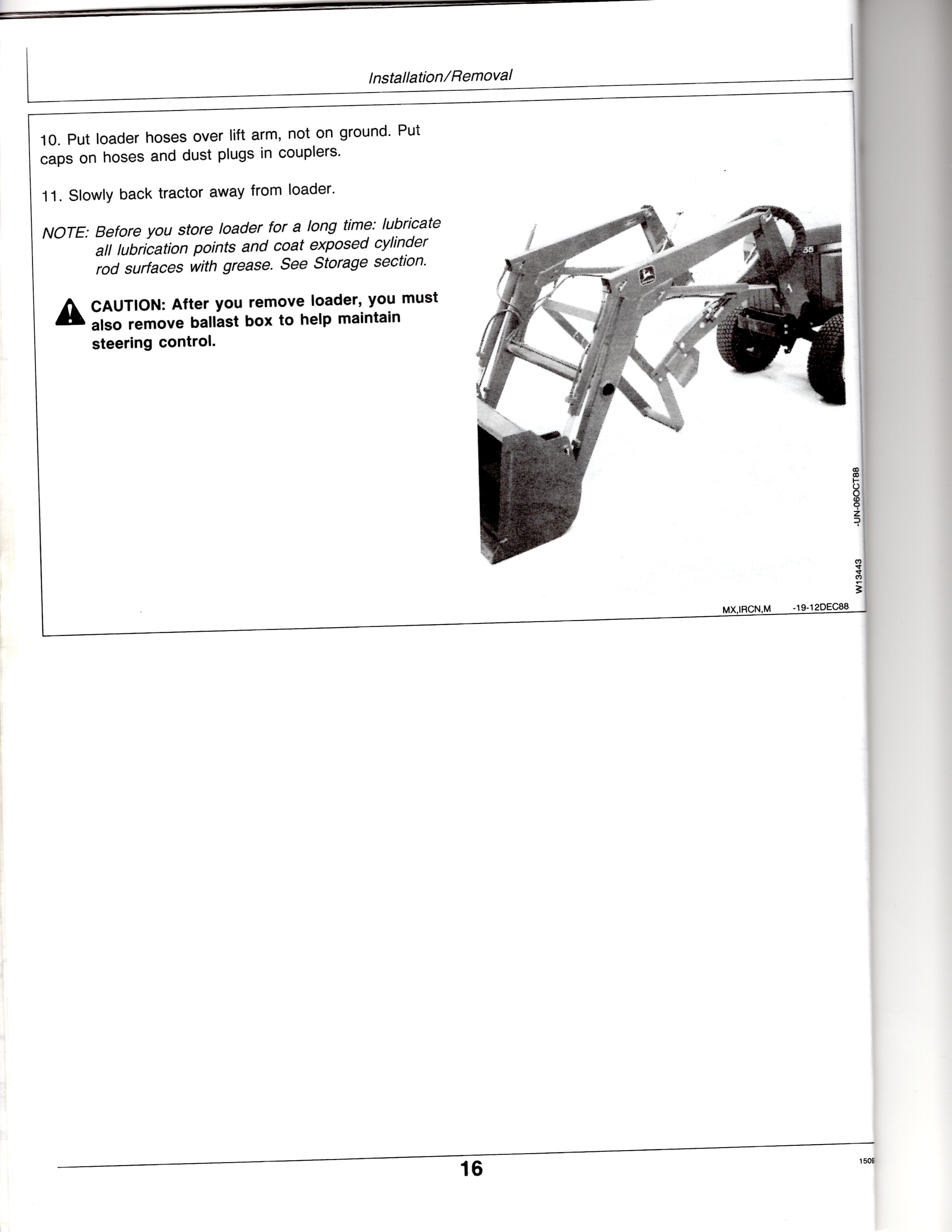

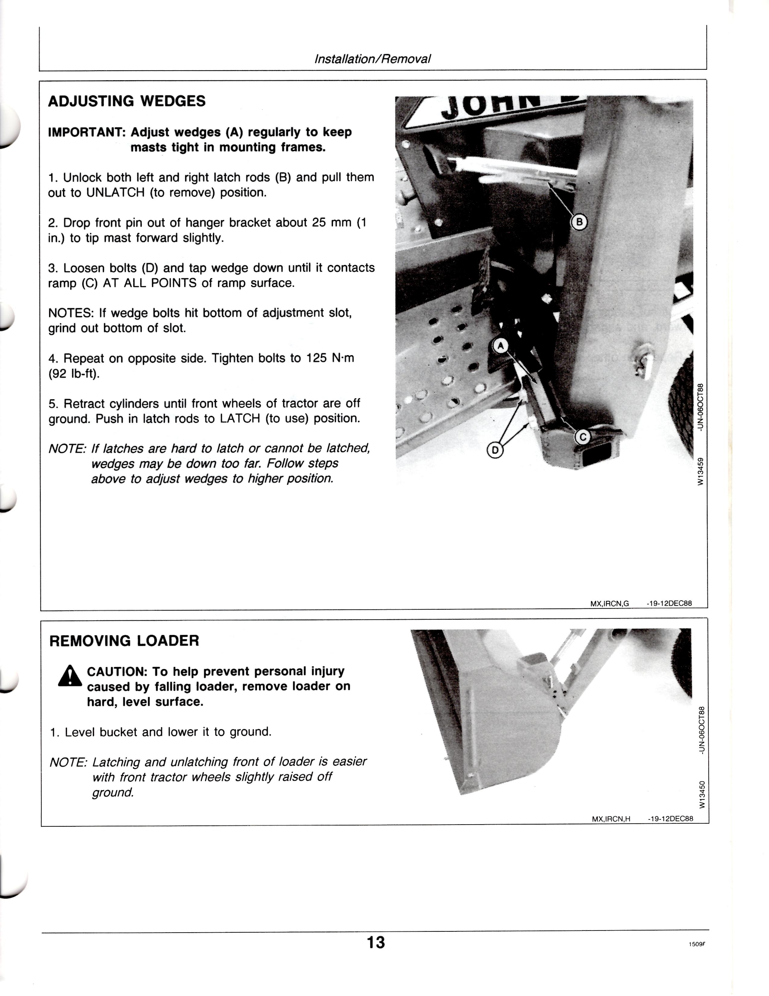

70 Loader instructions attached. Note that you need to use the loader to raise the front tires off the ground when latching/unlatching the loader.
