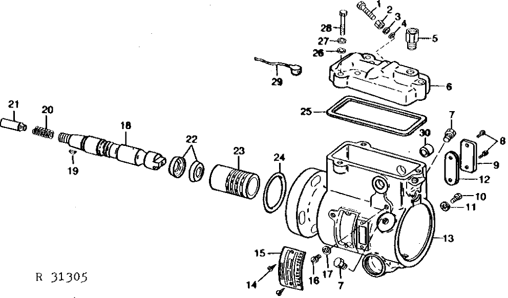

If you're 100% positive that the check valve fitting(parts key 5) isn't plugged then yes inj pump repair is required. As one last attempt to get engine to run before removing IP loosen screws on timing window(parts key 9) and attempt to start engine. Be sure gasket isn't stuck to pump housing. Yes you'll loose a little diesel but IF engine runs a small amount of lost diesel will be nothing compared to $$$$ of pump repair bill.

how do i tell if the check valve is unplugged? I took it off and it does have a lot of stuff in it so i blew it out with compressed air but how do check that it did the trick?
   / John Deere 820 wont run. #30
Some tractor owners/technician have removed glass ball & spring. If you loosen timing cover & gasket and engine runs then you'll know check valve MUST BE PLUGGED. Plugging of check valve indicates fiber drive ring is deteriorated in IP and needs to be replaced to avoid costly inj pump failure or worse scenario connecting rod protruding through side of engine block.
