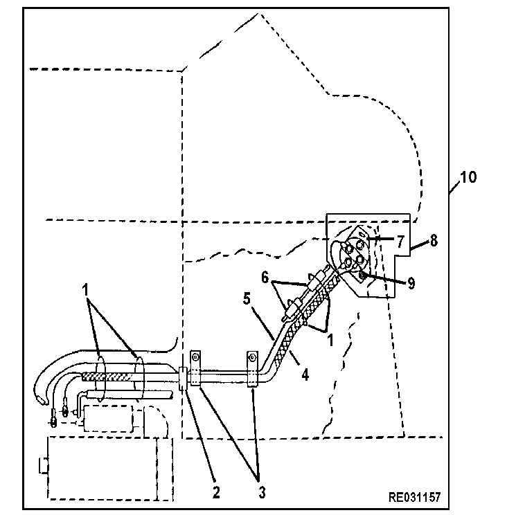

Well tractor is running great. Only problem I have with it now is that it won't start with key. All it does is clicks. Battery is good and starter was just rebuilt. If I jump starter off with screwdriver it will start. I got 12 volts at the starter.
   / John deere 820 #44
Inability to start with key switch but able to jump across solenoid post to start engine is an indication of voltage/amperage drop in either neutral start switch,ign switch,start circuit wiring or one or more of the list. Simple solution is add starter relay that JD installed on later model tractors.
RE42993 STARTER MOTOR KIT

When I jump the starter it didnt start right away. The solinoid clicked bout 4 times befor starter engaged. Starter worked fine before no problems. The shop that rebuilt it said they will check it out since it has a year warranty.
   / John deere 820
#46
Brought starter to repair shop. They tested it and the solinoid is bad. Hope to have it back today or Tom.
