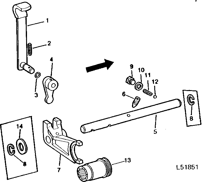

There also seems to be a oil leak where the pto lever goes in rearend. Is there a seal there???
/ John deere 820 #4
Before I spent money on a starter I'd check the fluids to be sure they were at the full mark,change fuel filter and tow start it to check operation of tractor. You will need a good battery as the fuel is controlled by an electric solenoid(pushing key in to activate/pull out to kill engine). Pto lever has an o-ring seal (parts key #3 R28776) but changing it won't be easy.

What is involved with changing the o ring on the pto lever?
Removing 3 pt cover then removing spring pin to get shift lever out of trans case to renew o-ring and reassemble in a very hard to access place. A very difficult task.
