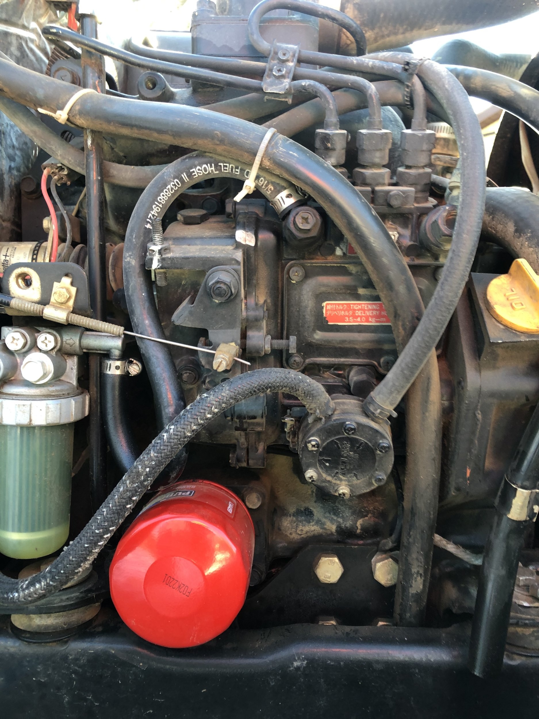

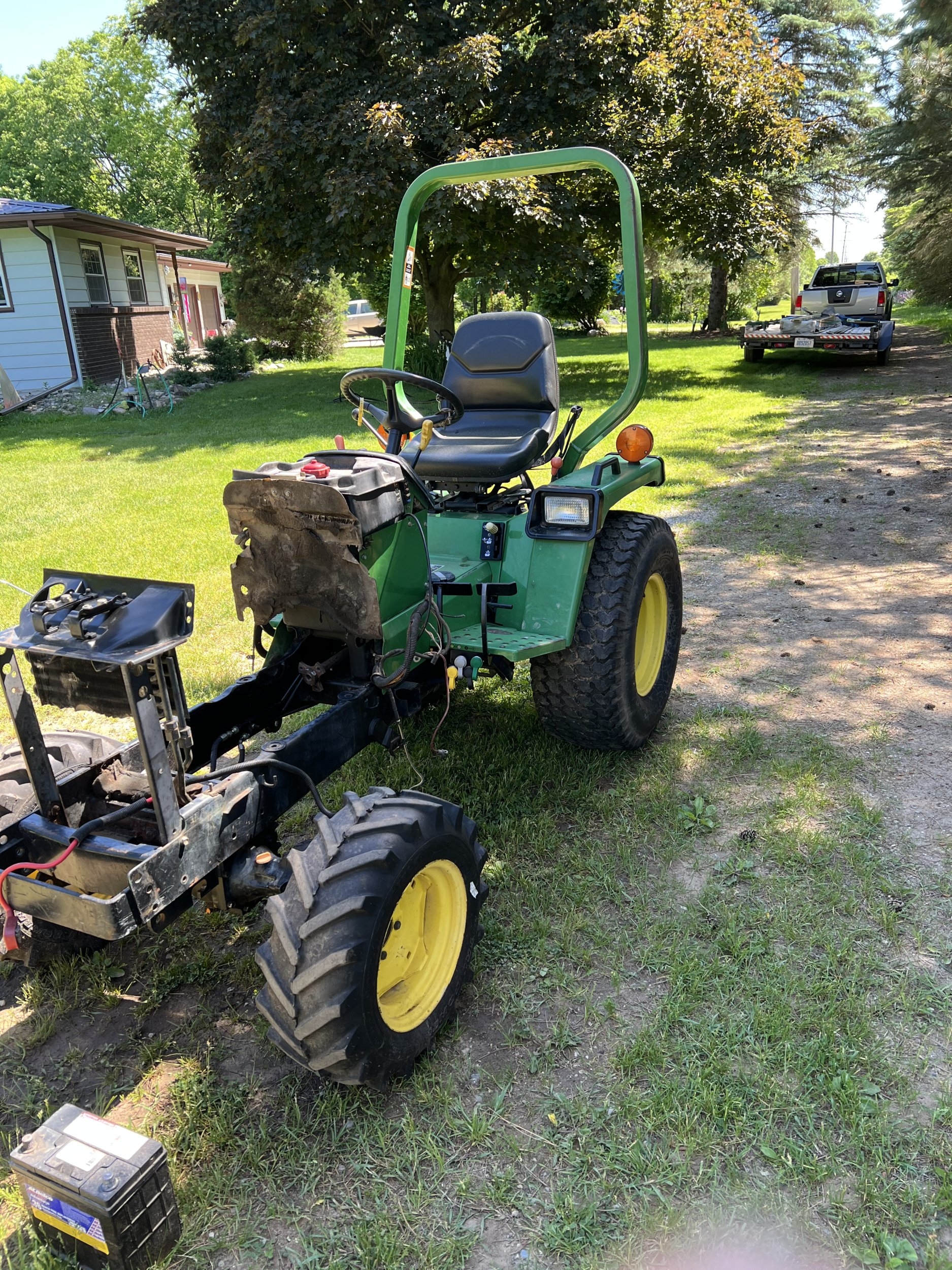

You’ll have a hard time finding parts for that particular Yanmar believe me I know John Deere dealer is no help at all that model engine is obsolete according to them.Mine blew up a year ago and I was about ready to part it out when I finally found a replacement engine that costed me plenty

I would not think its a fuel bleed problem or air in the lines because once its running and warm it restarts ok. and pretty sure you have looked around for leaks. I suspect the black smoke is from too much fuel at the start from the 4 tries, kind of like the kids rolling coal in their trucks. I know different parts of the country put fuel additives into both gas and diesel for winter usage, but it does not sound like its cold enough for that to be a problem. Is the engine cranking over fast enough for a normal start? you mentioned you changed the battery, so guessing it was cranking slowly then, did the new battery improve it? Have you tried any starting fluid? My old John Deere actually has a port to screw a can of starting fluid into

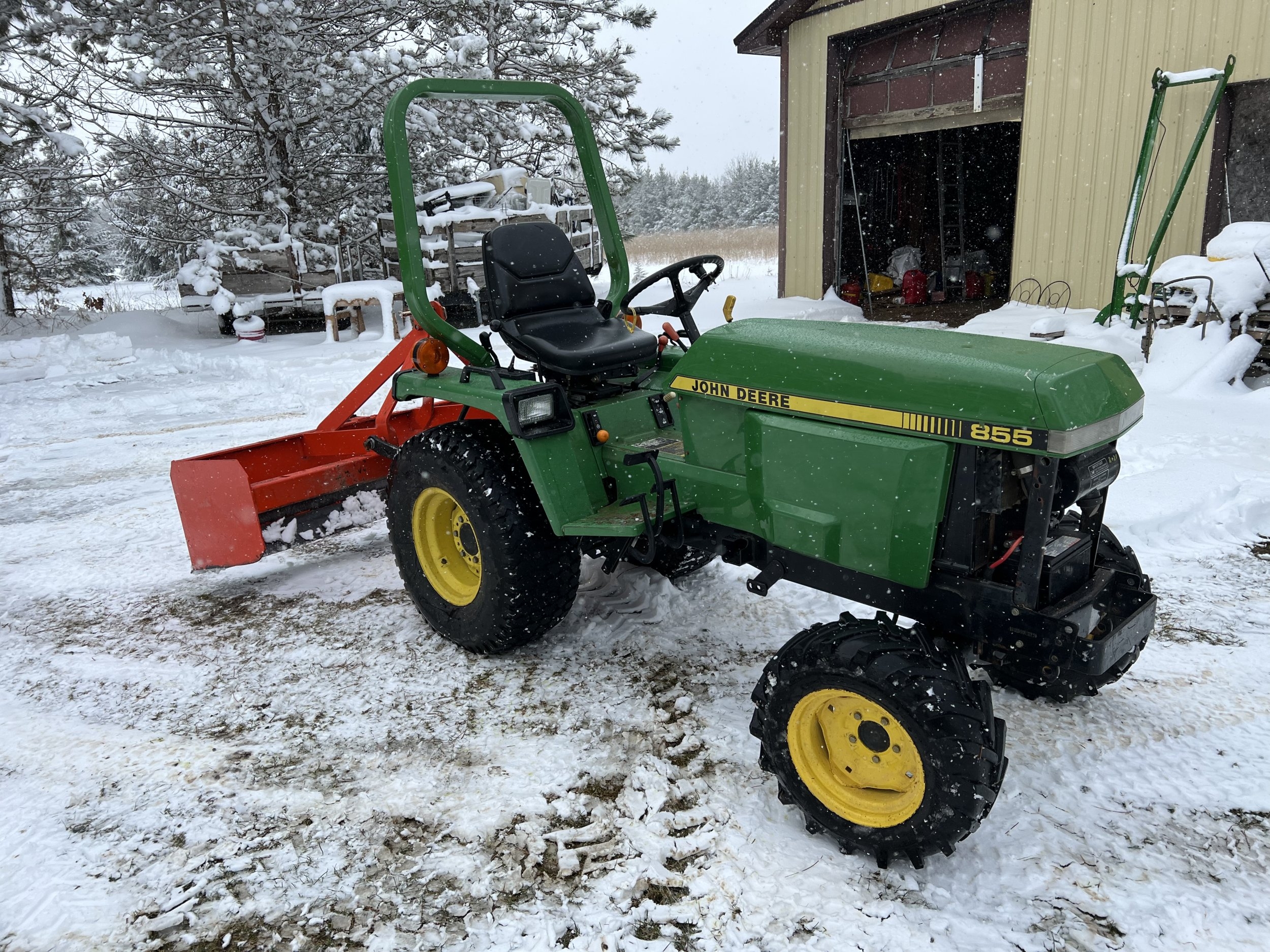

Hope all is well! I have a 1987 JD 855/856 compact utility tractor that has recently begun to be very hard to start first time in the day. It has 923 hours on it and a known history back to 2001-ish and has always been maintained well.
The tractor was used all summer for some general property upkeep and then I elected to do a full service on it in September of this year where the hydraulic, oil, coolant, and all filters (including fuel) were changed with all JD parts and JD fluids.
Current behavior is that first time in the day it will take nearly 4 attempts to start and it will blow a lot of black smoke while it is cranking. Once it has been started, it will stop and restart at will, unless around ~2 hours elapsed. Current weather is 58 degrees and it just exhibited this behavior again after resting for a few hours.
My suspicions as to root cause are either fuel-related or heat-related (32 degree nights versus 80 degree nights over the summer).
Here is what I've tried so far:
1. Using the tech manual, I have bled the fuel system at both the bowl and pump and did not see any bubbles. Have not yet progressed to the injectors.
2. Bought a test light and confirmed power at the preheater grid (this unit does NOT have glow plugs) when the light is on the dash, so I assume the heater is working.
3. Confirmed that the fuel stop solenoid activates upon start up and releases upon key turn off.
This tractor has had a history of effortless starts up until now and I'm hopeful I can restore that. Thank you in advance for any and all tips.
