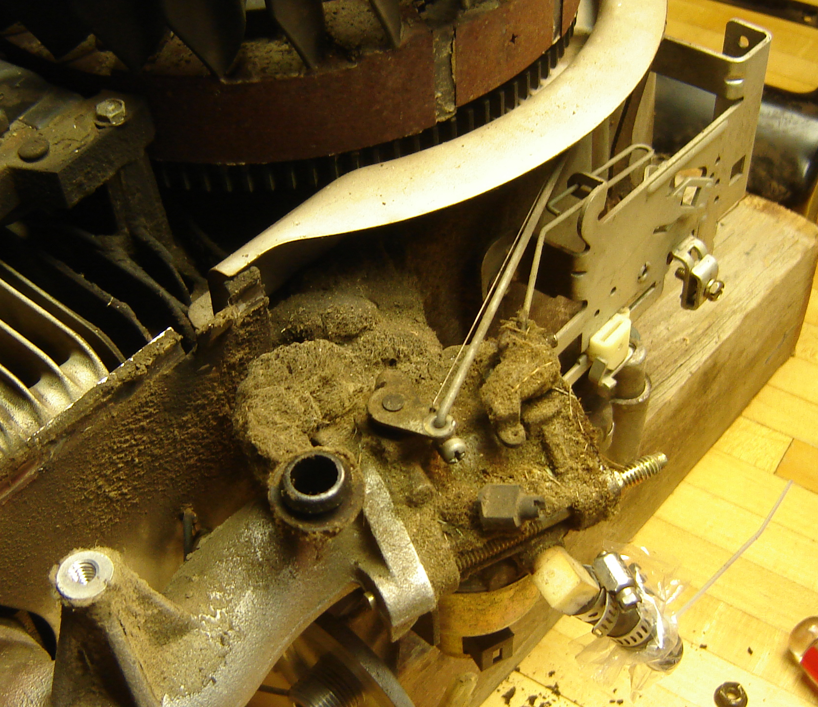

The photo of the engine mount area shows that one of the mounting bolts must have been loose. Notice the scuffed metal marks on the lower right mounting hole.
Also I noticed that the one harness is chaffing away. When you put the engine back in, make sure you put some protective covering on those wires.
As far as what else to do, I would remove all the cylinder shrouds and the fan shroud and make sure that the cooling fins are clean.
What does the spark plug look like? If the engine is burning oil, it will show on the plug.

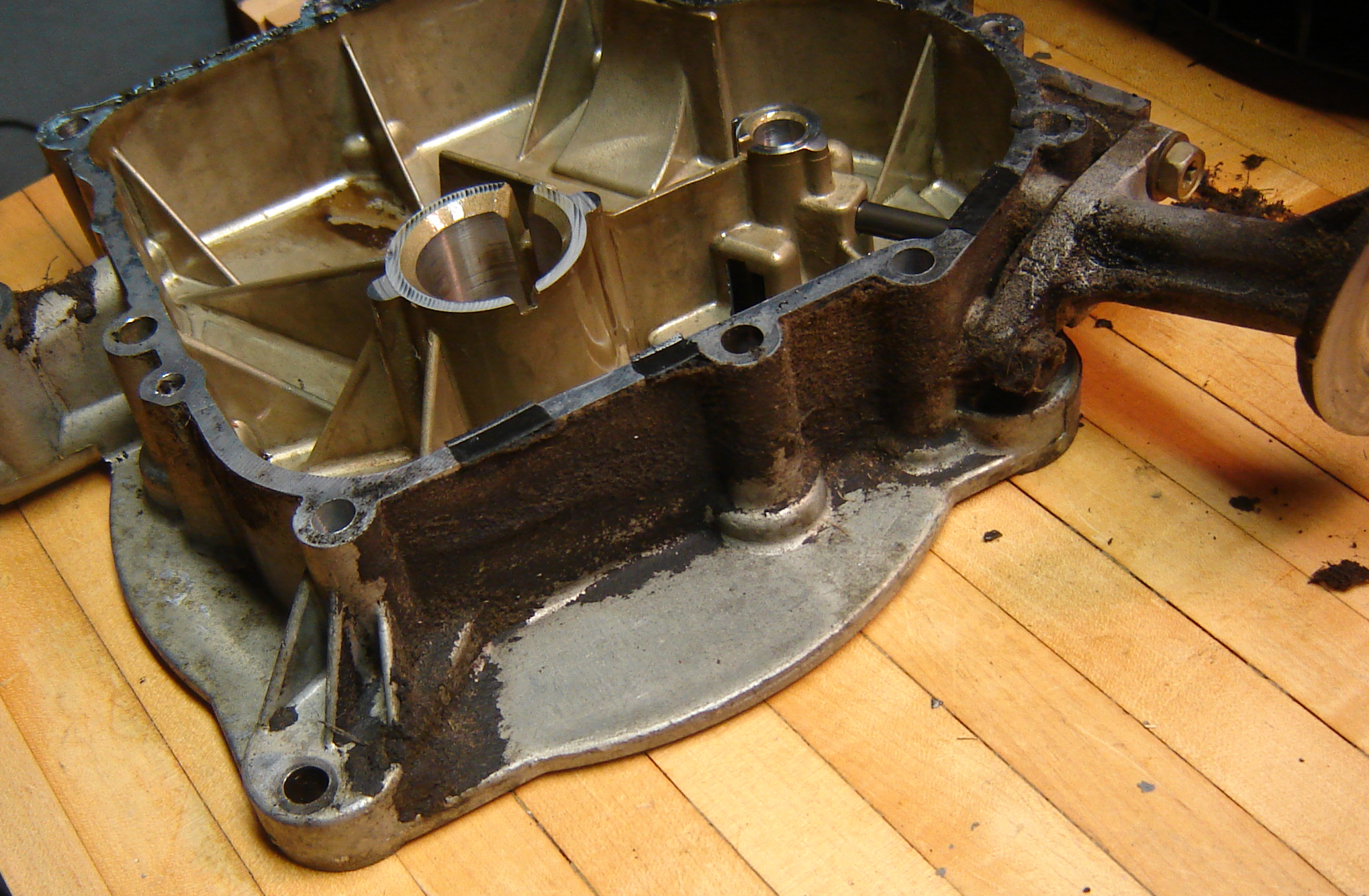

As you can see from the picture of the bottom of the oil sump pan it doesn't look like to me that the main seal is leaking, but I wonder if it would be worth the time to just go ahead and replace it while I have it all torn apart. Any thoughts? Somebody asked about the bolts that hold the sump pan on, they all seemed tight to me when I removed them so I don't think the leak would have been caused by loose bolts.
This picture shows the area of the pan where I think most of the oil was leaking from, and keep in mind some of the gunk has already been cleaned off. From here I plan to clean things up as best I can, replace the gasket/seals, and re-assemble it all. Is there anything else I should consider doing at this point?

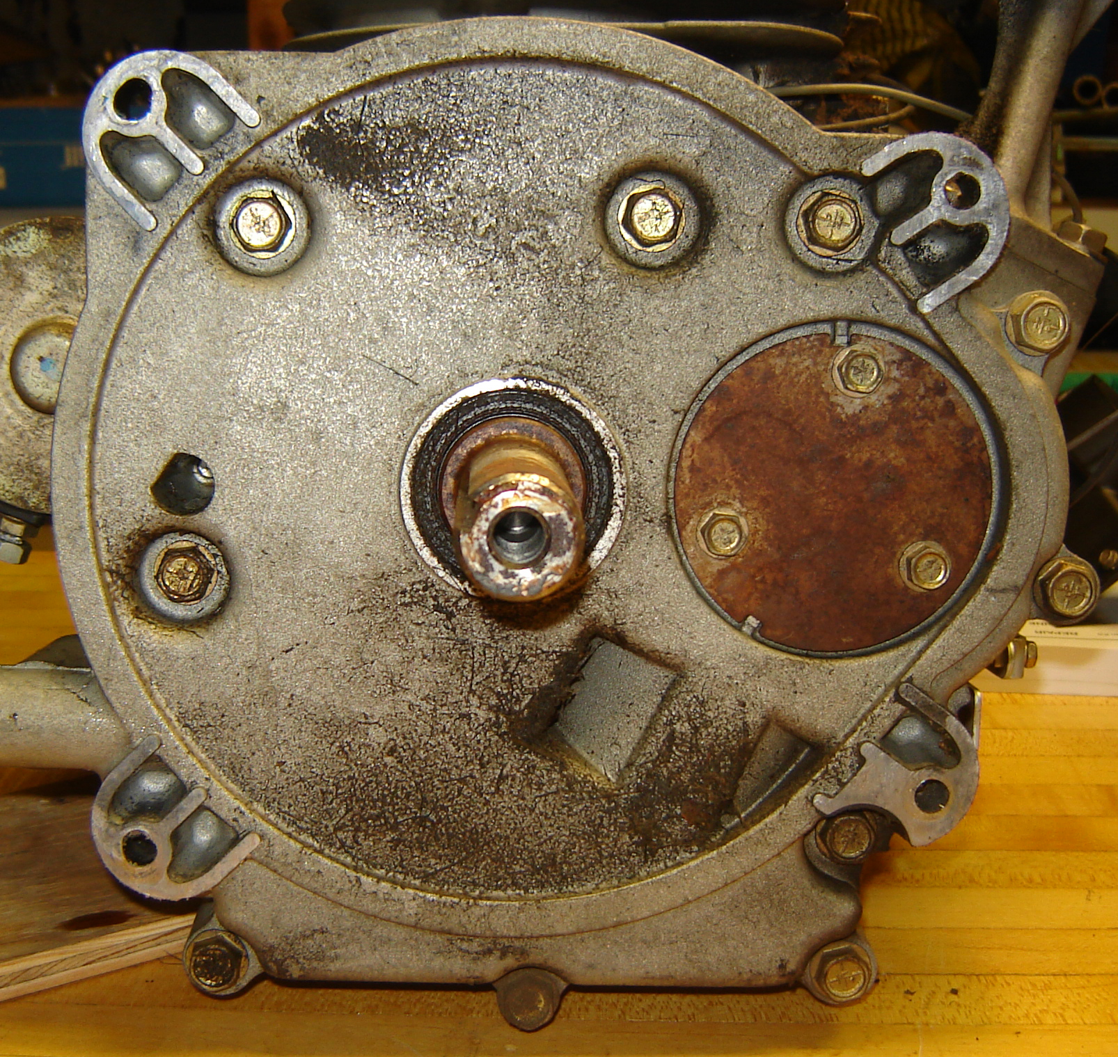

The center picture on post #12 shows the oil pump cover. Brown round cover held on with three bolts. I would definitely replace the O-ring under that cover since this is a leak point that I have fixed on a few engines.
Yes, I plan to do that as well.
   / John Deere - Briggs & Stratton Oil leak #15
Also makes it much easier to install the oil pump driver if the cover is off. And to the OP the sump gasket will harden over time and crack and get sucked into the sump. Normally a 1-2 inch chunk will come up missing. Also Briggs had issues with sump bolts backing out on the older engines before they started using the dry thread locker on the bolts.

Looking at the bearing surface on the sump, it looks really good, so I see no reason to replace the oil seal on the crankshaft.
