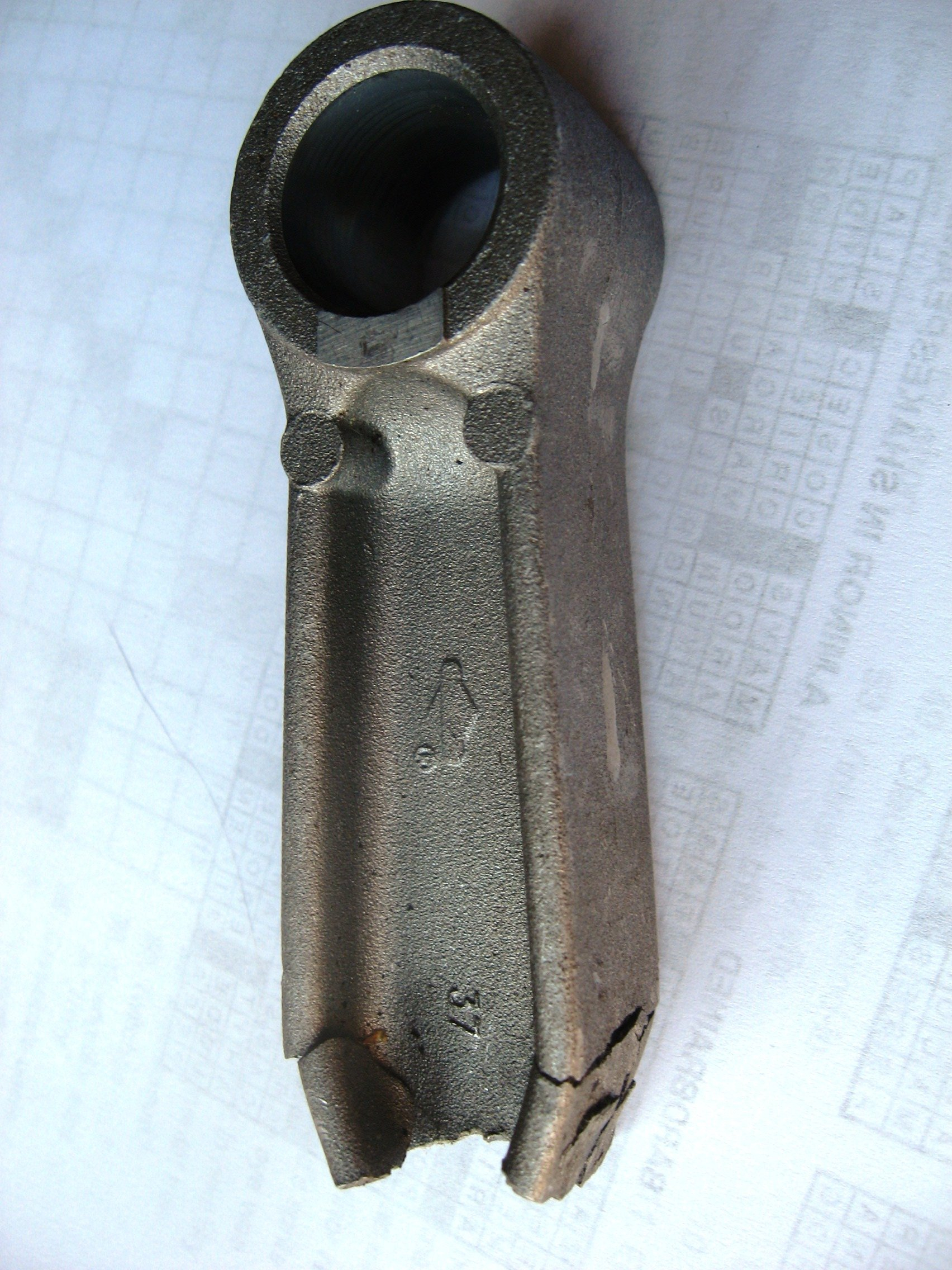

RE Old Briggs singles: one weak link (in something probably designed to last 6 to 10 years) is/was the oil slinger. Vanes are some sort of plastic, maybe nylon, and with age they get brittle and erode away. Pretty soon little to no oil is be’ in a slung, and the top end suffers.
Piston seized on the one pictured above, rod didn’t like not moving. On another the top end crank bushing became molten. Both engines 25+ y.o. Tear down revealed rounded off oiler slingers. Sad that some good things only last so long
