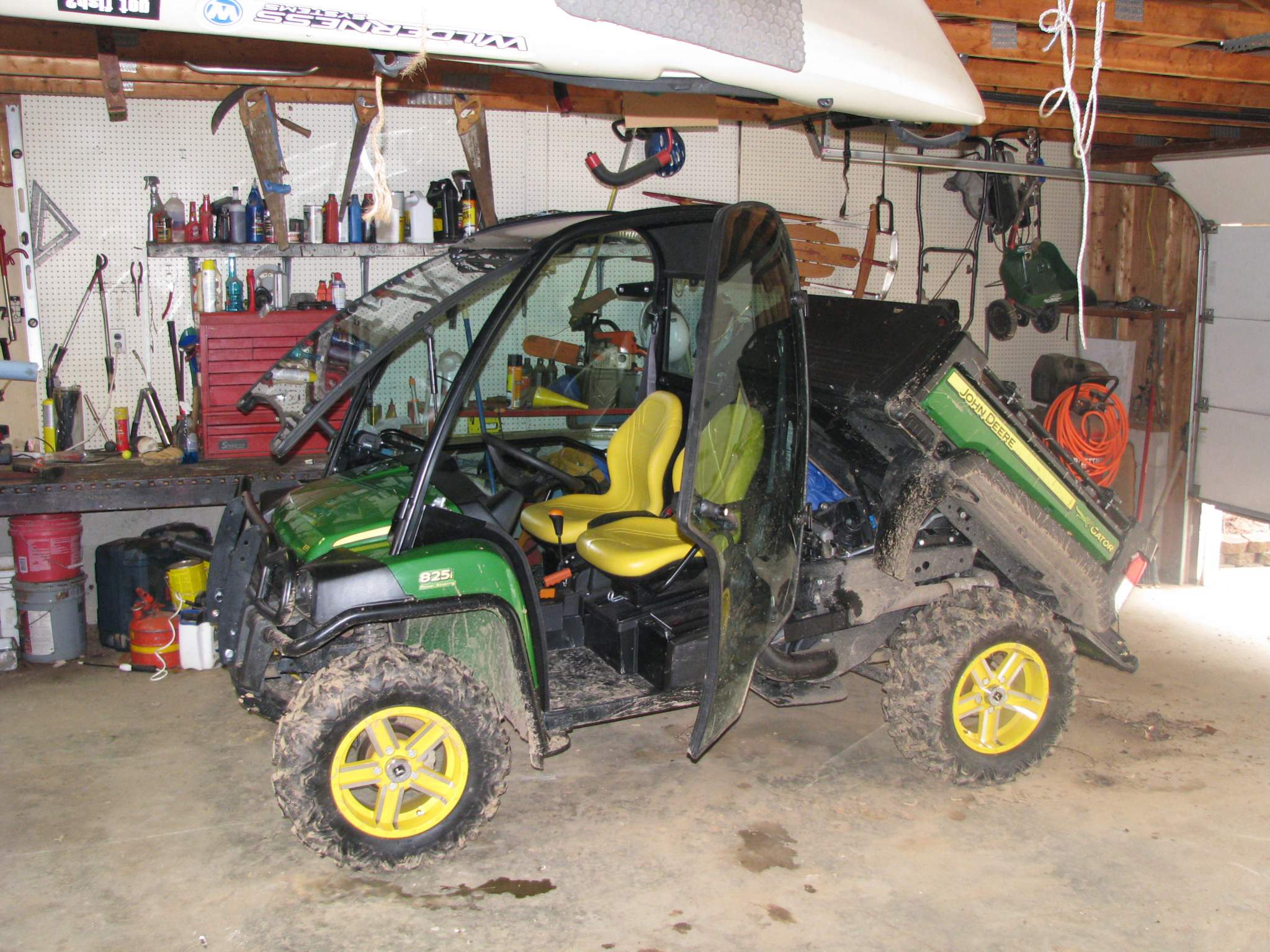

The Gator ain't light, cheap or weak. This thing is a crossover that will work hard, and than go have fun at over 40 mph, with a great suspension. The Kubota was all work and no play.
   / John deere gator or kubota Rtv #19
That is a cool looking cab on that JD. All that glass is nice to look out of but I bet it's hot in the sun. What is one of them doors to replace I wonder. The glass windshield on my rtv was not cheap. I would have to agree that the rtv is less fun but more work. I think they are both great machines, the person MUST drive BOTH to get the right one for themselves. They each have their own style to match the type of work and person. I'm a person that doesn't like to be closed in so I just have a top and windshield. I haul firewood, dirt, rocks, and manure so having the power dump is a must. I love the power steering too.
