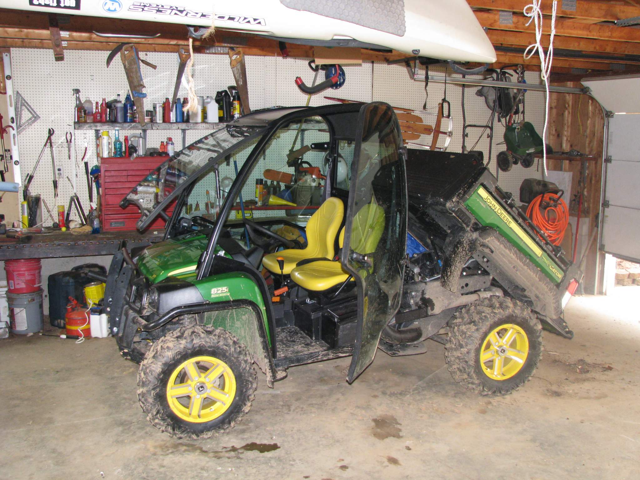

That is a cool looking cab on that JD. All that glass is nice to look out of but I bet it's hot in the sun. What is one of them doors to replace I wonder. The glass windshield on my rtv was not cheap. I would have to agree that the rtv is less fun but more work. I think they are both great machines, the person MUST drive BOTH to get the right one for themselves. They each have their own style to match the type of work and person. I'm a person that doesn't like to be closed in so I just have a top and windshield. I haul firewood, dirt, rocks, and manure so having the power dump is a must. I love the power steering too.
The doors are $2500 and they pop right off for use in the summer. The front windshield is also hinged and has little hydrualic assists to keep it open, it opens from the bottom. The rear window also cracks open for more air. All the glass is safety rated just like there tractors.
The cost of a Deere like mine with power steering, deluxe cab, front fender guards is about $17,500 you could add accessories and easily get it up over 25,000 (lighting, plow, heater hydraulics etc). I think that it probably doesn't need a heater in most of the US climates except Alaska. The heat from the radiator up front heats it up nicely with windows closed up. It does at times fog up inside if there is two people riding. I rode it a lot with the front window open, it's a little distorted but is fun sometime to have the air in your face.
When I was looking for a utv I was not looking for pure work, we enjoy long rides sometimes. Besides, work is what the tractor is for. The Gator has a 1500# towing cap and a 1000# dump bed..... Plus it can absorb a curb at 30mph almost as good as my old polaris RZR-s......and that thing has all kinds of travel in the suspension.
The adjustable independent rear suspension on the Gator is the biggest difference between the Kubota and the Deere. The Kubota while being more stout for hauling a heavy load gives up a smooth ride.
The engine is a 3cyl dohc 12 valve inline, and has a funny sound. folks that have been in the military tell me it's sounds exactly like the Taxi cabs they rode in foreign country's. That is because the engines are car engines used in little cars. John Deere gets these little Chinese engines and adapts them. They are put through some very rigorous testing.
So far the only thing I don't like about the Gator is how difficult it is to remove the oil filter. You need to remove undercage and then you need an oil filter socket with an extension. It was maddening on my first attempt. The best thing about it so far compared to my RZR is the powe steering and the huge bed.
So, like has been said, the Gator 825i is a crossover vehicle and in a new market that I believe will expand rapidly.
The people that I let drive it that are mostly razor riders say its like a cross between a helicopter and a motor home. :laughing:
Here is a photo of it with the windshield and the suicide door open and the bed in dump position.
