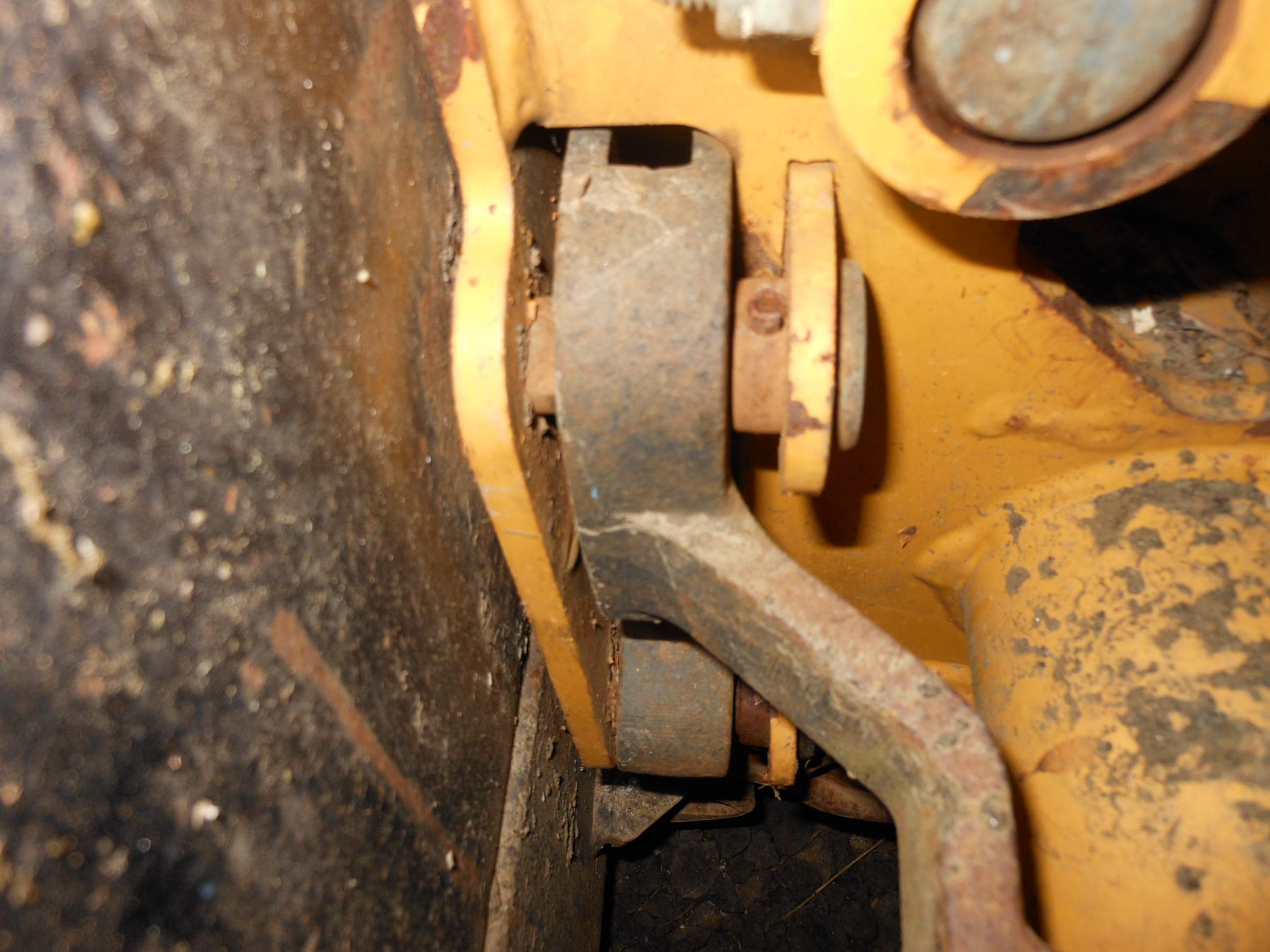

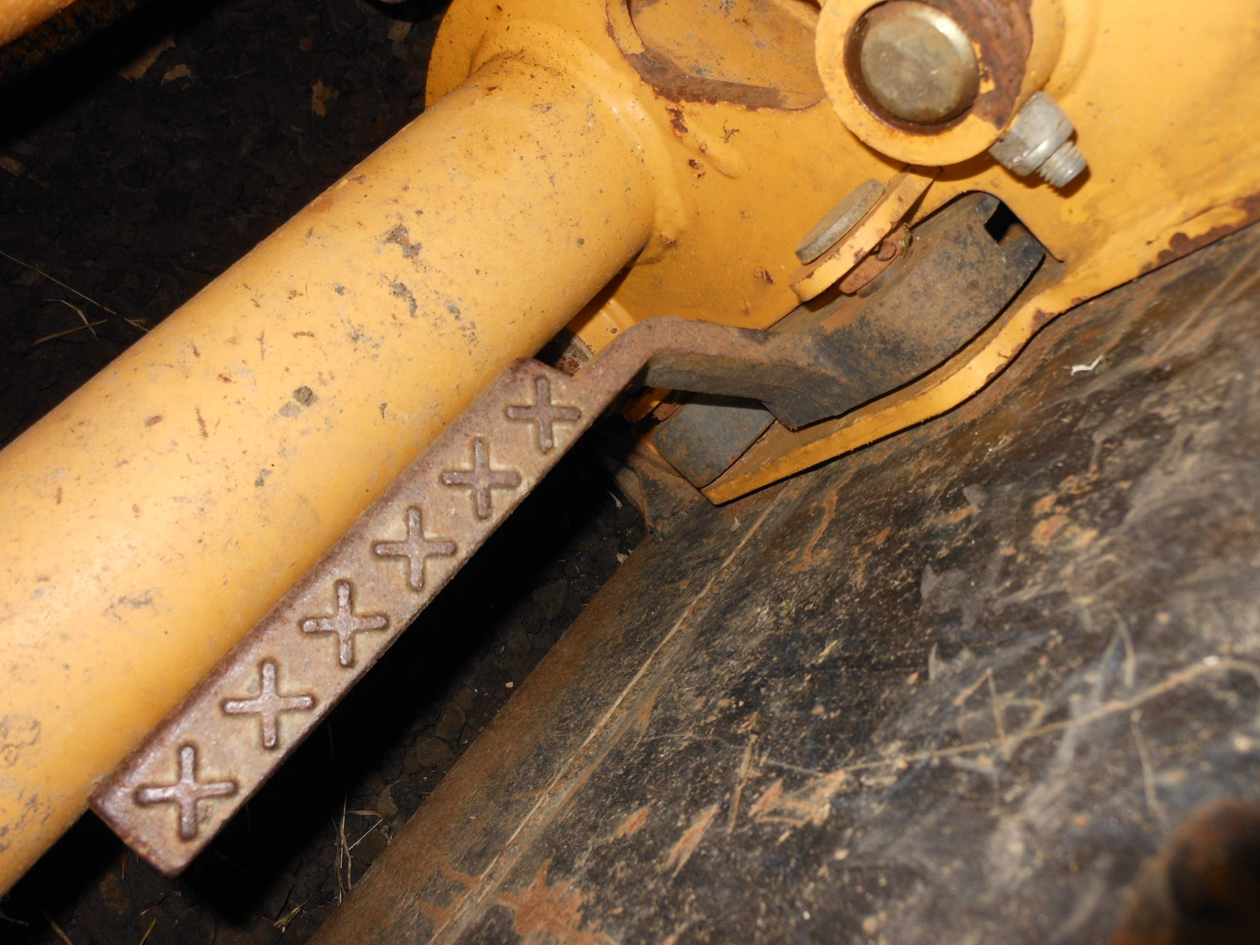

Very nice! :thumbsup: It looks like a Deere unit, looks very similar to mine. The handles on my QA are loose, I think the pins are worn out on mine due to lack of maintenance. I guess i will have to put in new pins on a rainy day. Nice new unit you have, it will make your 5520 much more versatile.:thumbsup:

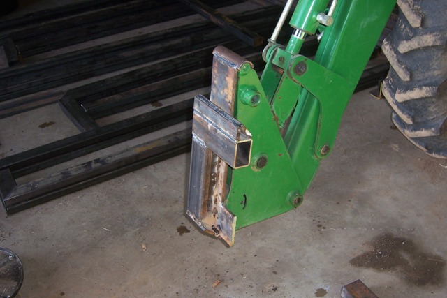

The only thing I don't like is the fact you loose all the JD Hook and pin set up ... everything needs to be changed.
   / John Deere Hook and Pin to SSQA #13
That's what I had been saying--that I think you can get an adaptor that hooks to the JD hook and pin thing on one side and on the other side is a SSQA. This way you can retain the use of JD implements in general and also quickly attach the adaptor to use SSQA. Also no change to a self-levelling loader arrangement.
I think these can be bought, but aren't cheap, and you could probably make a set using JD BT13919 "bullet style" bucket adaptors that cost $255 a couple years ago.

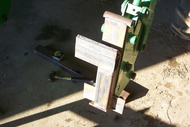

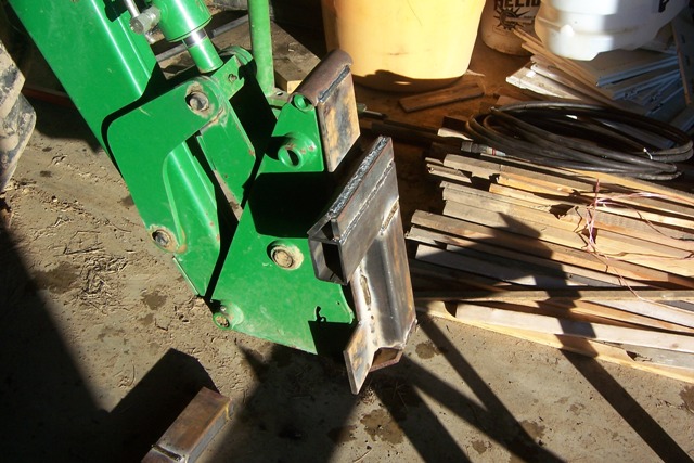

Thats what I did for the 5520 ... built it to fit the JD hook and pin and on the other side the SSQA ... I had a problem making the springs and lever's ... so my pins have holes and pins to pin the pins. It works very well ... takes about 2 minutes longer to undo it from a skid steer implement cause I have to pull the pins instead of lifting the 2 levers ... and a whole lot cheaper!!!
The 5520 will be used for the 10 bale grapple, so I leave the homemade atatchment on the grapple and use the JD Hook and Pin to hook up and unhook.

Did you post photos of this since I somehow missed the fact you did it that way. Sounds wonderful--how did you do it?
#18
I'm pretty sure same thing. Thank you.
I did in another thread somewhere but here they are again ... I'll snap some finished pictures tomorrow.

That really is very nice workmanship and design thinking. Thanks.
#20
Thanks ... wish I could have fiqured out a way to have levers on the pins. I'll shoot a picture today of the finished project.
I did have a spring loaded "T" handle on each side for the SSQA. The spring was too much to lift the "T" handle so I cut that off and went with a drop pin. I'm sure in time I'll find the spring loaded latches and add them.
