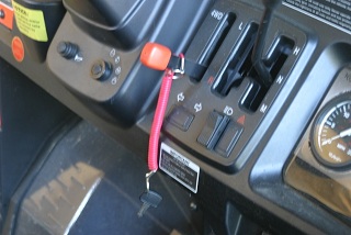

Belhaven, congrats on the RTV! You've already mentioned the issue with rear receiver hitch. One thing that will not likely impress you is the location of the ignition key. I noticed on my RTV 900 xt that the hours were piling up on the meter. One day I found the key turned to the accessory position. This was causing the hour meter to be operating without the engine running. I new my son was the last to drive the RTV and accused him of leaving the key on. Turns out that his knee and later mine were contacting the key when exiting the seat. We didn't know that our knees were switching the key to the accessory position.
My fix was to purchase a plastic spiral entending key chain to the 4wd lever and the other end to the key. I then instructed all RTV drivers to remove the key and let it dangle everytime the engine was shut off. No unwanted hours accumulated since. See picture.
