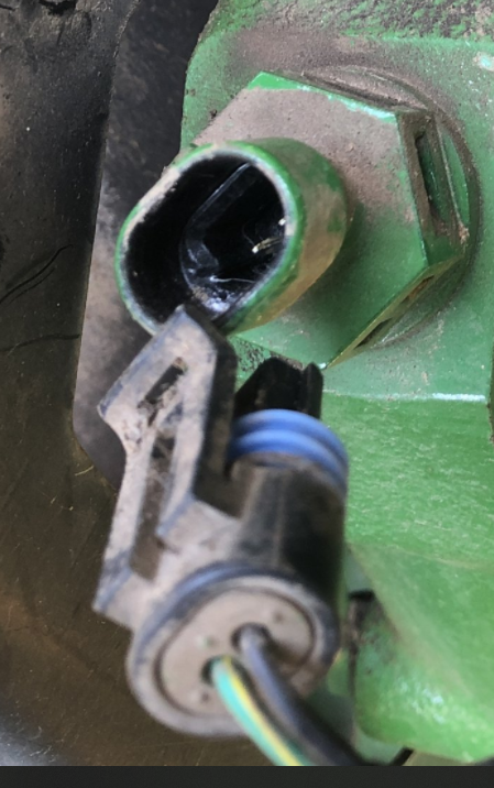

Which 2 sensors are you referring to? RE503242 & ?????
I already purchased the one sensor RE519144. Now I’ll have to get the other I’m not sure of the number just yet I assume it is the one you said. RE503242
   / John Deere keeps blowing starting fuse. #23
Sensor in your photo is for speed/hour meter & if it failed engine will still start/operate but no engine rpm's or hours of use will be displaced on instrument panel.
I’ll have to look at the meters I sure appreciate the help y’all are giving me. I couldn’t get anything from John Deere
   / John Deere keeps blowing starting fuse. #25
Follow the wires from the TEMP. Sensor at the neck and unplug it..
It works thank you all !!!!!!!!
I’ll replace both of the sensors as soon as I can.
For anyone doing this in the future, it's the colder temps that made the fuse blow again. The disconnect wire thing only works until colder temps change the timing requirements and the fuses blow again. There are a zillion 5000 (and perhaps 4000, etc) series Deere with this exact setup so it's a common problem.
Very important here is to watch the torque on the bolt when installing the sending unit. It's only a couple ft lbs. Search my other threads or comments on this the for the exact number but I think 3 ft lbs.
This is extra important because you will snap the bolt or nut off and then you will have to buy the part a second time around.

Here's much earlier thread on this:
One mistake is that I said it advances timing when it actually retards it.
Also---Manual says.
Cold Start Advance Switch—
Torque .............................................................................. 5 N•m (3.5 lb-ft)
