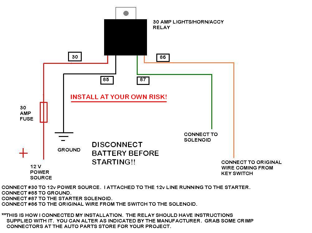

Try a starter assist relay to fix this problem. Any questions on it's installation, please advise. JD does sell these, $20-30, or you can assemble one yourself for a few bucks. I spent less than $5 on mine, but a member took exception to that, so you will have to see what it costs yourself. There have been many folks that installed these and were amazed at the results.
Let me know if you have any questions. PM or e-mail might be best.

I'll bet the click you hear is the fuel shutoff solenoid at the carb. Is the "click" when the key is turned to "run" or to "start"?
With all due respect to the previous poster, a relay kit will not do much to help with this situation on these tractors. The old JD's that "switched" the positive side of the system through the safety circuits could have voltage drops that would cause the starters not to engage. On these tractors, all that is done via the ground side. There is actually a relay currently there that engages once all the safety circuits are satisfied.
I suspect you've got a brake switch problem.
