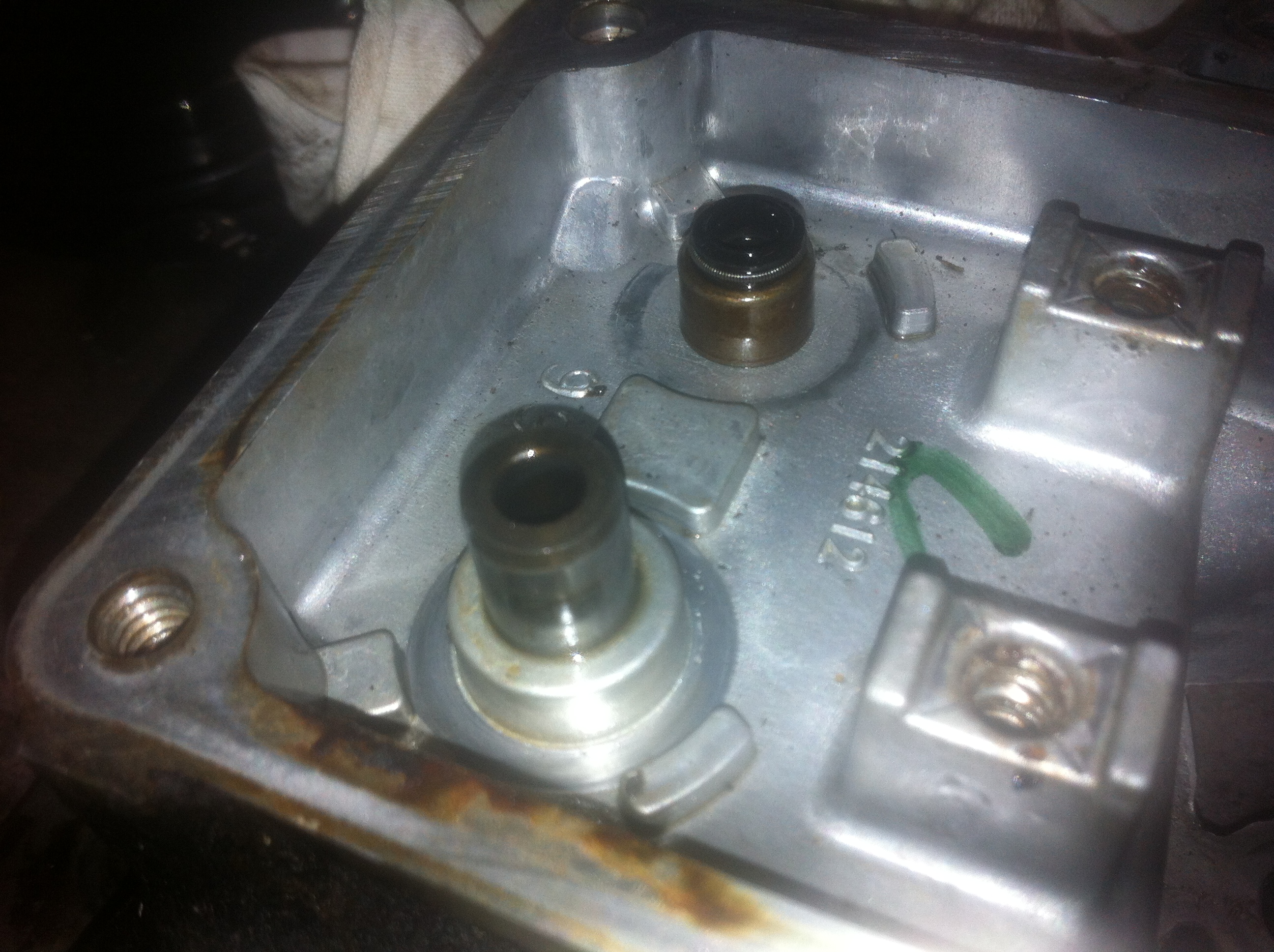

Keep an eye on the push rods bending again. There was a flaw in these engines that the valve guide will migrate in the head. When this happens it prevents the valve from opening and the when that happens your push rods are the weak link and will bend. You can look through the valve spring to see if your valve guide is migrating up. It will push the valve seal out of place as well.
What causes this is a combination of oil leaks and debris collecting on the cooling fins on the head which restricts the proper cooling of the head. As the aluminum expands at a faster rate than the valve guide it will allow the guide to migrate out of its hole. There is a fix but will require disassemble of the head and pressing out the valve guides and drilling and tapping holes in the head to insert set screws to better hold the guide in place.

Yes sir, thank for contributing to this thread. Since replacing the rods I've discovered that mice had built homes in the nooks of the engine. I've been able to remove most of the debris after some of it actually caught on fire while I was mowing! I agree that there definitely was a cooling issue and I should further clean the cooling fins on the cylinder heads.
After finding the rocker arm bolts loose, I'm hoping that was what led to the bent rods. Although, I can't rule out that the valve guides haven't migrated as you've described.
How can I check for migration of the valve guides?
So, I checked the valve guides and it appears they haven't moved.
Thank you so much for your insight, I will keep an eye out for this!
I set all the rockers with .004" of clearance with the feeler gauge just as described in the video posted on page 1. All I can say is wow.. It purrs so nice now. No rickety slop under the valve covers. It rolls over effortlessly at start up. I'm very happy with what I've learned here and I am very grateful to all of you that have contributed to this thread.
