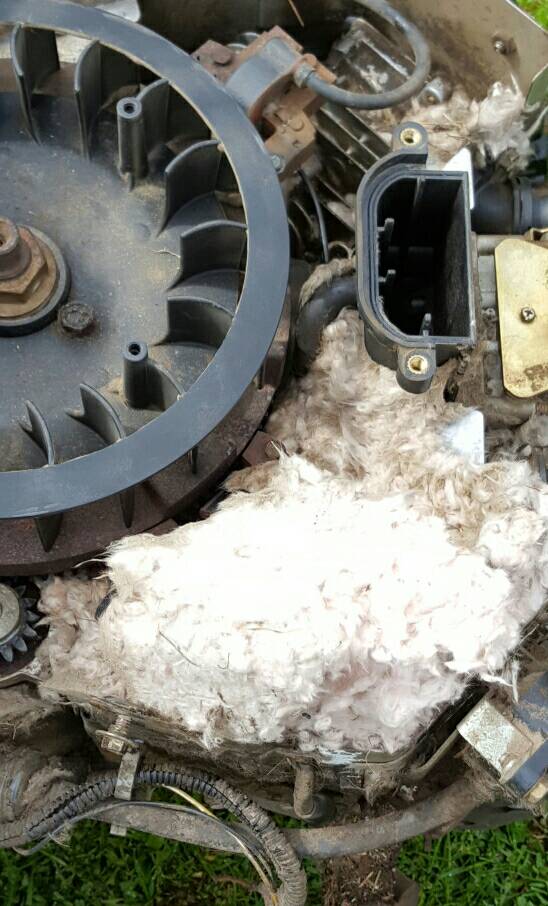

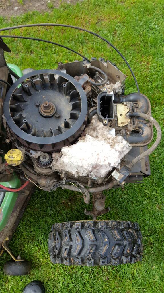

Here's what I found under the engine cover.

Actually this is quite common.
If you store your tractor outside or in a shed the allows mice to enter, you should check for this problem every time you start up your tractor.
You don't need to remove the engine cover to check, just look around under the edges of the fan cover. If you see grass or sticks showing, time to remove the cover and check.
Get some mouse poison bait and traps.
Richard

You are fortunate that you still have an engine after finding that mouse nest. Neighbor burned up one cylinder in his, very quickly due to a mouse.

Thanks Richard. Yes I do store my lawn tractor in a small pole barn that I built under some pine trees. I've even seen mice run out of it (the tractor) usually when I fire it up the first time for the mowing season. I didn't realize they would pack that much stuff in there lol.
I would love to get another 5 years out of this mower. I bought it new 14 years ago. This spring I replaced the spindles and blades (second time), gave in an oil and filter change. I've also rebuilt the transmission which lasted 2 years so I replaced that as well a couple years ago.
I just used it for an hour today after tuning the pushrods. I'm very pleased. And to think I was ready to scrap it and dump two grand on a used mower down the road lol.
Thanks again everyone for the help :)
