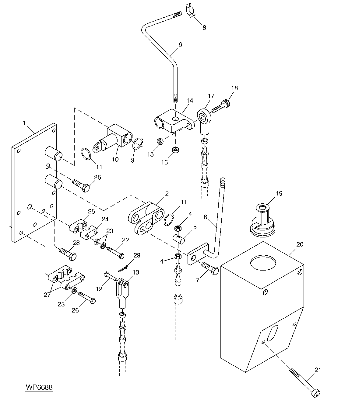

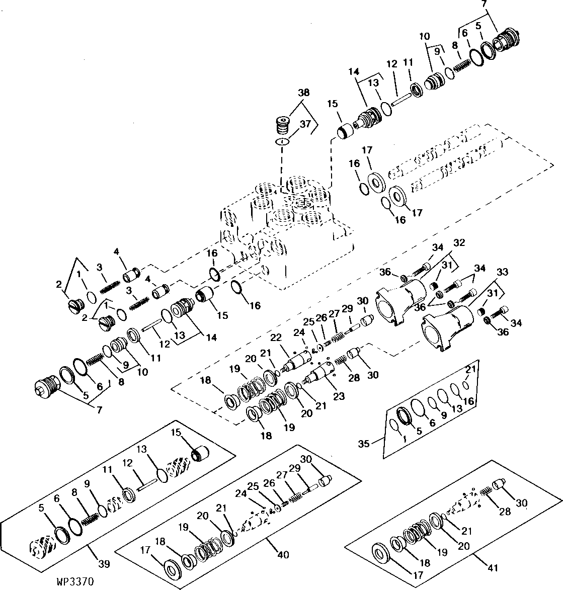

   / john deere loader joystick problems #15
I'm guessing you have a JD joystick. I'd suggest to remove cover(parts key 20) and check all clamps & attaching parts for tightness. Again I guessed a control valve as there are a couple of valve brands. Parts key 40 is the lift spool detent repair kit.
