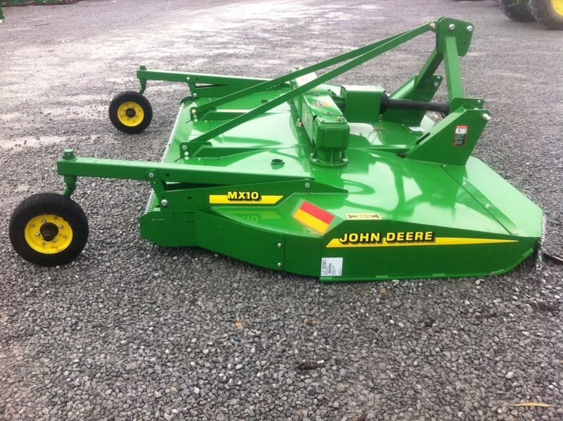

I just bought a New JD MX10 cutter to replace my MX6 :dance1:
I'm sold on the sloped DUAL layered top deck, blade speed & rear tail wheel design.

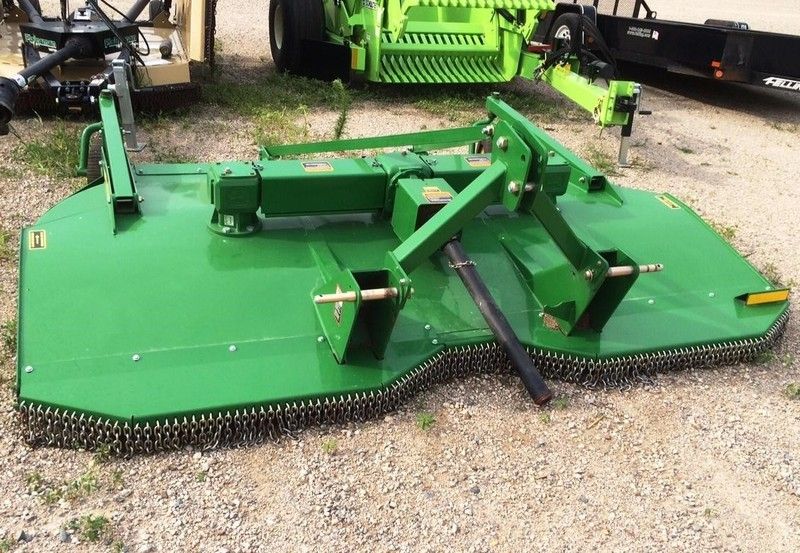

I don't like the front chain setup though (borrowed pic)

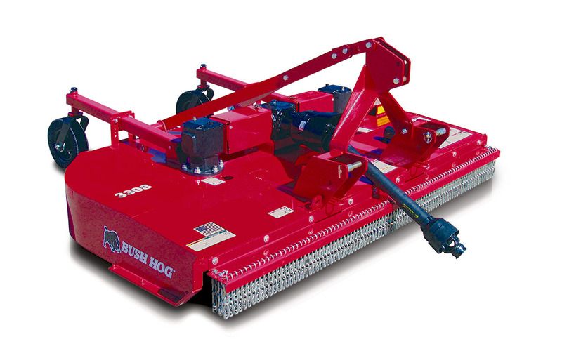

I'm in the process of cutting & fabbing front chain bracket to have chains Strait across the front jus like the New BH 3308 :
Pix to come when finished.

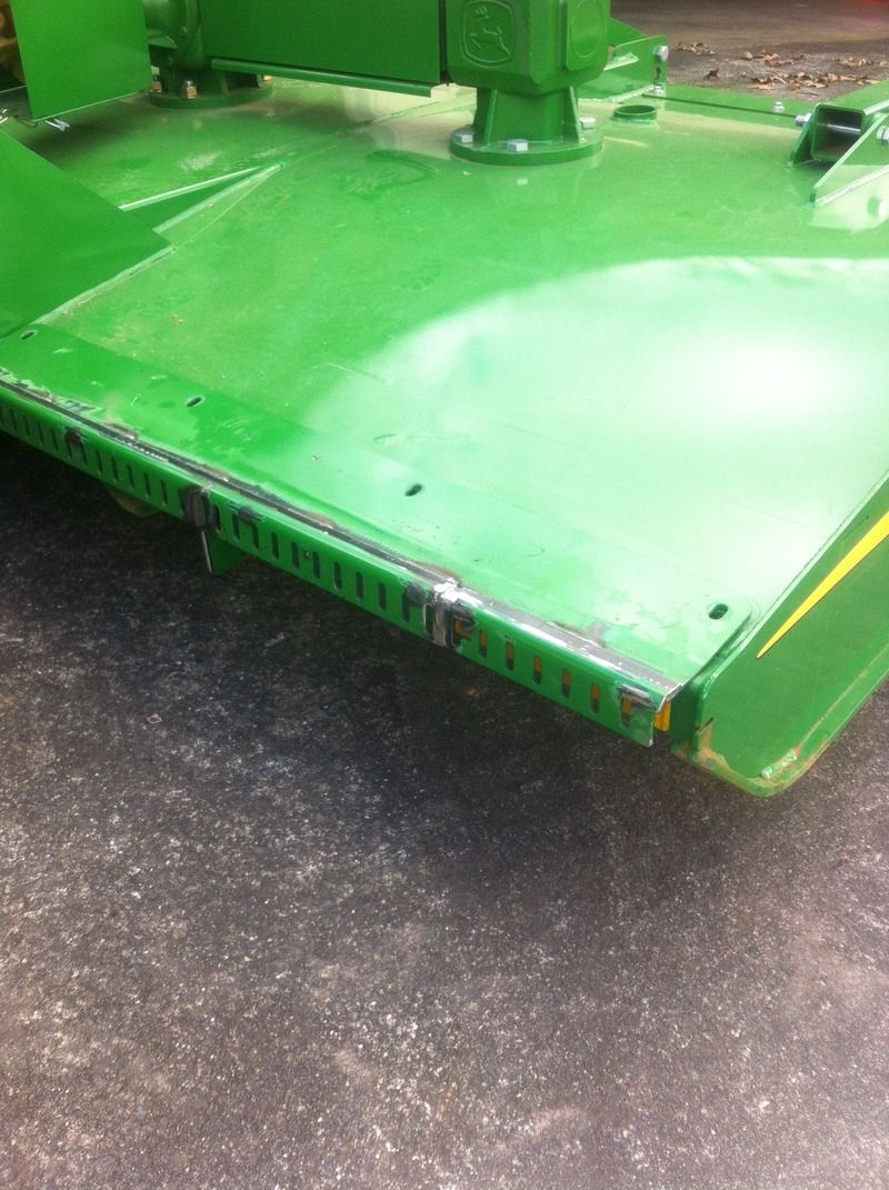

/ JOHN DEERE MX10 MODS
Here's one side mocked up.
Gotta paint, bolt it on & hang chains :
#12
Does it not throw grass back up under your tractor ?

Front side of deck
Factory front chains hangs 12-14" in front on blade tips.
They'll be 4-5" with them STRAIT across the frt edge of deck.
The domed guards up front, hits the object before the blade gets to it.
MX8 front chains hangs STRAIT across ...
