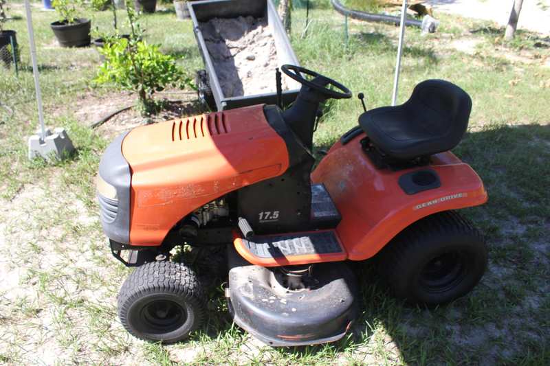

It sounds like you got your moneys worth, That GT sounds very "capable", (I had to add that) and I've been there with a drain field I moved with my prior grass cutter (2011 Ariens hd special with 6spd), what a mess, I blew the seals eventually on that transaxle, they were cheap and easy to replace though, and I still have that old transaxle. I don't know what I will use it for yet, but it was too good to give up.:)

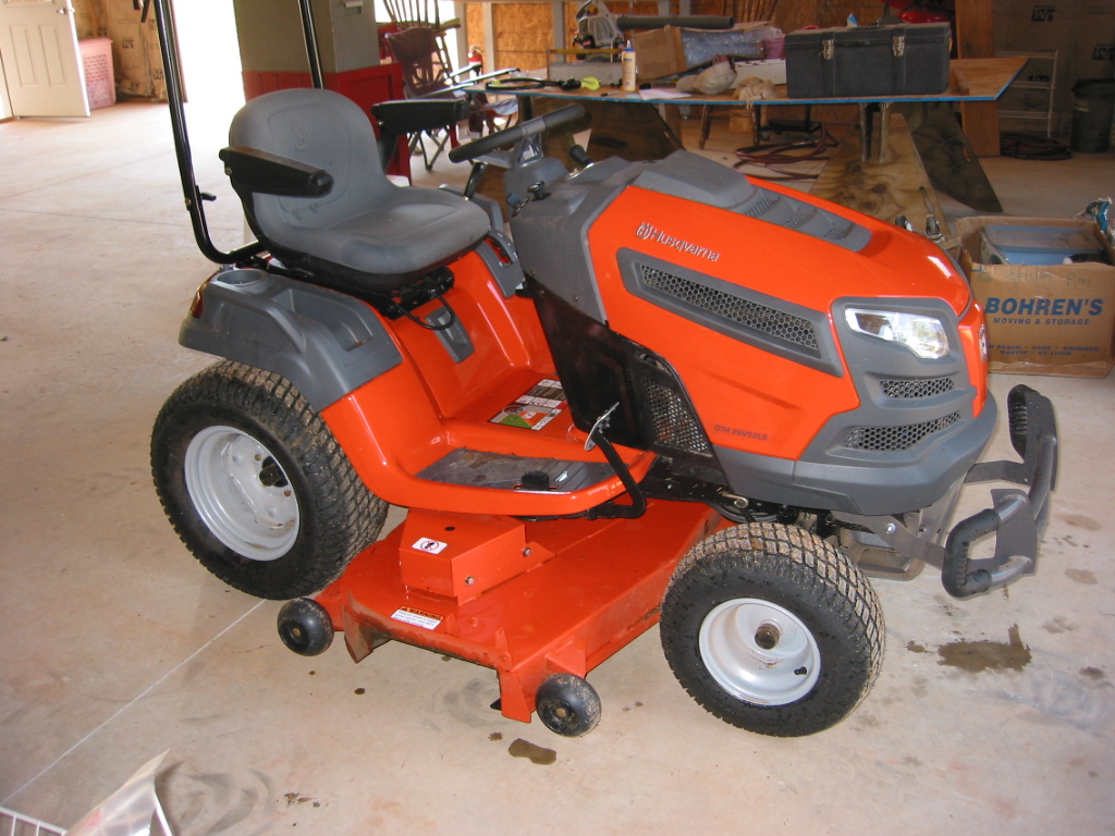

On 17 JULY 2017 I purchased my GT48DXLS from our local Dealer. Our Dealer claimed it was an actual "Garden Tractor" capable of all the accessories ("Ground Engagement Work") that were represented by Husqvarna in their ads.
For 62 hrs and 10 months I would have told people how good the GT was and how "capable" it was, getting so much yard work done, and a small amount of mowing.
On 07JUN2018, with 63hrs on the tractor, everything changed.
This is the short, short, short,....etc. version.
The chassis failed, completely. This failure was not due to too much weight in the bucket. It didn't magically occur because of the different brand of 200lbs weight limit scoop I had (I was using a JBJR). It didn't fail because I was driving a 5 mph max speed tractor so fast that I crashed it, which would have resulted in me going over the front as if I was in the Olympics (I had no injuries, the tractor implement had no damage, and the plastic tractor pieces were intact too). The support brackets for the scoop I was using were a bit more supportive for the tractor than the Husqvarna support brackets would have been. It's actually a simple thing that took a couple seconds, very fast. I had joined the many ranks of front snow blower owners that found themselves with a chassis that had buckled in the same identical location. While Husqvarna was busy publicly ignoring the problem with their known weak chassis, they were quickly quietly eliminating the GT from their model line up and then slapping on a thick piece of metal in this very weak spot. They called this metal piece added in 2018 a "Chassis Support Bracket". Husqvarna thinks they don't have to come clean about their weak frame, so I'm helping them. 😉

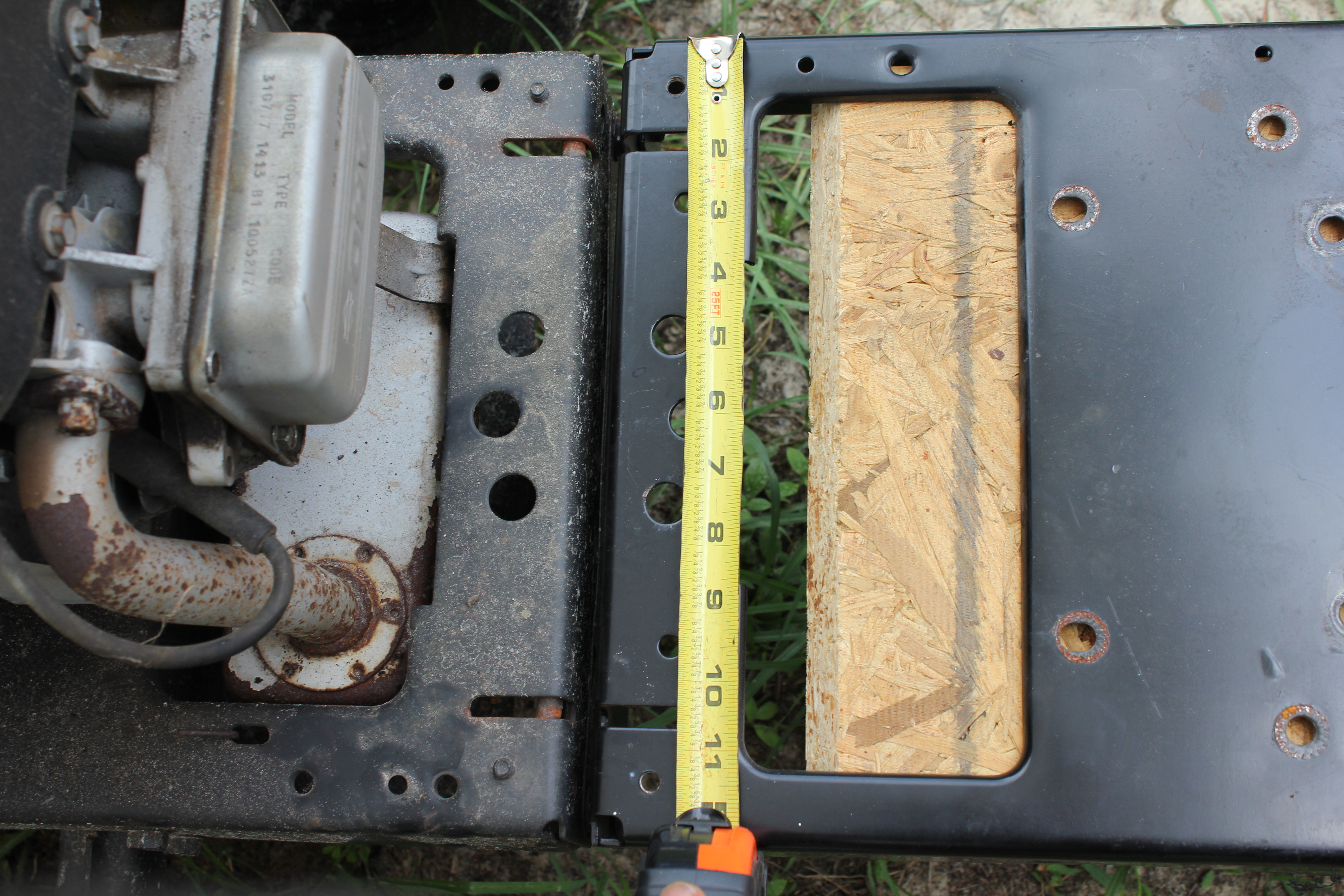

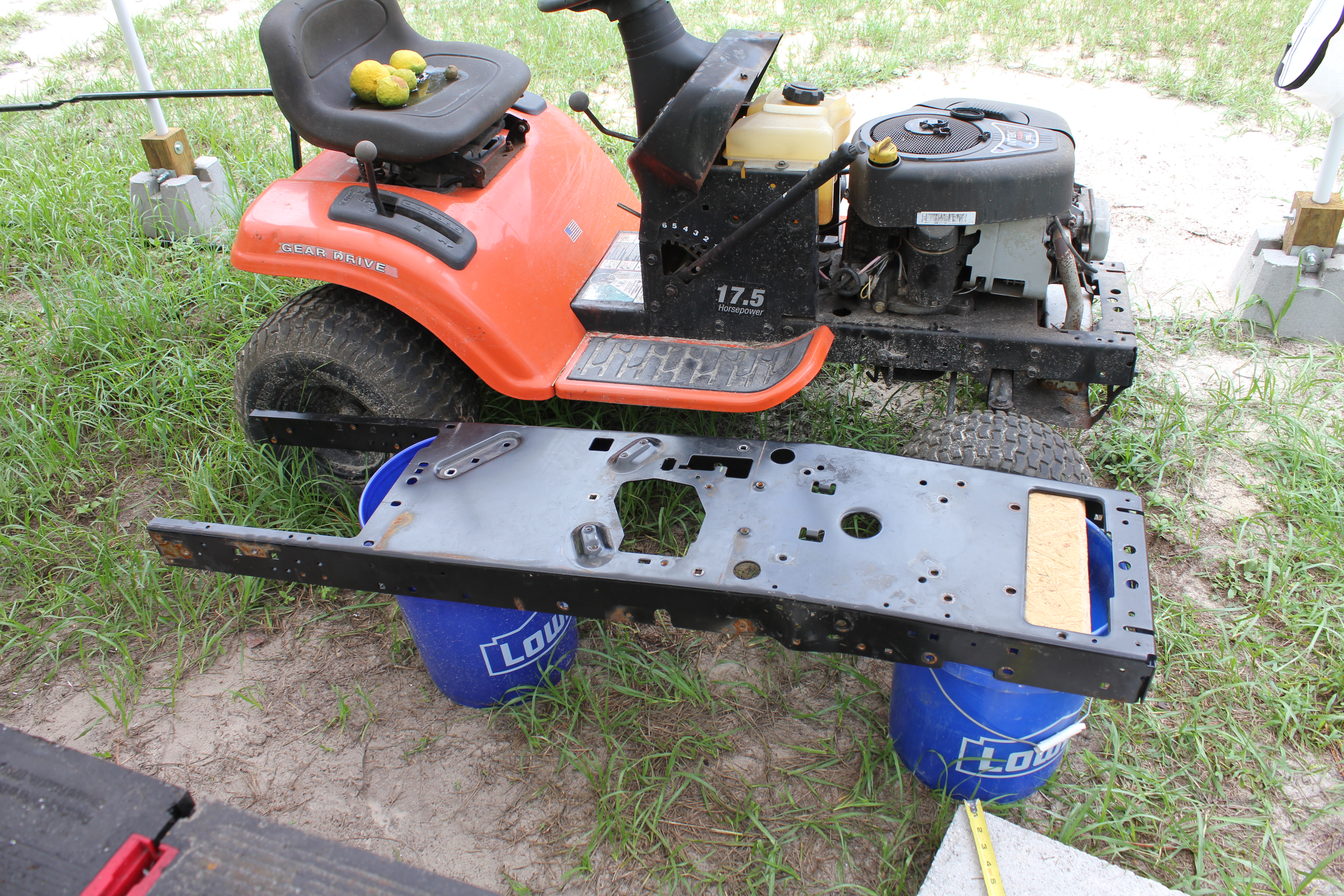

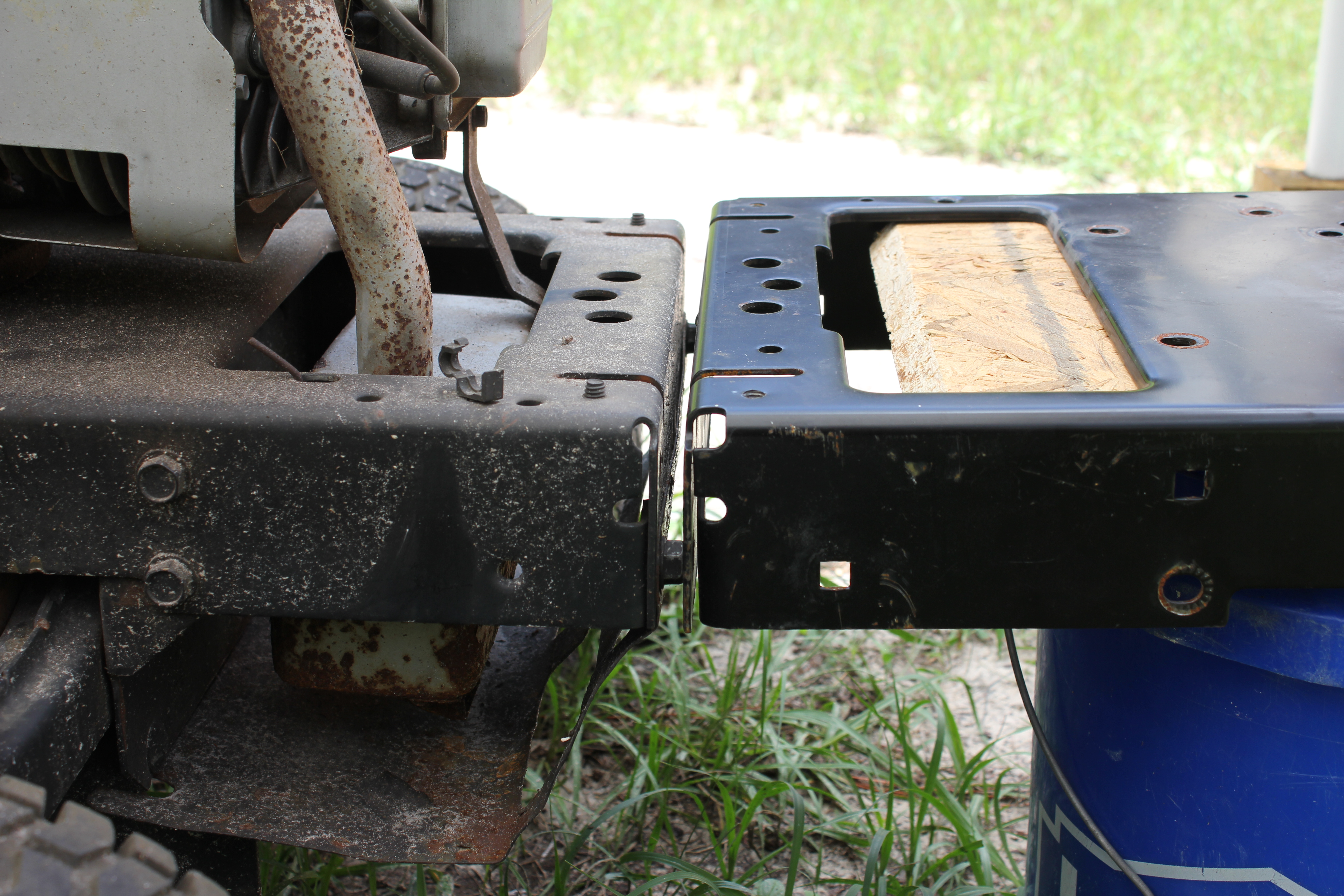

So I had to rebuild the tractor on my own employing an engineer and credible, agriculture Fabrication shop that is approx 2 hrs from me to help me make this a true Light Garden Tractor. This manufacturer was very helpful, to include showing me what I could do that was labor intensive to help keep the costs down for me. All they do is build and fix the big machines, I was thankful for them taking this on as a small project. I have 173hrs on it now. Unlike Husqvarna's empty promises, The fabrication shop kept their word and my GT performs as it always should have, had it been fitted with a properly engineered chassis in the beginning from the manufacturer, which is what I thought I was buying in the first place, when they sold me on their "robust" frame.
So that's the short, short short, short, version..... of what was the motivation behind my post.

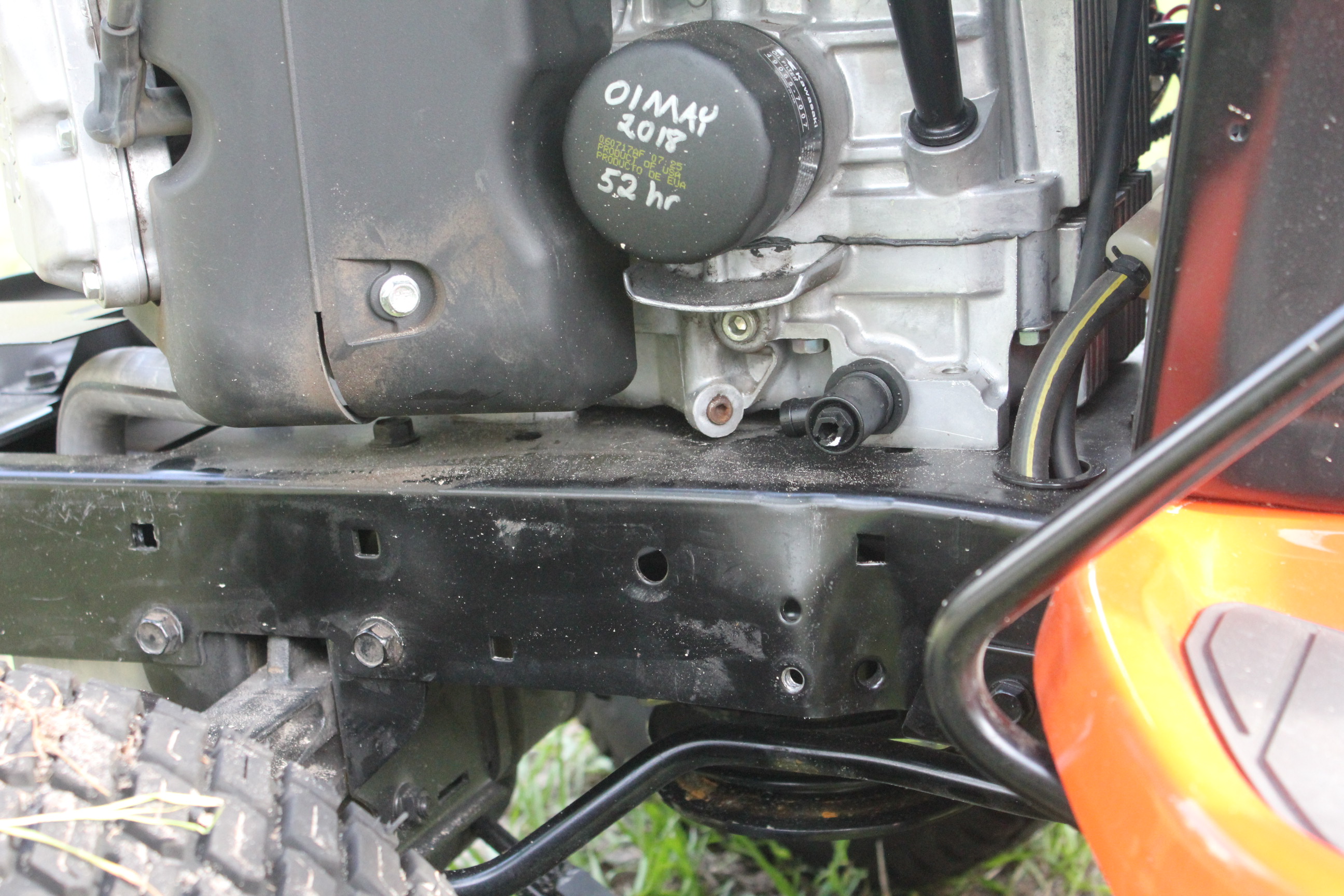

Glad to see this is still creating do it yourself thought and interest.

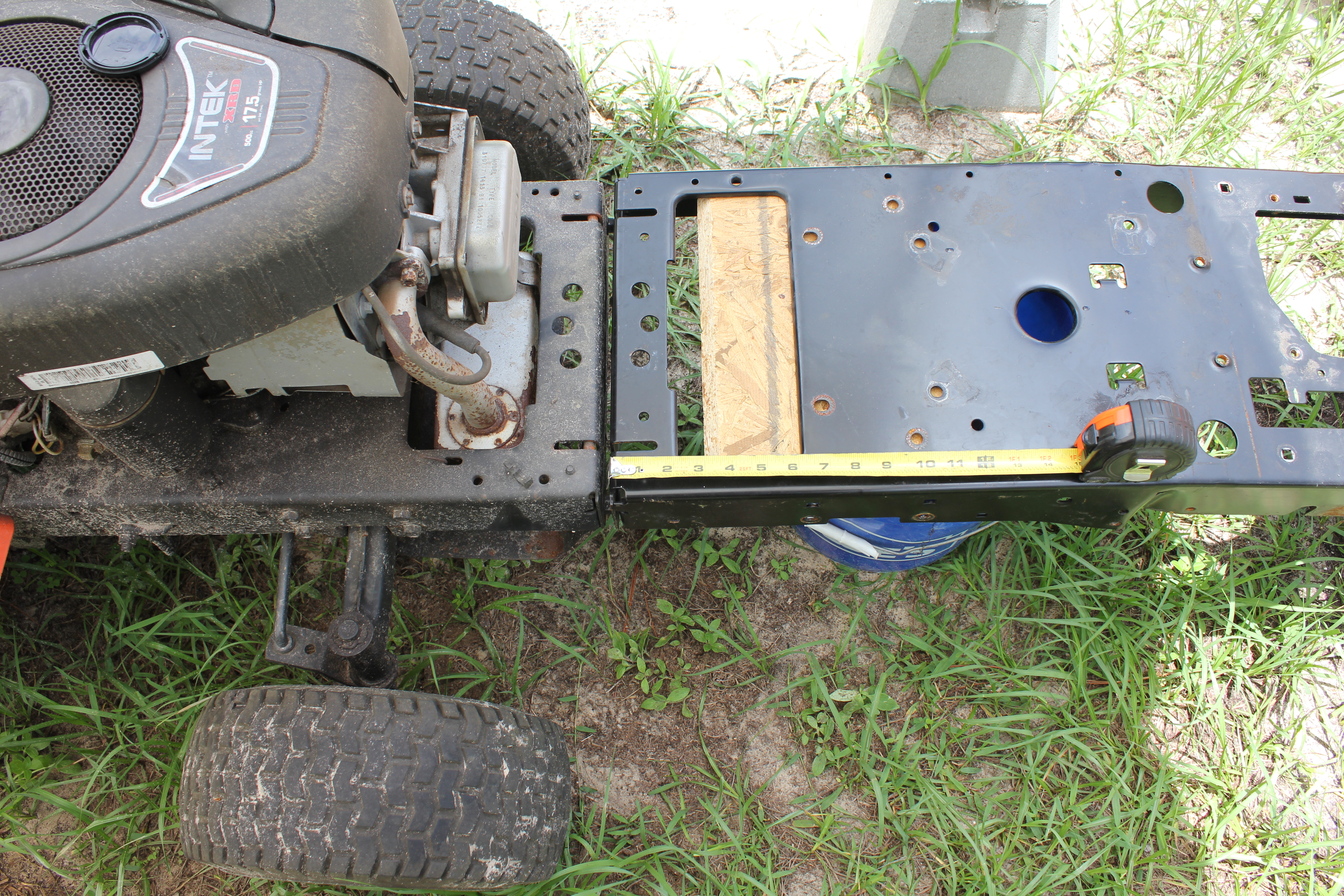

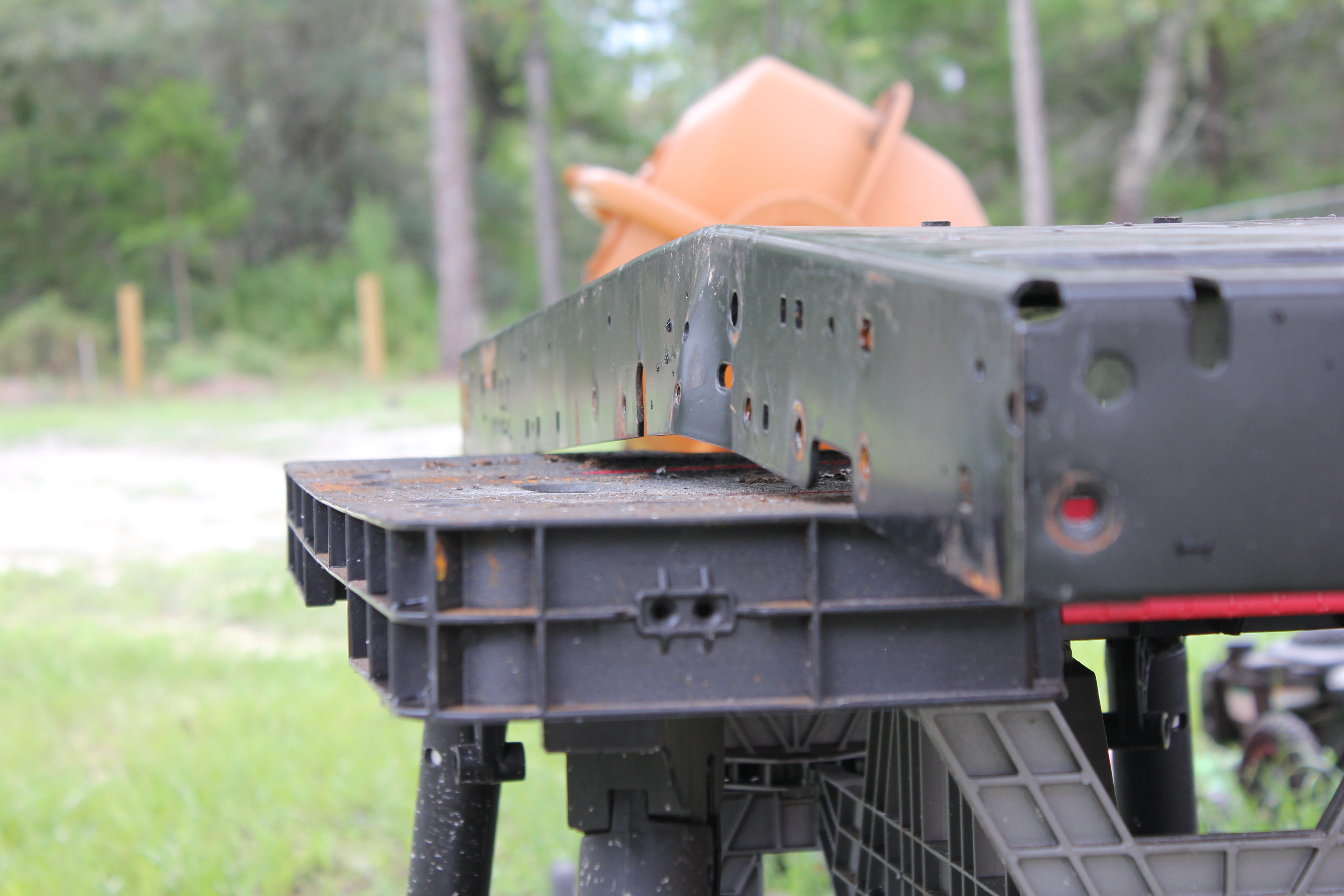

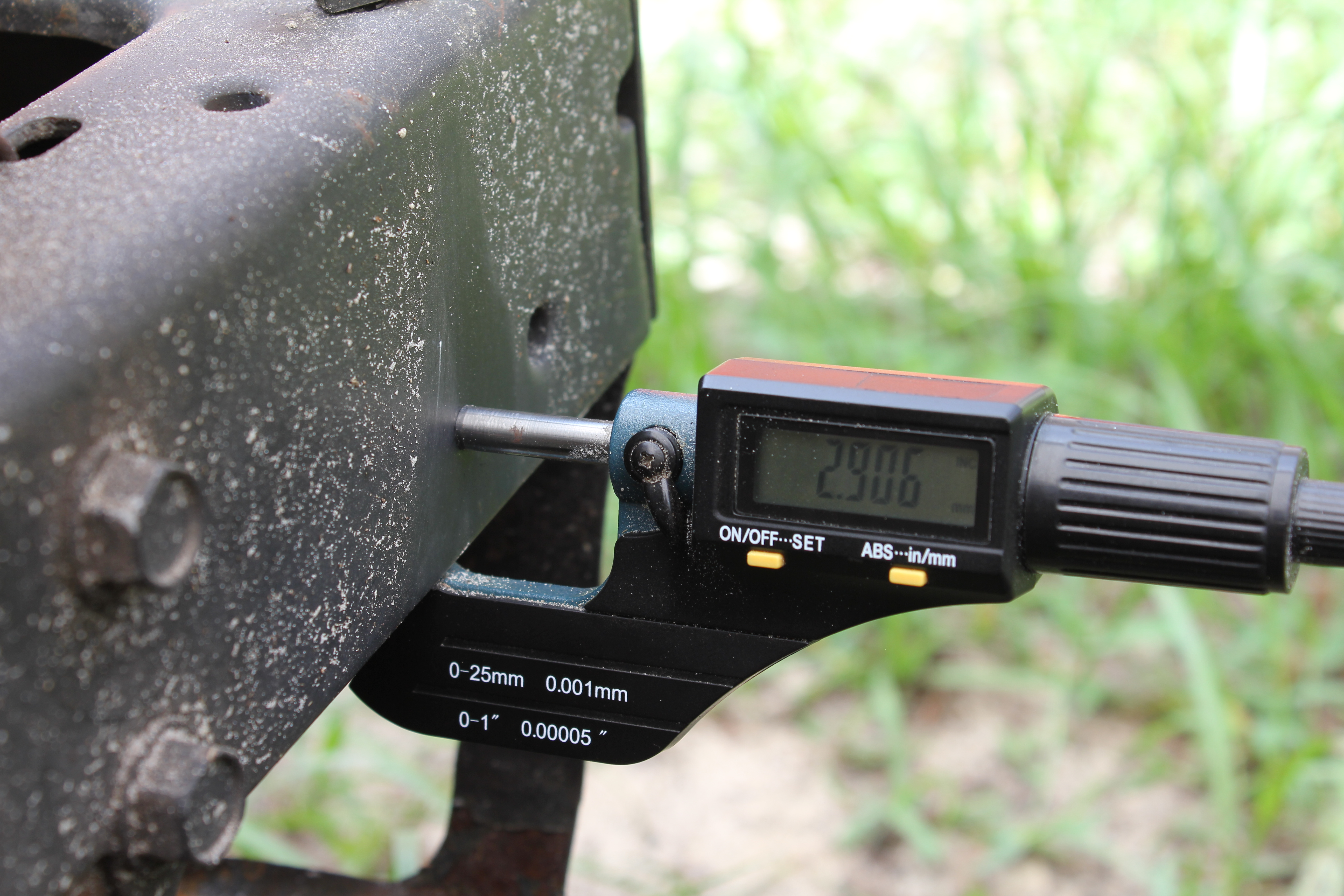

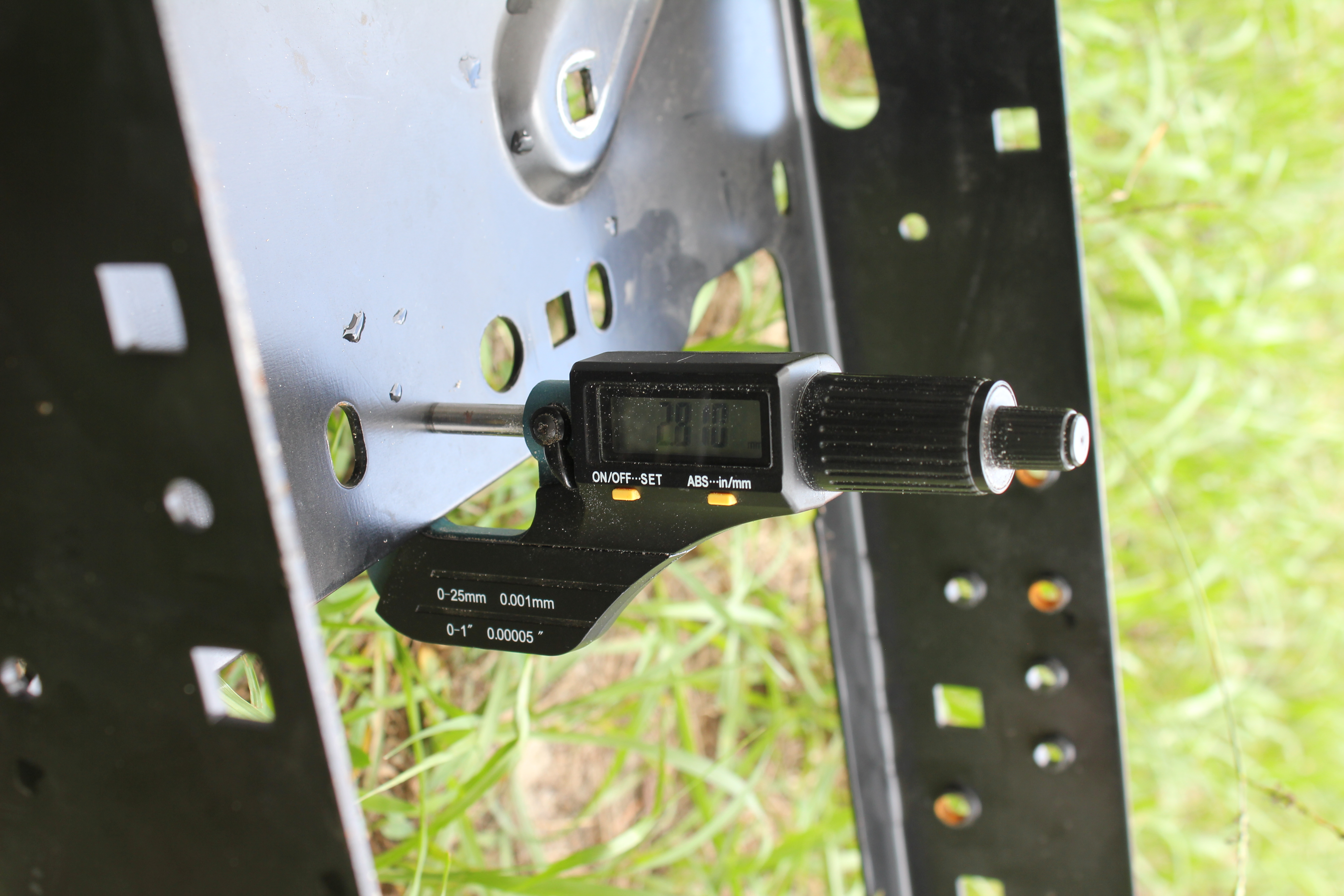

To clear up the question, the chassis on the 2017 is 3" tall, you have the same as my 2017 GT48DXLS.
The chassis has changed part numbers over the years for extra bolt holes drilled but that's it. The chassis on the latest TS3 series is the same as the chassis on the GT series and the YT series it originally was on when Electrolux spun the AYP company off to it's own management under Husqvarna in 2006.
The chassis production was started in 2005 for 2006 models of YT's at first, it was morphed from earlier models (built prior to 2005) that were a bit stronger. I gave all the dimensions to the TS3 series chassis in my post on the build, I'll include links.
The build is a very good aid for anyone thinking of putting a front ground engagement implement on their 26lb pan chassis Husqvarna or Craftsman, or the few private labels. What I've built is very capable of digging, leveling, and such like a scut bucket just not the overall height :).
I've moved a lot of sand, and I have more to go with the up and coming build projects. Having the abilities to move the weight with that bucket has been invaluable to me, I recommend the Johnny Bucket JR and proper chassis modifications.
