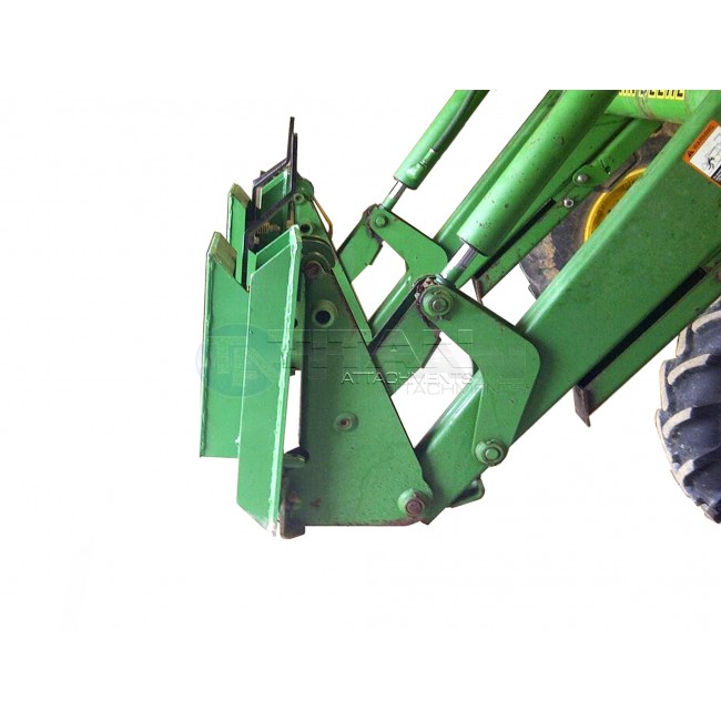

According to my dealer, to convert to the SSQA would be a special order and require fabricating so I wonder if that's where I would lose my lift capacity cause there would be a lot more metal and plate.
/ john deere quick attach to skid steer attach #13
With all do respect, your dealer is dead wrong.

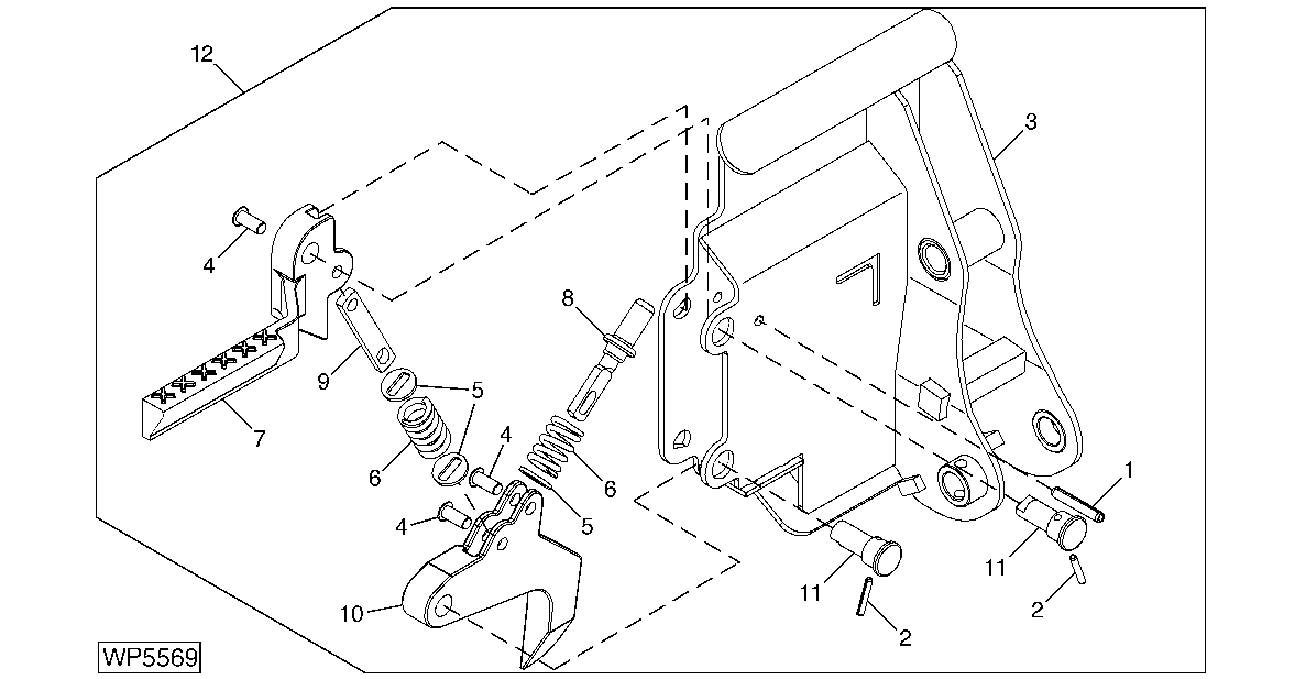

From the sales manual: Skid steer attachment carrier
You need bundle # BW15244, here it is at GFP: Green Farm Parts: John Deere Parts Online at Discount Prices
Here is a picture from JDParts:
If you go to the online JD online build your own configurator, you can even option the H165 with the SSQA carrier when the machine is ordered.
Believe me yet? :)

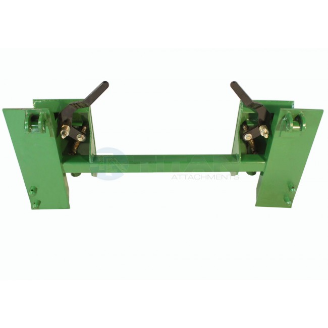

Hey guys...thought you might be interested in this. JD Hook and Pin Quick Attach on one side, Skid Steer style Quick Attach on the other. Priced at $385 with FREE shipping! Weighs 137 lbs. John Deere to Skid Steer Quick Attach Adapter 200 300 400 500 tractor loader
View attachment 444585 View attachment 444588
handy little adapter, i have sold similar on occasion,
but, as others have mentioned, when you put that on a tractor that only has 800 lbs
lift capacity at it's pivot pin, then increase the distance to the load the 4 or 5 inches further froward with the adapter,
then add the additional 135 lbs of the plate.. and oh yea, any bucket or forks are going to weigh more if built for
SSA, so you really can decrease performance in a large percentage on such a setup. on a 400 loader on a 4066R
or even a 3046r loader this isn't as much a reduction in capacity.
they have their place, but at a price, much lower lift performance.
