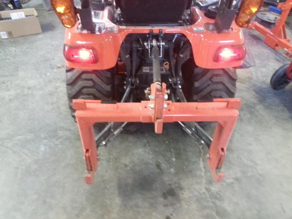

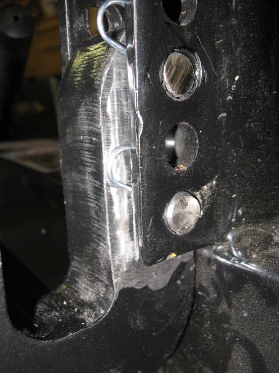

My Harbor Freight quick hitch doesn't fit several of my implements -- mostly because the top link hook is too short. I'd say it is a 50/50 proposition. I would by an alternate, more expensive one if I had confidence it would fit better.
Is there a source for different shaped top-hooks? (I am not a proficient metal-worker!

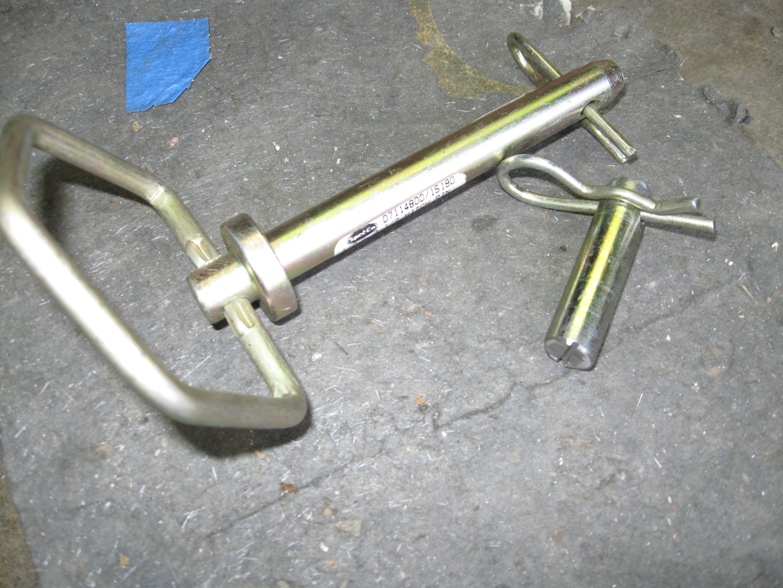

If your problem with the HF QH is the same as mine, the problem is not the length of the hook, it's the interference from the bolts that hold the hook. Here is how I fixed it and still kept the hook adjustable.
