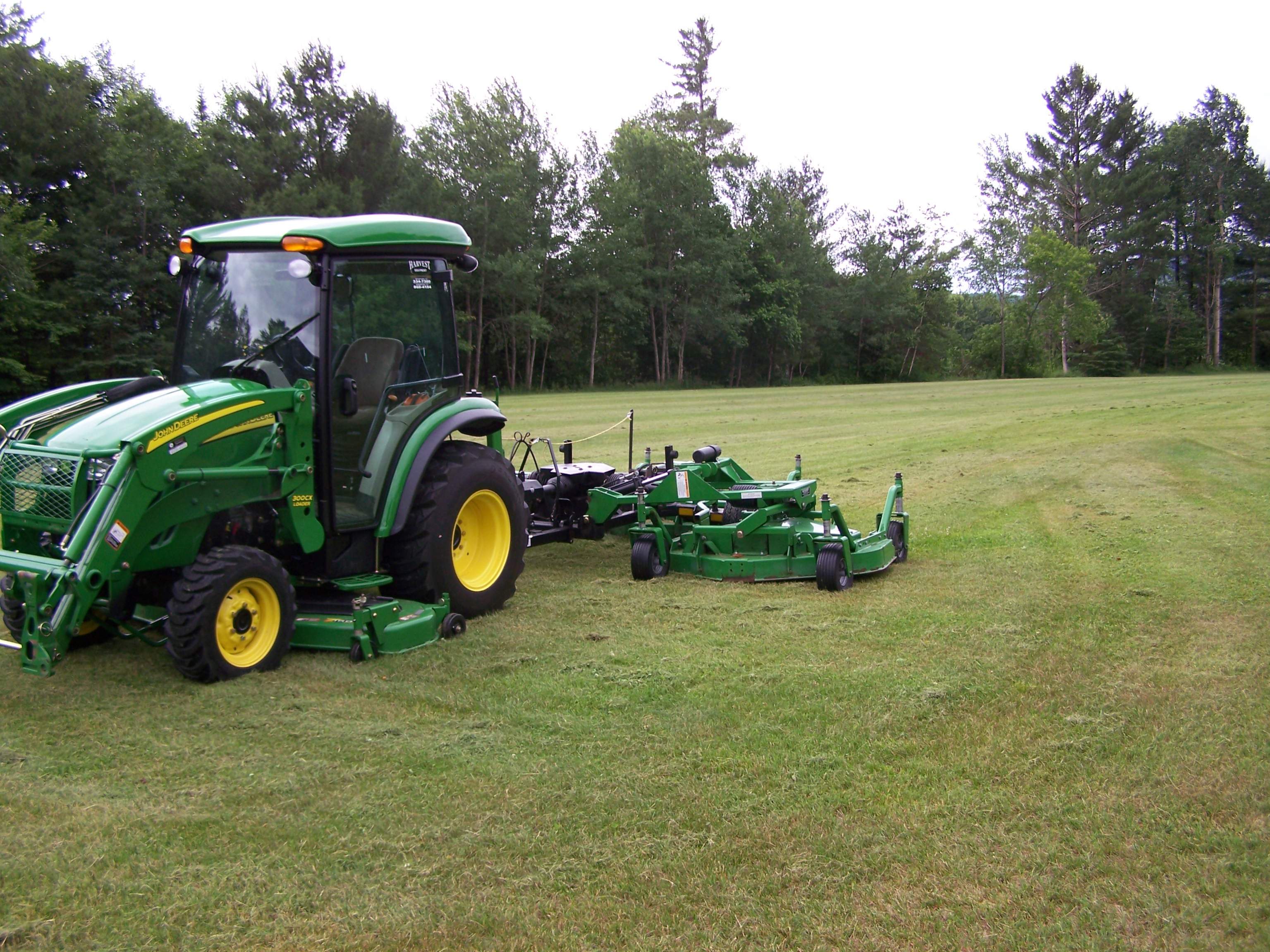

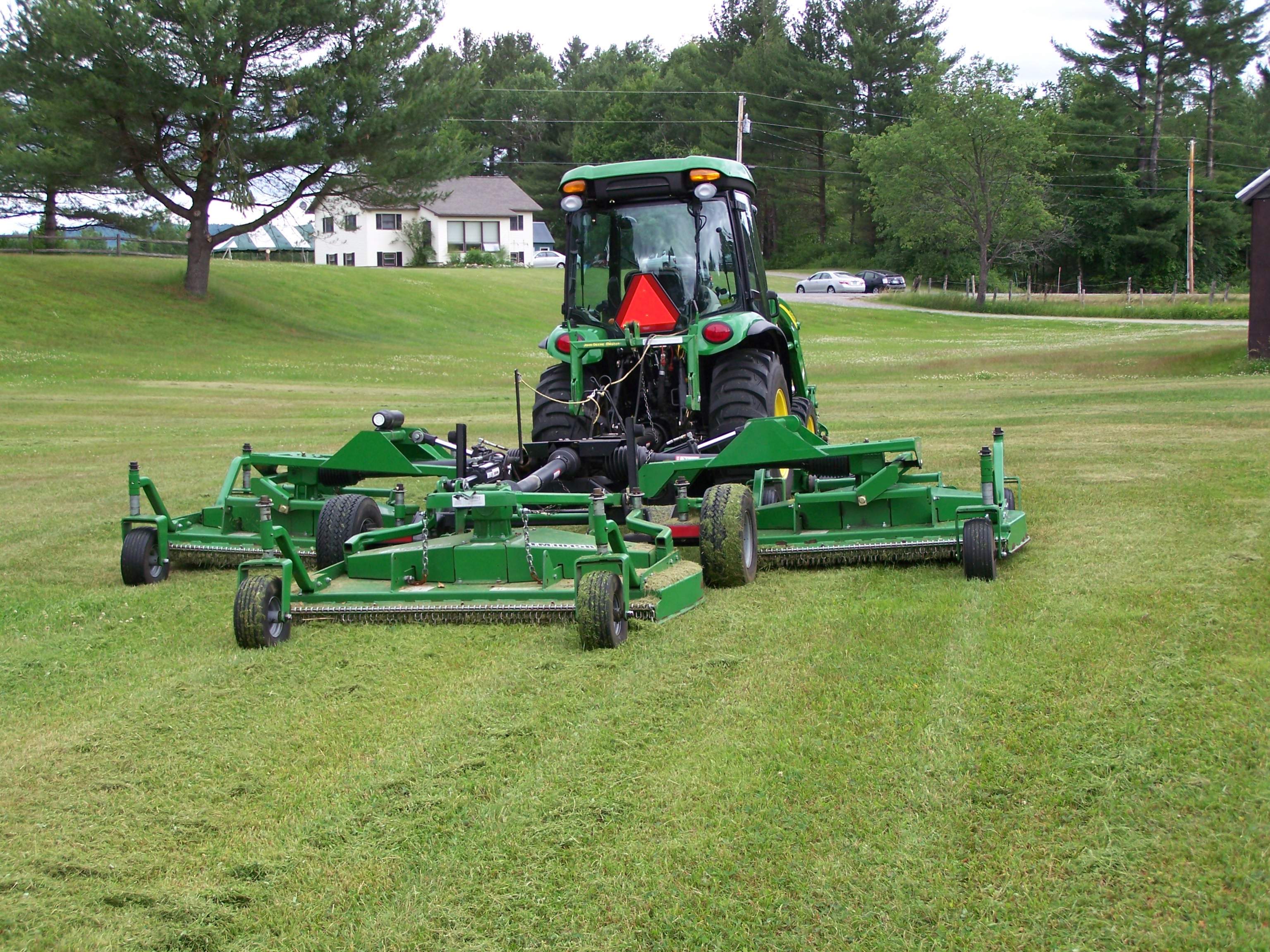

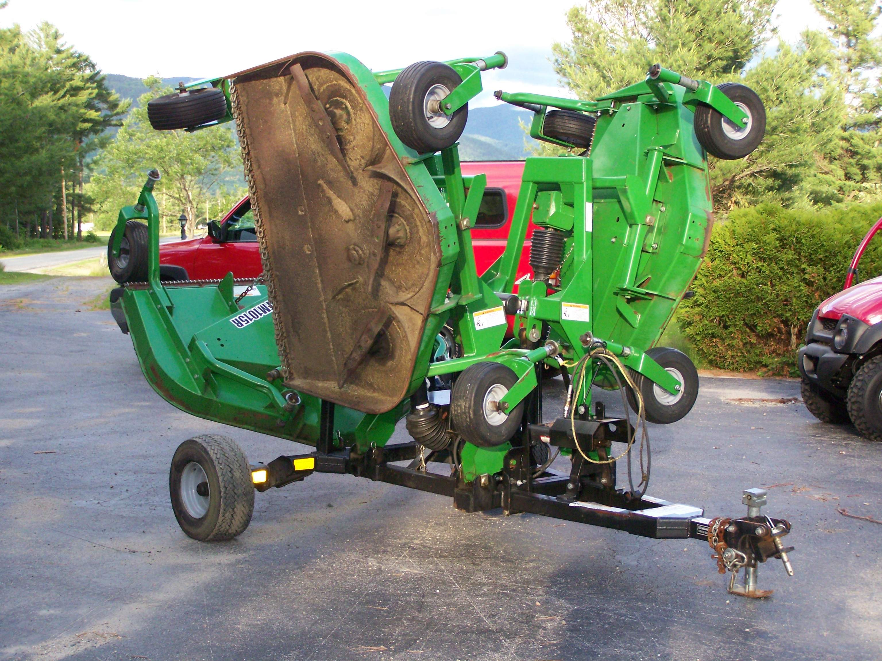

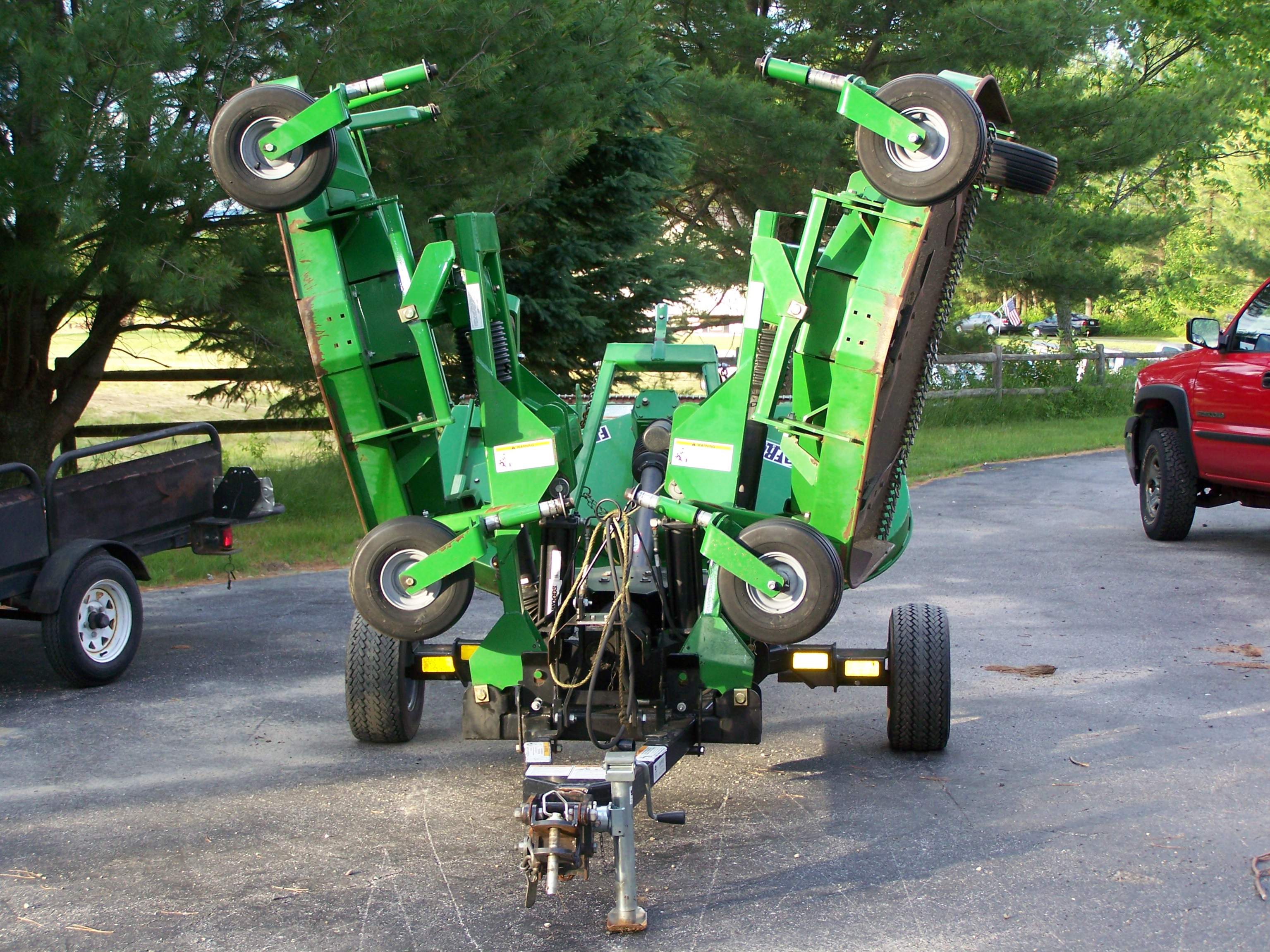

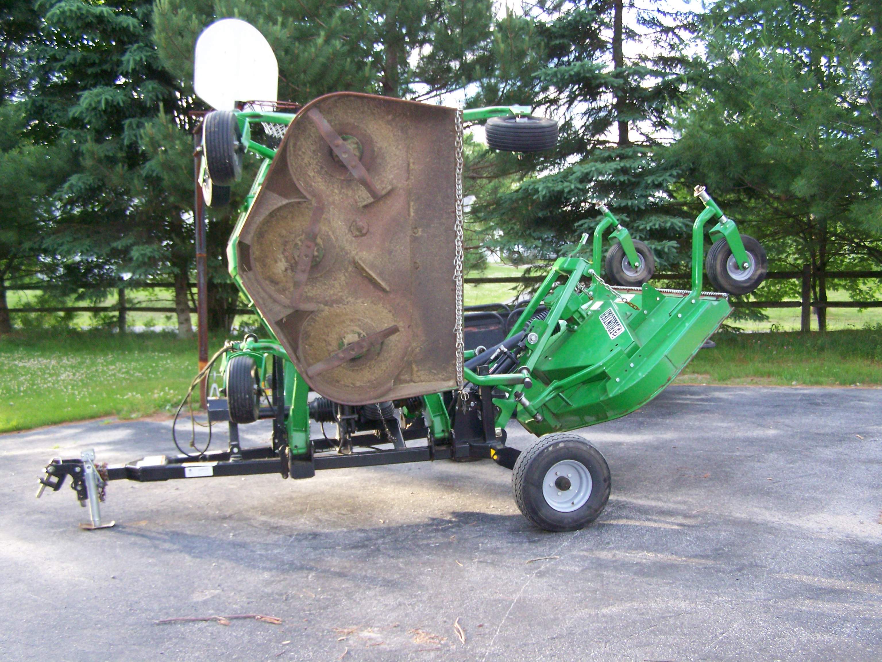

Hi:
I think you want the biggest tractor you can afford but... ;)
Summer last year (2007) the dealer brought by a used 15' batwing mower for me to try with my 3720 cab. HP wise I was on the lower recommend end. The only thing that concerned me was the transport tongue weight of the batwing It was over that of the rating for the 3x20, and 4x20 series. Operating tongue weight was under the 500+lb limit.
I mowed about 5 acres with it and it worked fine. the 3720 had plenty of power and I was mowing 3-4mph most of the time and up to 5 at times. The tractor had no problem pulling it, turning, etc. even sideways on a slight slope. Manuevering the best in tight spots was a little bit of a chore. I ended up deciding it was too big for my lot and was beyond my needs... (It was). I can't remember if I used 4wd on the small slope I had but I didn't spin/dig at all.
Anyway, I would tend to think, based on my experience any of the 4x20 series would be fine.
I was running maybe 5600lbs when I was using it with my 3720 cab (3600 + 900lbs in the tires(Large R4's) + 1100lbs for the loader frame (no bucket).
Note that this is a Finish mower. If you were rough cutting it would take much more hp.

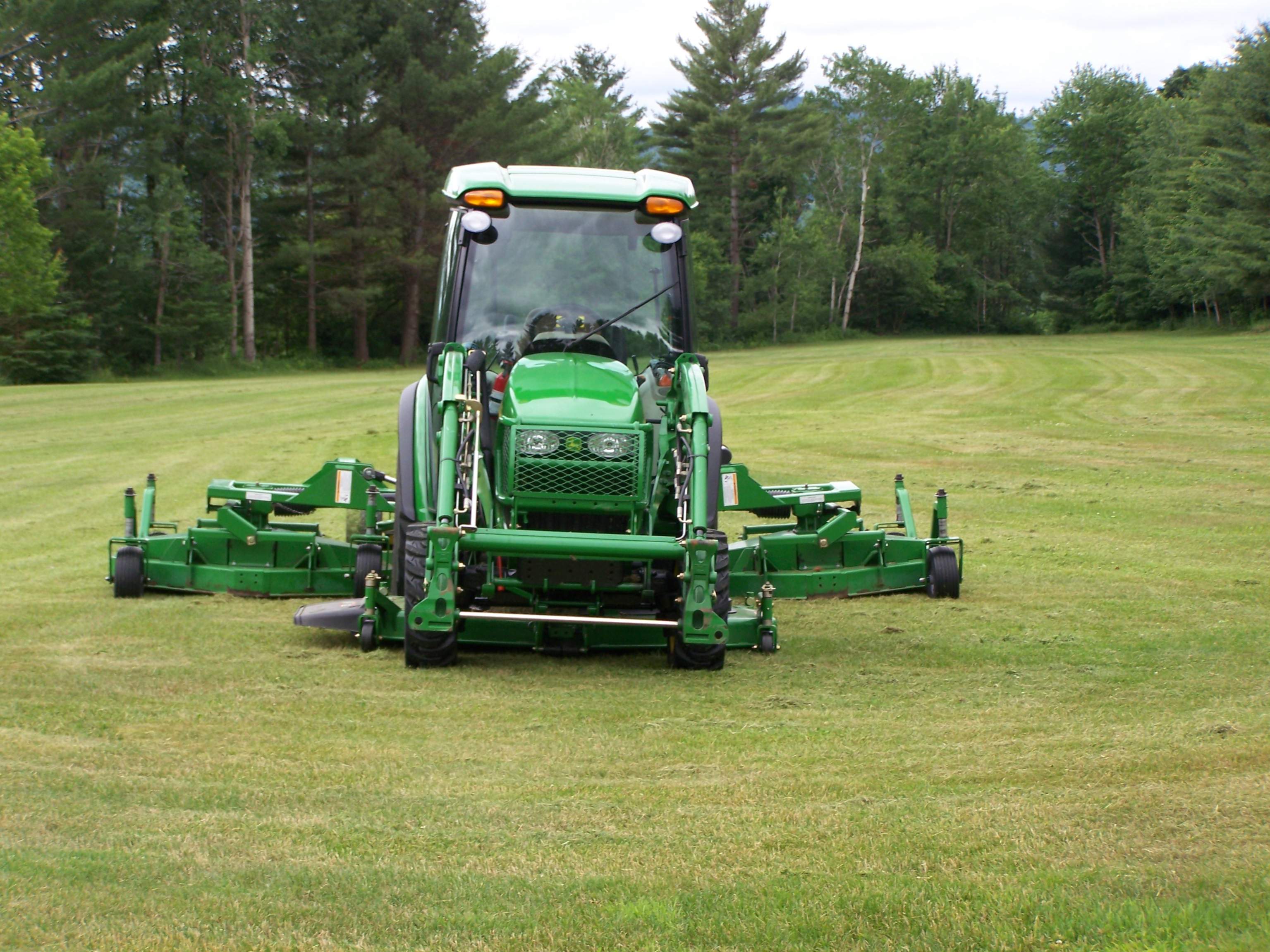

Two more pics. And No, I wasn't running the 72" MMM while I was using the FM1015R. :)
It was pretty cool to try it out. I would have gotten it about 1/2 price.
Also, the new 4720's are 66hp and I think 58 at the PTO. They boosted them this year.
I was running with 35 PTOhp and hardly had to slow down with 2 weeks growth.
